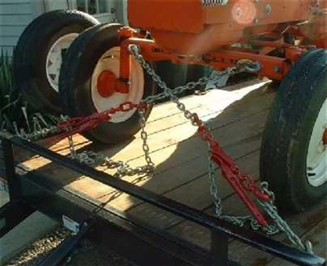

</font><font color="blue" class="small">( I am a little curious about the X-ing of the chains on the red tractor. What's to prevent the tractor from rolling out of the cross chains? Seems either corner of the tractor could lift and as it lifts the chain gets looser. Never seen an X chain like that. I realize the tires are in the way of a straight chain but you could back the tractor up. )</font>
Here is a link that may help: http://www.stovebolt.com/techtips/trailering.htm
Also: if you look at the picture imagine trying to get the tractor to roll by picking up on the left wheel. When you try to do that you would be trying to stretch the chain that is attached on the other side near the top of the right wheel. The opposing chain won't allow the tractor to roll. The main advantage of crossing the chain is prevention of sideways movement and keeping the load centered.
