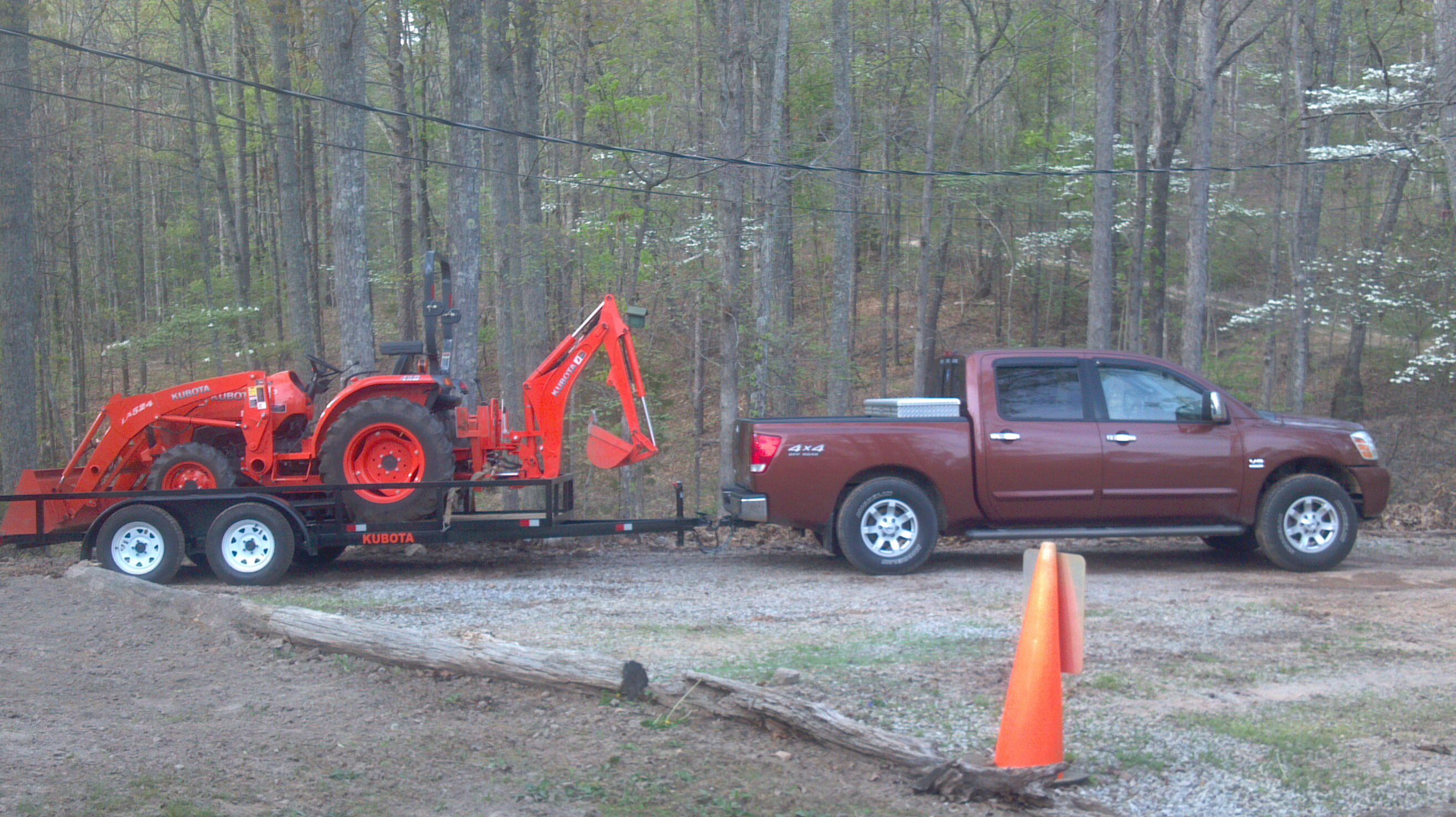

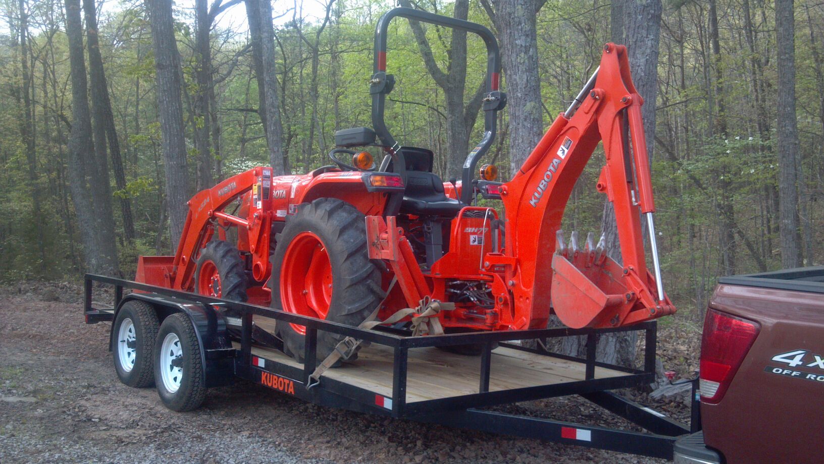

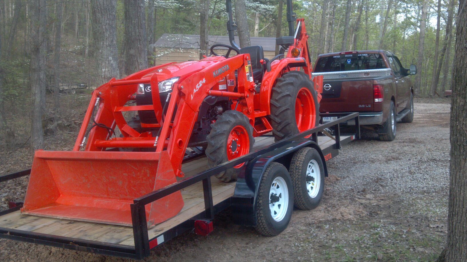

I wanted to get some insight as to how everyone out there in "tractor land" loads and tows their tractor. I have a Kubota L3200 w/ BH 77 backhoe. I transport it on an 18 ft. dual axle trailer (no brakes on trailer) and I have found that if I back my tractor on the trailer instead of pulling it on forward, I actually put more weight towards the hitch, and axles which makes the tow a lot more stable. I do plan to get brakes on the trailer because I'm towing it with a 2004 Nissan Titan (5.6L v8) and althought it pulls it with no problems, it can be a little "hairy" at times when its time to stop. I posted these pics to see if anyone else has had my idea, and also wanted to note that even though the backhoe bucket extends over the front rail, I have had no problems with turn radius.....the bucket never gets close to the tailgate even in sharp turns. tow1.jpgtow2.jpgtow3.jpg

You could probably put a small deck (spare tire storage perhaps?) in front of the front rail to rest the bucket on.
Aaron Z
/ HOW DO YOU TOW YOUR TRACTOR?
Aaron Z
I actually thought the same thing Aaron.....I might just begin some plans for something like that. It bothered me early on that the bucket was just hanging there!

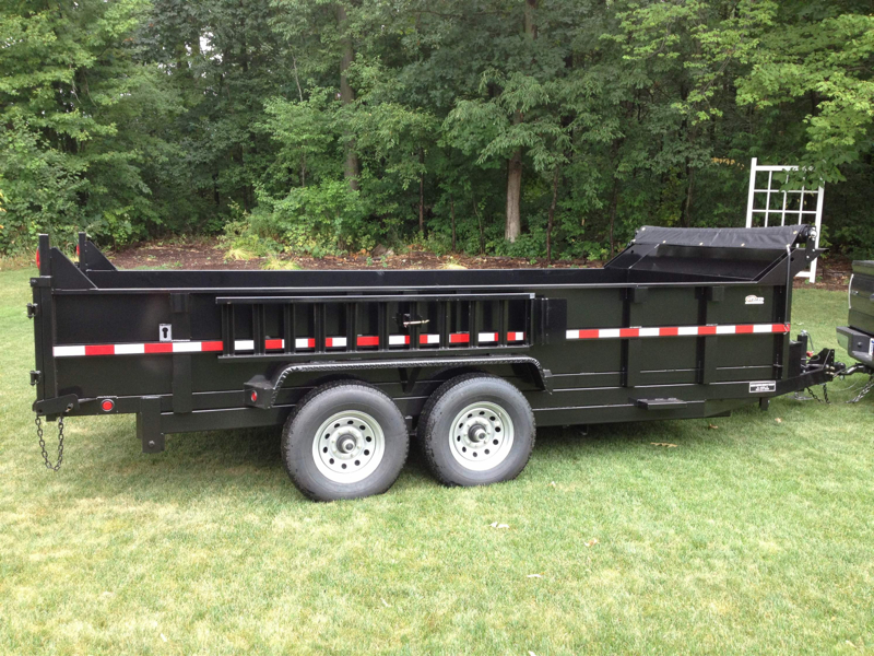

I tow by JD 3320 with my dump trailer. It's a little short with a brush hog or big implement on the back but overall it works great. I've never tried backing on the trailer but might give it a try and see how it does.
Now that's a NICE trailer right there El Wood!
YES it is!!

I load my tractor the same way, back it on, but I do it because I have a sun shade. This way there is no stress on the shade from lifting as I drive on the hiway.
I also find it easier to load when the BH is on.....it doesn't bottom out.
My trailer is 20' and I have found the perfect balance point to be with the bucket up tight to the metal edge of the beaver tail.
Please, please, please more information about this trailer. Do you have any pics with the tractor in it? I am starting to shop for a dump trailer and need all of the advice I can get.
ac
/ HOW DO YOU TOW YOUR TRACTOR? #15
ac
I cannot see the pic on my phone, but we have a pj brand dump. It is a great trailer, pulls very well and works great. My uncle has a pj tilt deck for his hotshot rig that is very cool. I have never pulled it though.

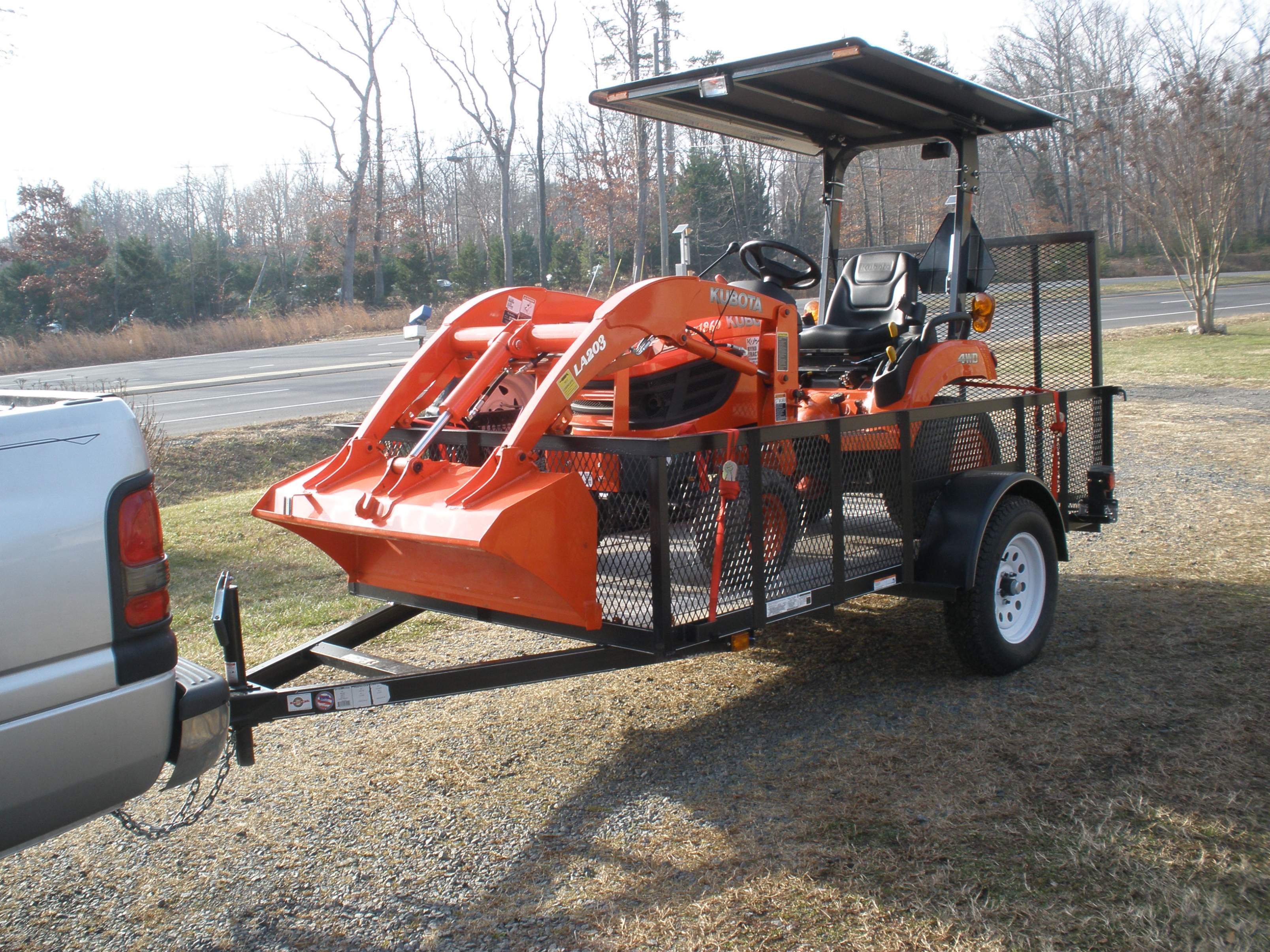

I don't trailer her much at all. Just going to dealer for some warrenty work. She towed and rode fine.
Have other strap to hold canopy from flopping, not in pic.

I have a 18' dual axle 10K equipment trailer with fold down ramps and a beaver tail. ( made by Andersen) it tows really well but was a PITA to load my L3700 with the BH on. Going up backwards, the BH hit the trailer. Forwards it dragged on the ground. I ended up getting a 20' Downeaster tilt 12k to tow the Bota. I use the other one for a Cat 246.
/ HOW DO YOU TOW YOUR TRACTOR? #20
Your L3200 TLB shipping weight is right at 4400#. Add a full tank of fuel and fluid in the rear tires and you are going to be pushing 5000#. Check the GVW rating of your trailer. It MUST be more than the combined weight of your tractor AND trailer. Looking at the pictures of your trailer, I would think that it has a 7000# GVW. For me, that is TOO close. Definatly brakes on both axles. And yes, I highly reccomend a bucket rest on the tongue. Also use 5/16 G70 chain and ratchet binders.
