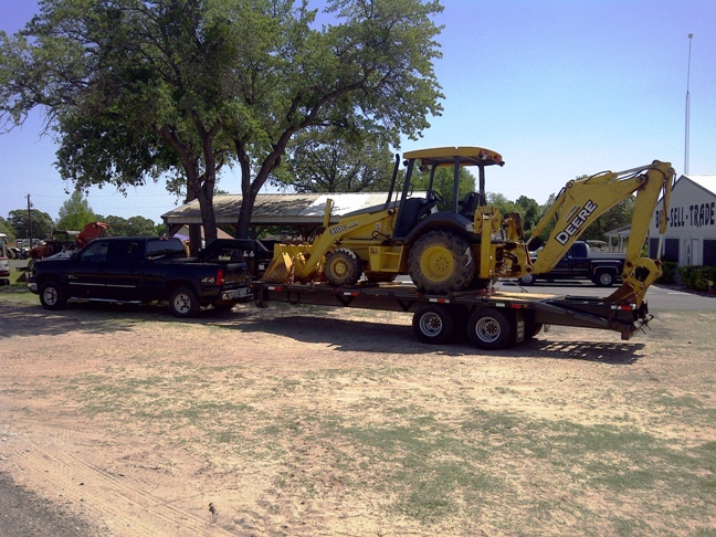

This is not exactly a photo of a tractor/batwing (attached) but tow weight would be about the same (6k trailer and 13.5k TLB). I have a Chevy 2500HD 4WD with the 6.6L Duramax/Allison 1000 6-speed, flipover GN hitch and a 20K 25' GN trailer. I did use 7 chains and hauled this TLB 120 miles to its new home (my country place) with high anxiety but without any issues. I was worried more about the height since it was right at 13'. I hate the thought of a wire hanging down below what it is supposed to be.
Obviously, a 1-1/2 to 2-ton truck will handle this better than my 3/4 ton. I totally agree with the 4-wheel drive. I would not have made it to my property without it. Not all county roads are paved.
The flip over ball is great. It is flush when not in use and my truck bed is 100% useable.
Also, the longer wheel base (4-door) makes for a smoother ride and gives me room for passengers and groceries.
