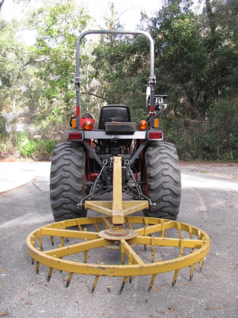

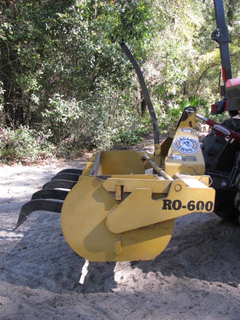

I am experimenting with a Category-1 Hydraulink.
HydrauLink - a self-contained air over hydraulic top link
As of 12/10/2012: 473 posts, lots of bitching, not many operating experiences.
http://www.tractorbynet.com/forums/attachments/174498-hydraulink-self-contained-air-over.html
Used with my 60"/630 pound Bush Hog (brand) Rollover Box Blade Hydraulink is an asset. The piston works in-and-out 1"-2" reducing hobby-horsing; hence frequency of minor top link adjustments. And, yes, theoretically it is adjustable from the tractor seat, however my Hydraulink, manufactured in China, does not maintain the control valve wheel in the "up" position. It is usually works "down" by gravity. "Down" is notably inconvenient.
Used with my 60"/323 pound King Kutter Rotary Harrow, Hydraulink is NOT as good as the factory Kubota screw top link. The Cat-1 Hydraulink is just a bit longer than the Kubota link, because the Hydraulink piston will not screw into the body for about the final 3/4". This translates into a considerable reduction in useful adjustment range on the harrow, over its 60" diameter. With the longer Hydraulink I cannot quite get the Rotary Harrow flat, the rear is often lower than I want and I cannot adjust the front lower than the rear....so I usually use the Kubota factory screw top link with the Rotary Harrow, which provides full range of adjustment. With a Rotary Harrow top link length is often critical to the task, however top link is NOT adjusted frequently.
(( It is easy to switch top links, although inconvenient. ))
I have not used Hydraulink with my King Kutter 48" rotary mower, yet. I expect the Hydraulink will be a good shock absorber.
Neutral when supporting Wallenstein BX42 PTO chipper which is flat on the ground, on its skids, before the PTO is engaged. Transporting chipper on the 3-Pt. is a "dumb" top link application.
When I have more experience I will post a thorough Hydraulink review.
My tentative conclusion is that for what this device costs, $250, and its imperfect factory execution, I should have put the money toward an "regular" hydraulic top link. Tractor has one Kubota (optional) hydraulic port at the rear.
Tractor is a Kubota B3300SU; 33-hp/1,800 pounds.
