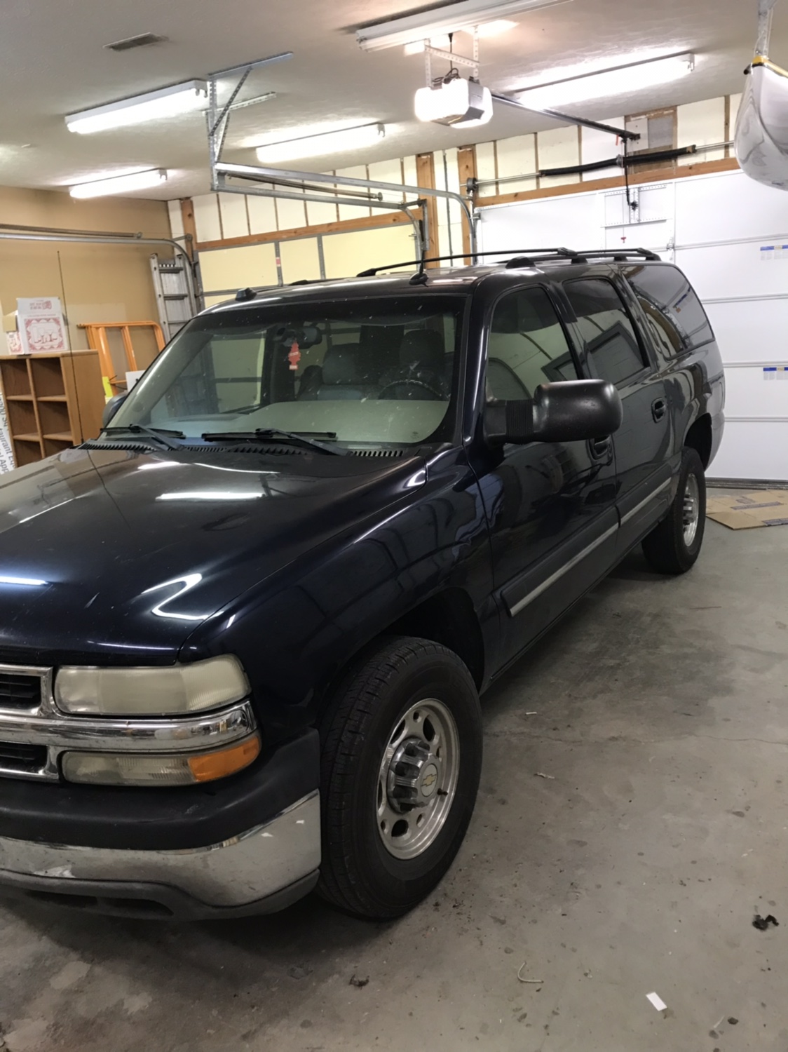

I’ve got a 2500 suburban with a 4l80e transmission. It seems like the tow haul function is staying on despite the little trailer emblem going off. It’s pushing the shift points high and doesn’t seem to be shifting into OD. I need to experiment with it more tomorrow.
   / How do you verify if the tow/haul button actually works? #2
What year Suburban? Just curious.
