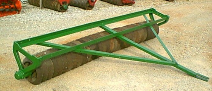

You do not need to use a tiller or disc to work in the seed. You will work a lot of them tooo deep and this gives you poor germination rates. Seed are too high in price to waste. A cultipacker is a must for putting in seed. Check with Bio Logic or some of the guys that have done foodplots for years. We have 30 field ready packers on hand 5 ft to 9 ft. Ken Sweet
I agree that a cultipacker would be BETTER. However, I was wondering if a tiller would work. I have broadcast and covered seed with a disc harrow for years and I know that it isn't the best way to do things but it certainly works. I was just wondering if I could get similar results with a tiller.

I agree with Ken.
Use a cultipacker or a chain,drag harrow/ or old fencing to lightly cover the seed.
A tiller will cover most of the seed with too much soil to germinate.

This is a explanation from a expert that explains better than I can, why a cultipacker should be used. Ken Sweet
"Firming up your seed bed:
Many people choose either offset disks or roto-tillers to work up their soils. These implements do a very nice job; however, when trying to plant into freshly disked or tilled fields, most will inadvertently incorporate the seed too deep into the seed bed, primarily because of the fluffiness of the soil. A cultipacker will firm up the freshly tilled soil by compressing the air out of the soils surface which will allow you to plant seed firmly into the soils surface. This is critically important when planting small sized seeds, such as clover, alfalfa and chicory. If you incorporate any of these seeds deeper than a シ inch you will not have a good stand once germinated.
Breaking up soil clods:
When tilling soils with a little too much moisture in them you'll have the tendency to leave large chunks of soil, which at a later date will make it difficult when planting. Most seeds need to be firmly pressed into the soils surface, which is difficult to do when you have large clods of dirt distributed throughout your food plot. A heavy cultipacker will help eliminate large clods making for a better, more consistent planting surface.
Moisture retention:
I've heard of people using flat-surfaced lawn rollers for compaction when planting their food plots. My first thought is. a flat-surfaced lawn roller is better than using nothing at all, and is considerably better than pulling a drag over your freshly planted plot. However, a cast iron roller will do a much better job, primarily because of moisture retaining issues. Why? Think of it this way. If you pour a full glass of water on a counter-top, what happens? The water will run every direction looking for the lowest point to run off the counter. Pour the same glass of water over a flat, corrugated piece of steel and you'll notice much of the water will end up in the lower points of the corrugation. This is exactly what happens in your fields. The groves you leave help trap moisture in your field as the corrugation groves act as mini-reservoirs allowing your soil to bank moisture for future use.
Even out uneven terrain:
Cultipacking has the tendency to take the undulation out of your soils surface. This helps you achieve a more even distribution of seed when you broadcast plant and will allow you a better uniformed planting depth when planting with a row-crop planting implement. A field that is firm and smooth before planting will germinate quicker and grow more uniform, and this can only be accomplished by floating off the uneven terrain with a good cultipacker.
Planting into a firm seed bed:
The rule of thumb when planting seed is you never want to plant the seed any deeper than four times its diameter. When you consider clover, alfalfa, chicory or any other like-sized cultivars, this calculates into depths of no more than a シ inch or less. Incorporating seeds at this depth is almost impossible when using drags or disks. The results from using a drag or disk will culminate in seeds either being planted too deep or too shallow. The best planting practice to implement is to cultipack first, broadcasting your seed, and then cultipack once again. You'll notice better seed germination as well as more uniform growth. You'll be amazed at the difference you'll see." Ken Sweet

Good article Ken. How does a cultipacker work to cover the seeds up. I could see how it would firm up the seed bed but how does it cover the seeds? Does it just press them just under the soils surface?
