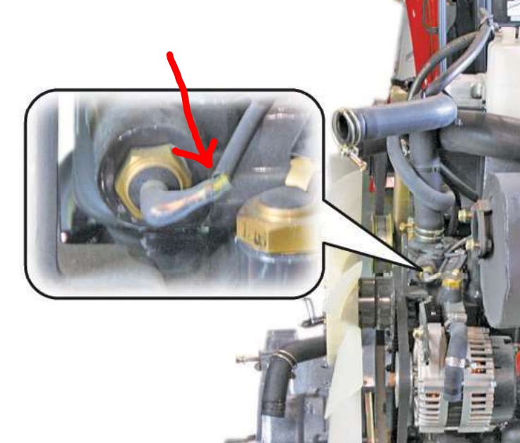

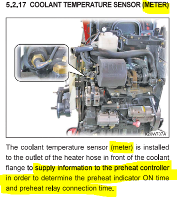

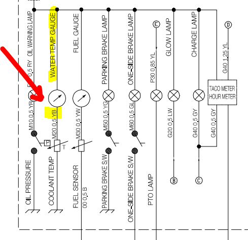

For anyone else in the audience who may already be used to this kind of stuff (im an ASE Master auto tech) you may notice there are several INACCURACIES in the manuals where it describes the temperature sensors!
Ok so the PREHEAT temp sensor sends a signal to the INSTRUMENT CLUSTER? Hmm.
And the sensor for the METER (aka 'gauge') sends a signal to the PREHEAT controller? Sure, got it! :rolleyes:
But look closely at the pic and you can see a clue that the technical writer didn't catch, but an actual mechanic might:
That right there is a yellow wire. Now look back at the wiring diagrams:
The yellow wire (with black stripe) goes to the gauge on the instrument cluster.
The temp sensor for the preheat controller would have a blue wire with black stripe. So the preheat sensor is definitely the one sticking straight up with a male spade terminal coming off it, NOT the one sticking out sideways with the stud in the center.

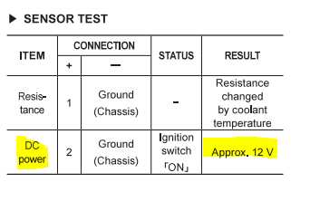

The table called 'sensor test' found on the preheat sensor page is also either nearly useless, or totally inaccurate for the actual preheat sensor:
First off this chart is garbage because where is 'connection 1' and 'connection 2' on a ONE WIRE sensor? And what is status "-"? There's no 'legend' or footnote helping you understand these. But let's double down and say there IS a wire going to terminal 2 of this 1-wire sensor that has 12v on it when the ignition switch is on. Well, if you didn't already notice that there weren't no two "connections" on your 1-wire sensor, or if you assume that the omitted information would tell you (if it existed) that connection 2 is actually the WIRE you just disconnected from the sensor, that 12v thing might seem plausible. But.. if you look at the resistance specs provided for the sensor, you can see it is designed to go down to 1.2ohms:
There's this little thing called Ohm's Law that says if you put 12v across a 1.2ohm resistance you will flow 10 amps. Which is interesting when you consider that the fuse that's giving the glow controller 12v in the first place, is a 5 amp fuse.
So is the circuit designed to pop the 5a fuse every time the tractor's engine coolant exceeds about 10c? Or is the circuit a 'pull down
' circuit that actually only has 12v when disconnected (which it doesn't tell you to do) and is current-limited so as not to blow the input fuse (it probably is) and when the wire is actually connected it will 'pull down' to a voltage that doesn't really matter because that's now how they expect you to test it (but they don't tell you how they DO expect you to test it)? Basically, is the manual just poorly written by someone who is not a mechanic, can't read a wiring schematic, doesn't know ohm's law, and neither do any of their proofreaders? Unfortunately that is very likely the case. The job title of 'technical writer' is basically shorthand for 'person serving as interpreter for someone talking about a subject the interpreter does not fully understand'. It's actually pretty normal. This is still way above the level of technical writing done by most of the people translating Chinese manuals to English! :cautious:
Errors like that could send people on wild goose chases!
But, you have to be smart enough to go to the manual in the first place for this to become a problem for you, so for most people who can't fix this glow plug circuit.. this is not what's stopping them. :whistle:
