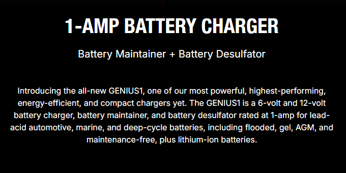

   / How does a NOCO battery charger "desulfate" the battery?
this one as it I guess but the one Op's has doesn't has he mentioned it...
I just presumed the one amp didn't have desulfate but I guess it does.
