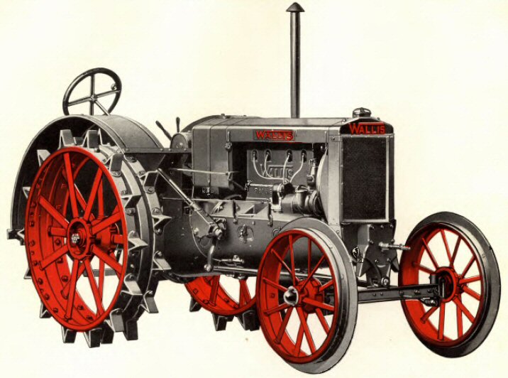

   / How Does a Tractor "Ride"? #9
Jeez, I knew that "ride" and other creature comforts like heated seats, sound systems, blue tooth and power everything had taken over the sissified truck market; where the market caters to road queens that want to drive (have the drive of) a car, but need the physical appearance of a truck for personal identity (& gender insecurity) reasons .
...but now tractors too?! :D
Ok, whatever, its 2018. A good seat is probably best. I don't know what best tire giver best ride, but these are probably the worst.
