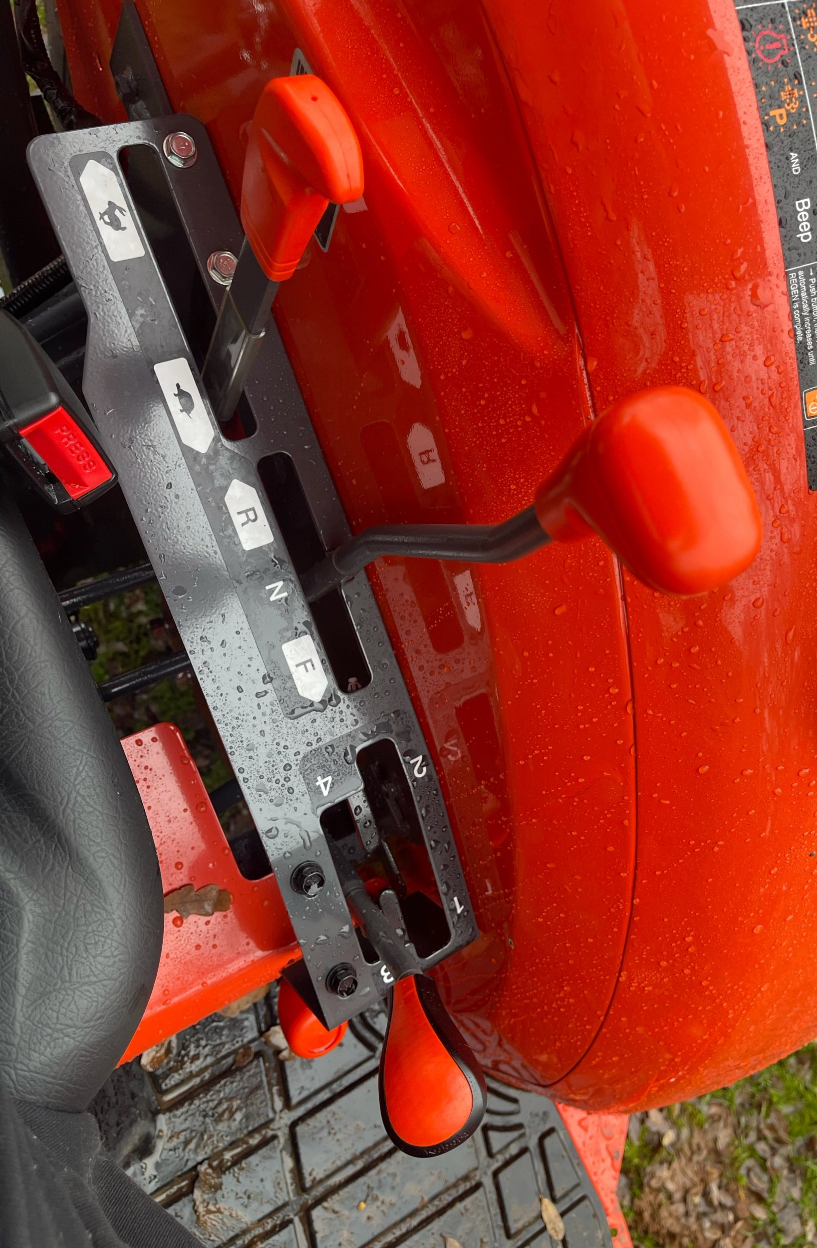

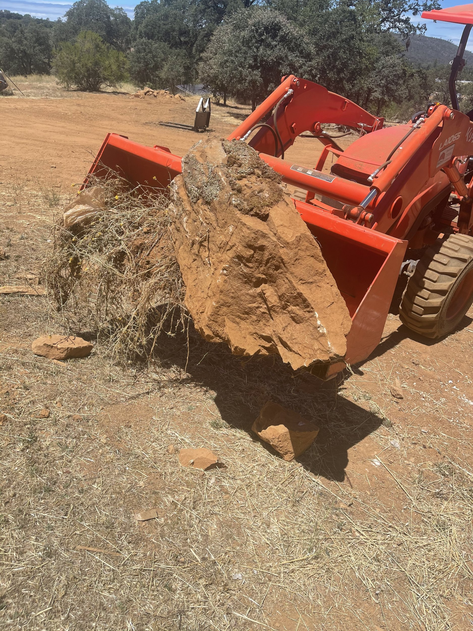

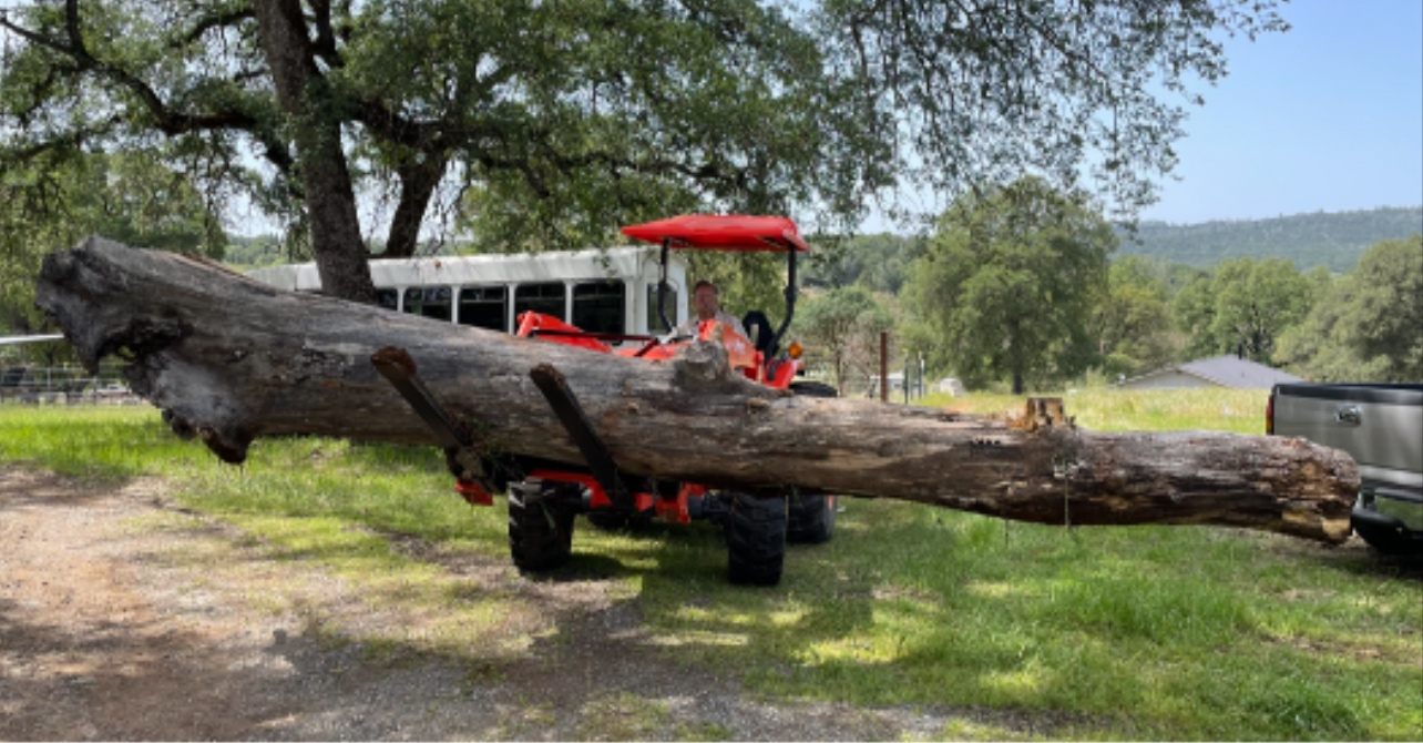

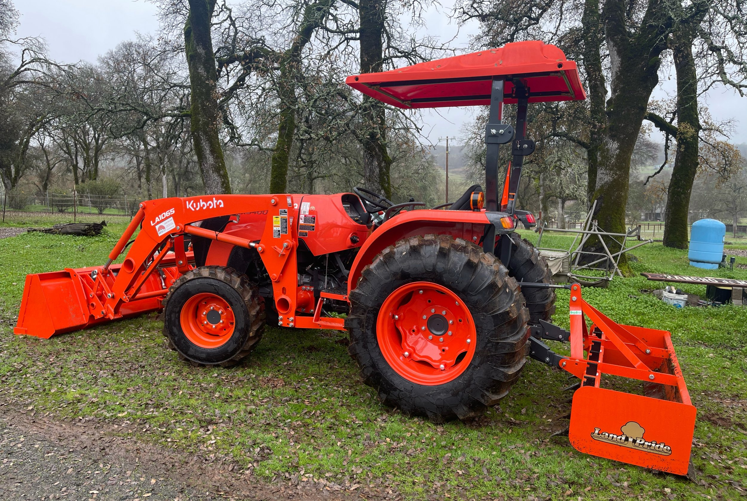

Both transmissions are good and people have their preference but I think most of these readers do not know how to drive a standard shift. When I bought my Kubota the sales woman did tell me that the DT does have more power. And seems a lot of readers think you have to slip the clutch to take off. Mine at idle just let out clutch out in any gear and she goes. Pick the speed you want to work with and select the gear you want. Your not constantly shifting gears like a big rig truck. And a big rig or big bus you also don’t slip the clutch. A gas rig you do slip the clutch just slightly to take off. My case usually in 1-4 low since I’m usually doing ground work. For loader work I can’t see how a HST would be so much better. The Shuttle Shift is fast to switch directions. Putting the clutch in is no harder than taking a step. And I’m 76 years old. The gear drive will hold on a hill in gear with the engine stopped. An HST will not hold on a hill with the engine stopped if it’s in gear. It relies only on the parking break. Of course you would always use the parking break for safety. Also a gear drive on a 25hp tractor it would be to your advantage to use a gear drive since your at the low end of horsepower for a small tractor and want every horsepower available. Mine a Kubota MX5400DT would probably do well with an HST. But for me the gear drive is a hell of a lot more enjoyable to drive. My brothers tractor is an HST so I have driven an HST. The DT more enjoyable and saved $2,000 to boot. But everybody has their own opinion. Their all fun and will do plenty of work for you. EB19C65F-5A77-4FB5-BEAC-6362DDACE4ED.jpeg
