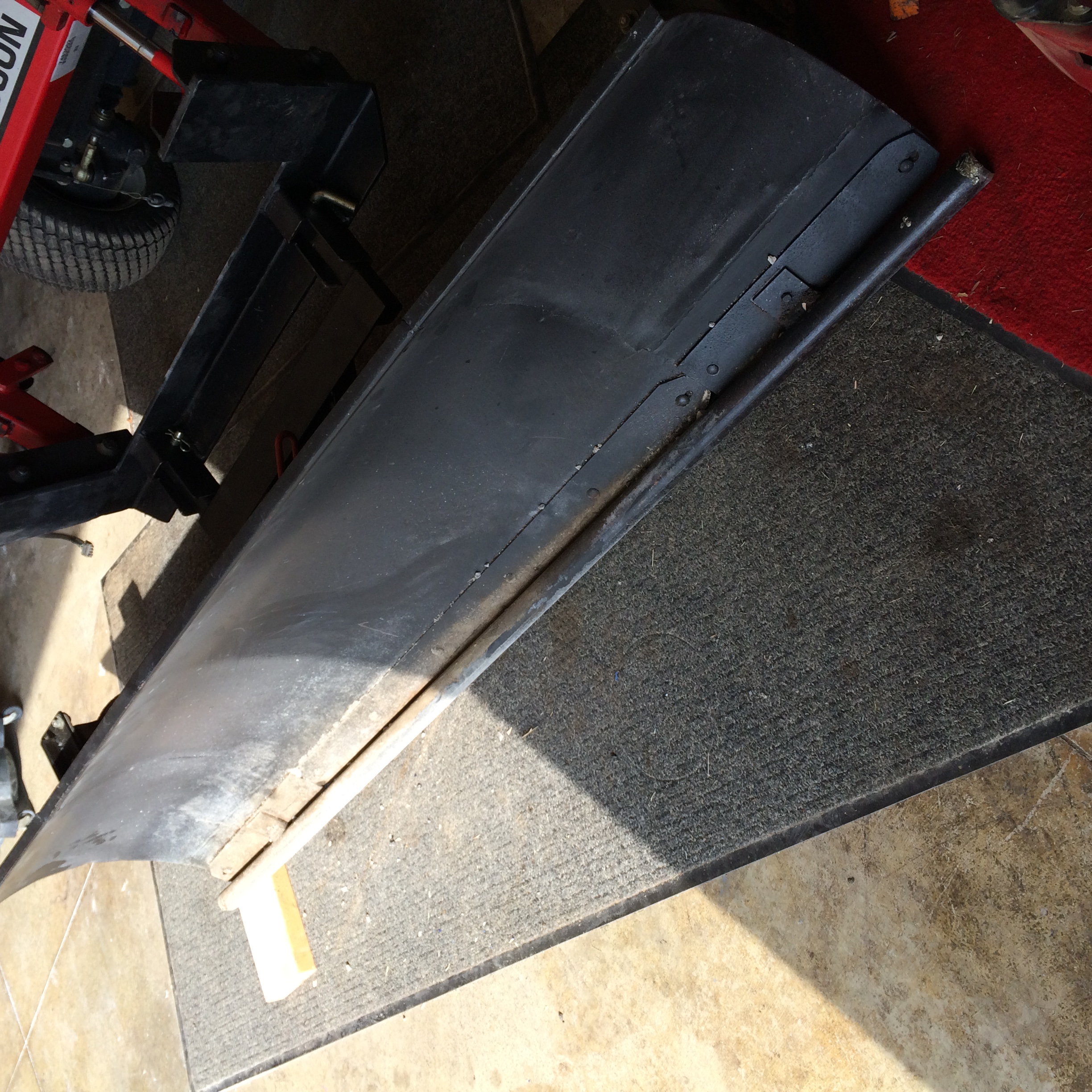

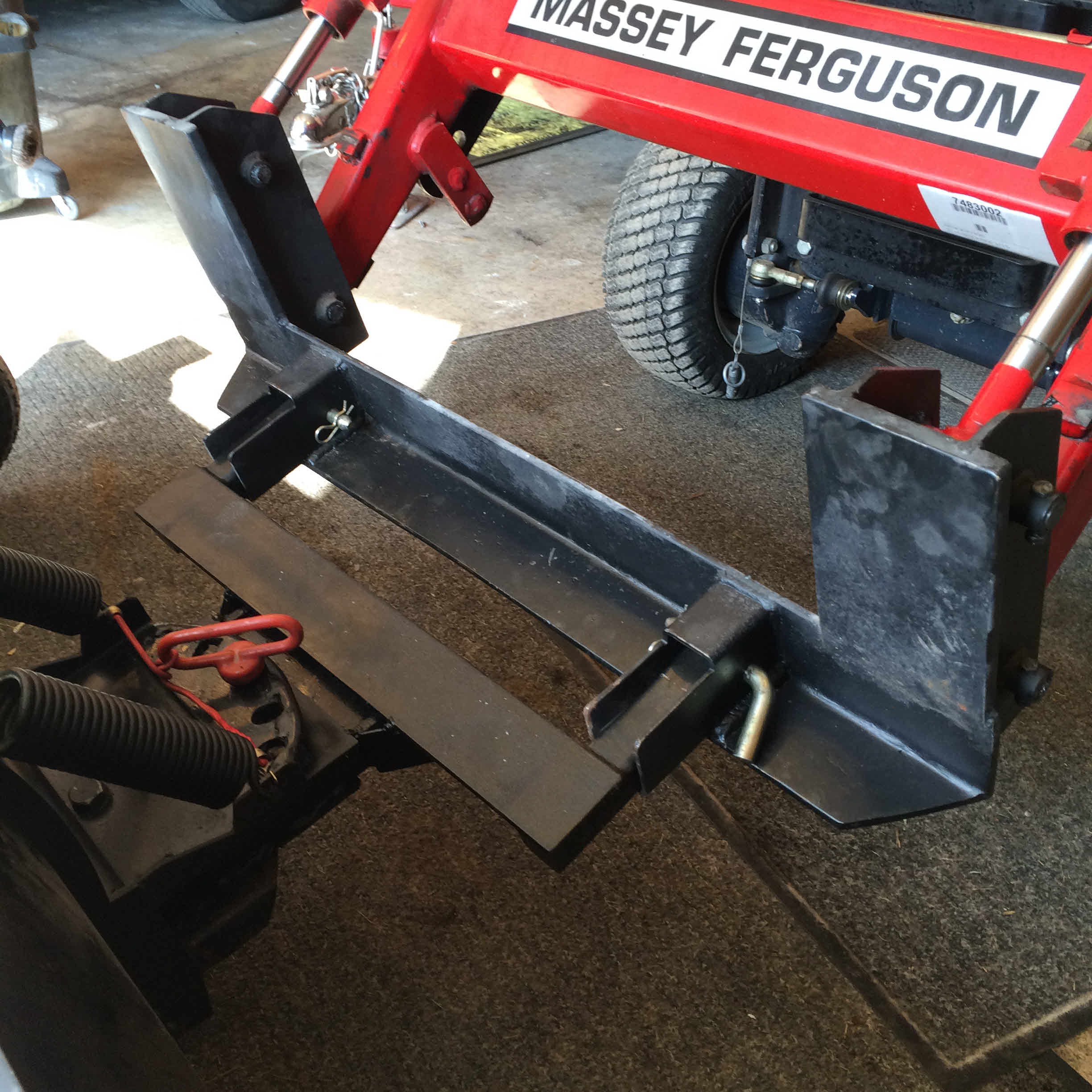

   / How does FEL handle snow? MF 1705 #5
Plowing anything but a very small amount of snow, with a small FEL, is fun for about five minutes.
It's also a pain to keep the cutting edge from getting into the gravel.
You can make a loader mounted plow, without spending a lot of money, if you are at all handy.
And, you won't have to back up all day.
I have less than $100 in this one, made from two Bolens tube frame plows, which are pretty easy to find.
