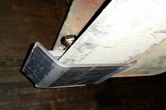

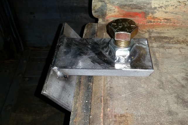

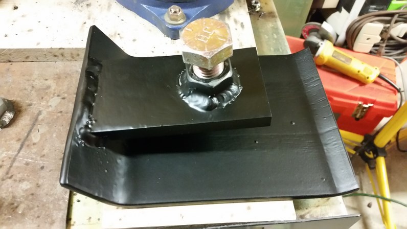

We can have some fairly large storms up here dumping a couple feet of snow. The bucket is the best tool for "moving" snow. Like a plow, the challenge is getting that first pass cut. As others have said, a rear blade/bucket combo works well. With gravel you do have to worry about the FEL digging in. I made my own bucket skids and they work really well!
I'd try the bucket/rear blade for a season and see how you make out.

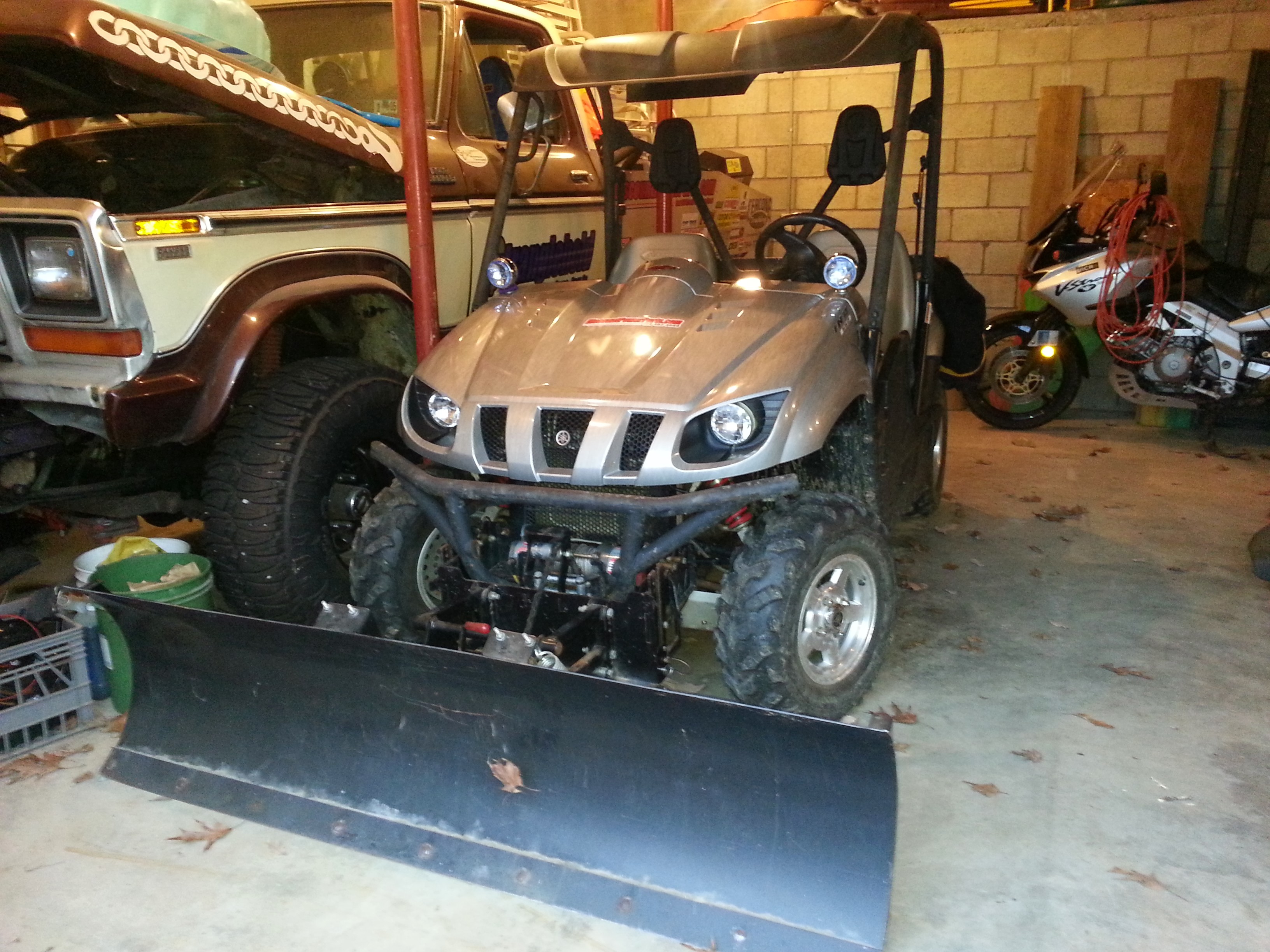

Nothing works as well as a side by side with a 72" angled plow blowing snow away at 20 MPH. I have a 350' long driveway that you can do U-turns in in a full size crew cab truck, it takes me less than 10 minutes to plow it. I would never want to plow with a 5 mph tractor :thumbdown: That would be truly painful, but I do get it. If it's all you have... you use what you got. My Yamaha Rhino and Warn 72" plow together are total beast mode in snow.
