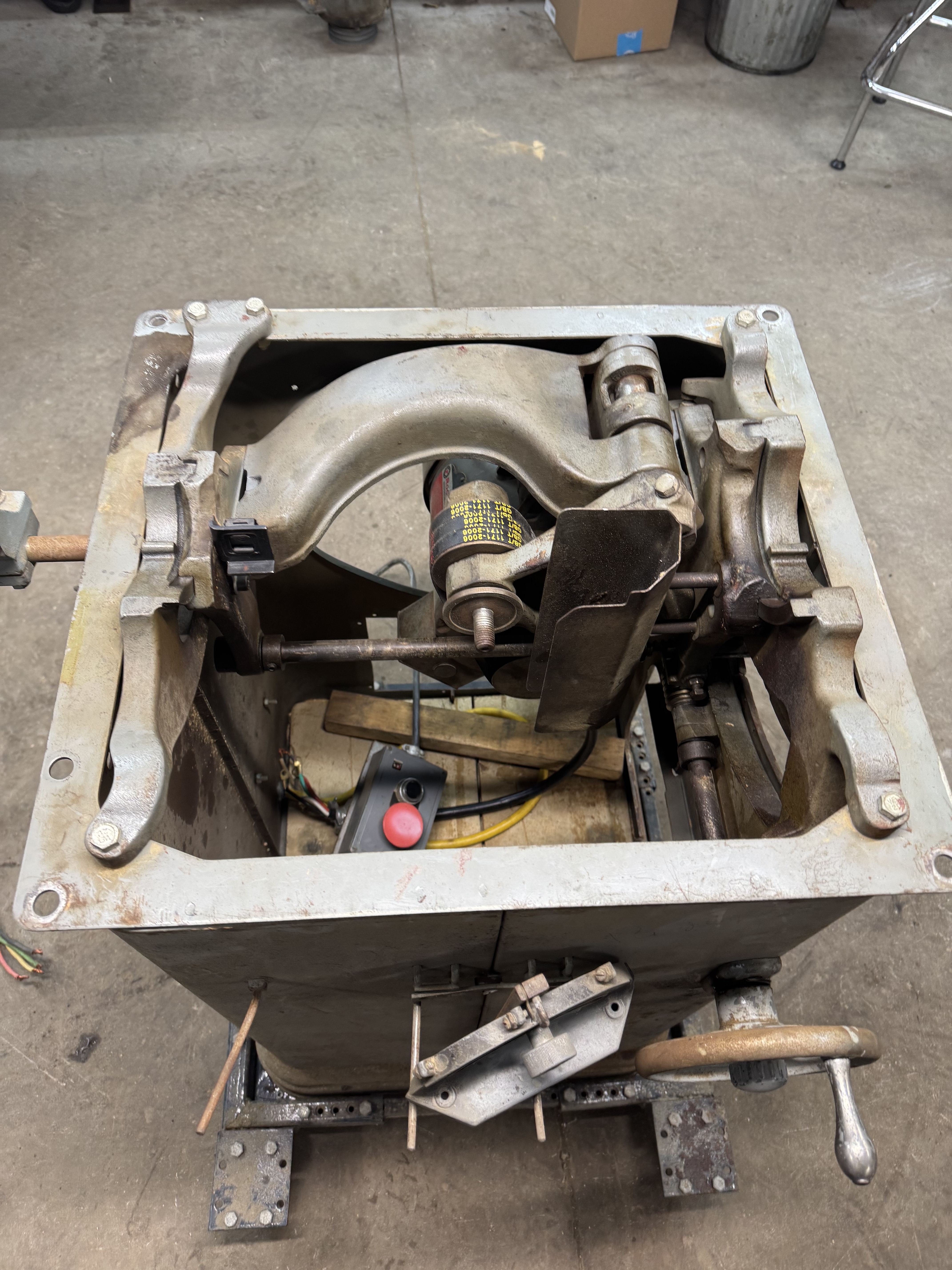

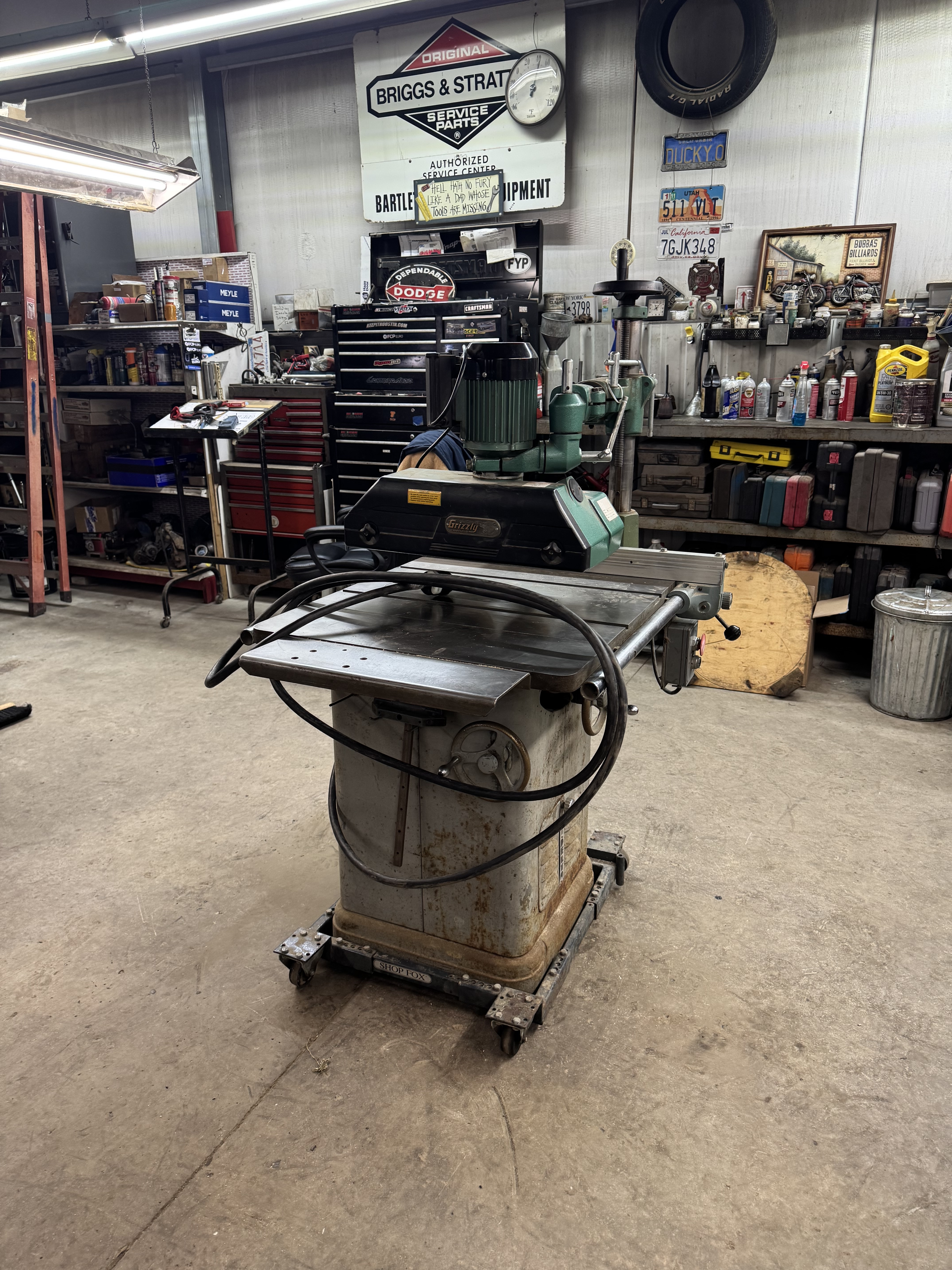

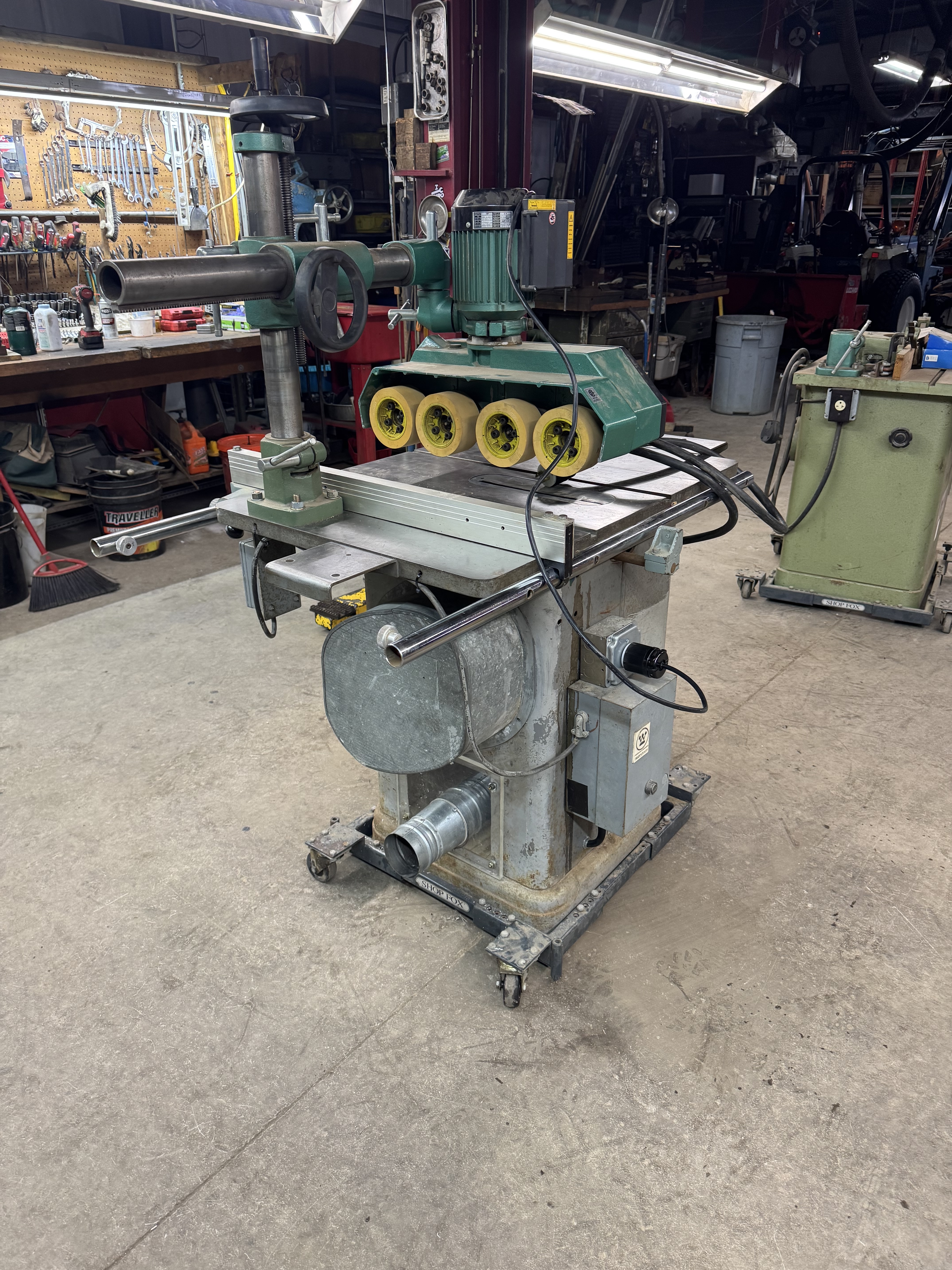

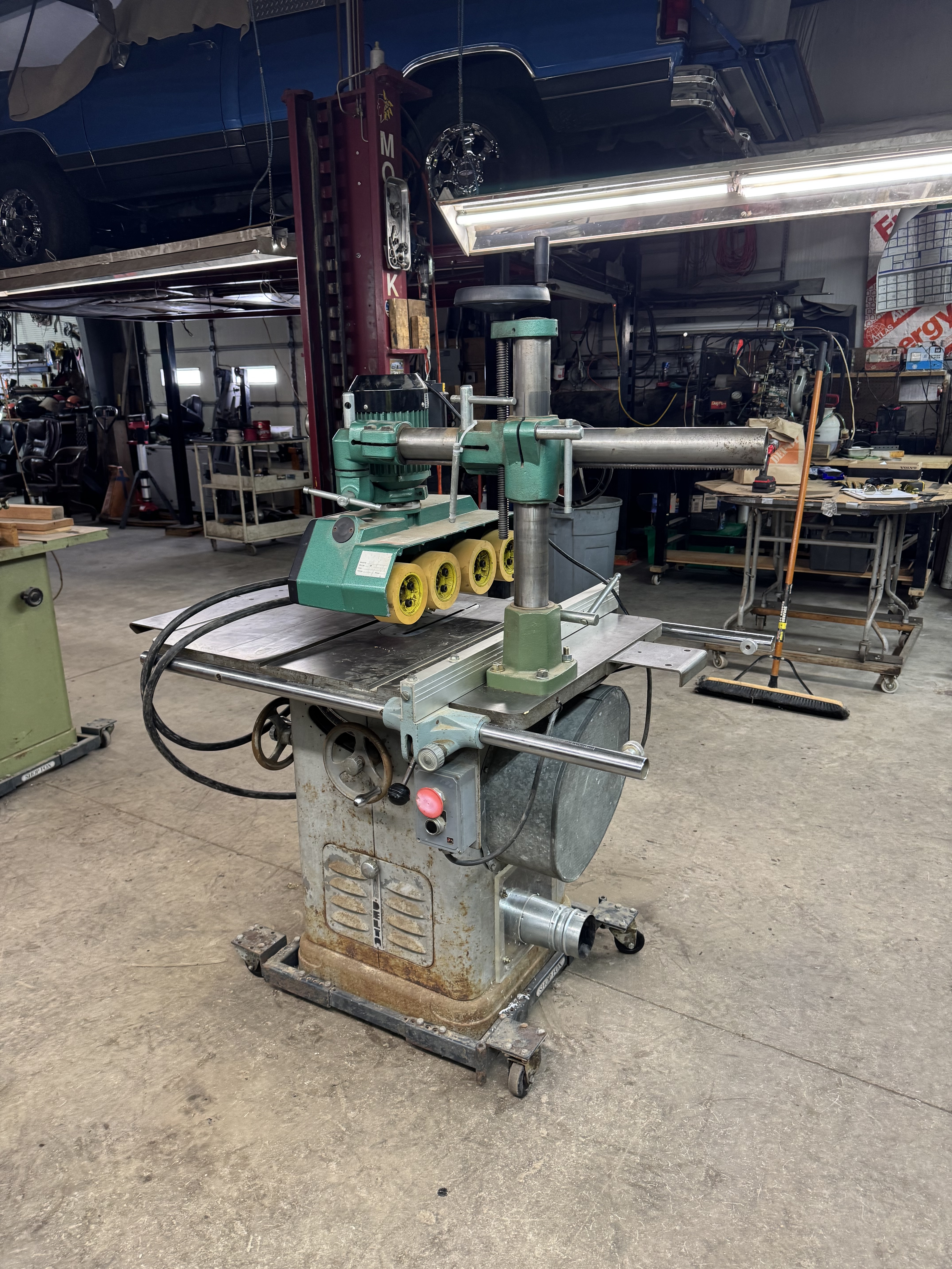

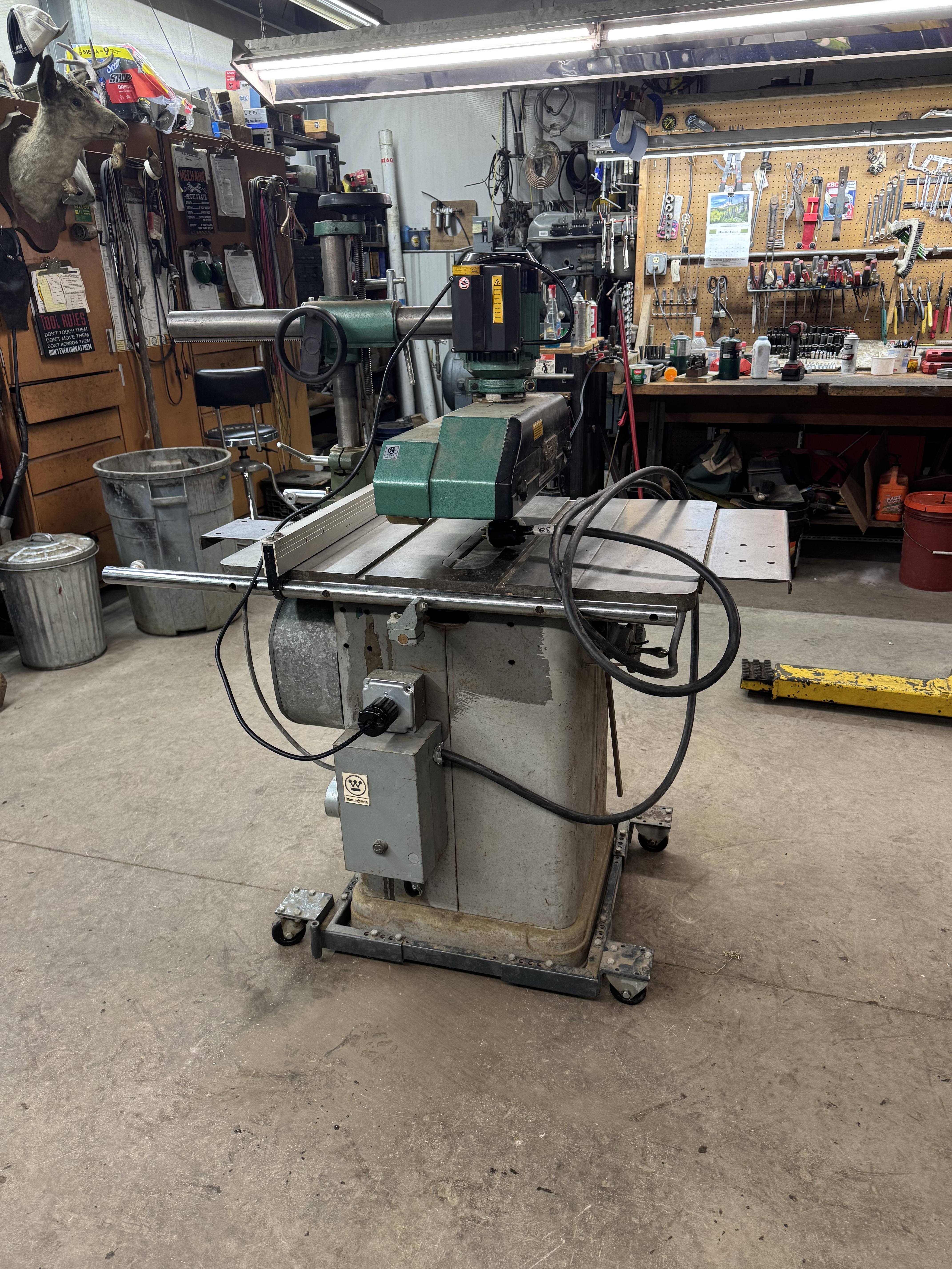

My unisaw mod is finished!
The tilt/raise mechanism is cleaned & lubricated and operates very smooth. The gearing shows no wear despite its age so it may not have that many hours on it.
The re-wiring went smoothly & added an outlet for the power feed to plug into. New belts were installed & a closure plate made for a 4” dust collection port.
I cannot attach photos it says the file does not have an allowed extension.
Photos to follow hopefully 🤞
   / How does sawdust get into a sealed electric motor?
#14
Hopefully the photos are attached.
