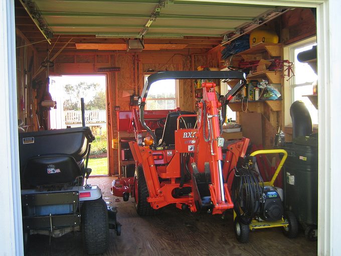

But seriously, when my mower (60" MM on BX23) is at it's fully retracted setting and I go over bumpy ground, it kinda rattles up and down a bit on one side. Is this normal, or should I look to adjust it? It came from the dealer with the cutting height settings pretty much matching the knob and cuts fine and evenly.
Just finished my first weekend with the new BX23. Not quite the bear my old Teramite backhoe was, but adequate for what I need it for now. Attached is a picture of it in it's new home. Just about fits in the 16'x12' shed, but have to rest the bucket on the potting table to close the door. When I dismount the mower for winter, I expect that I will have to store that in the garage, so next years project is going to be a 6' x 16' extension to the shed!

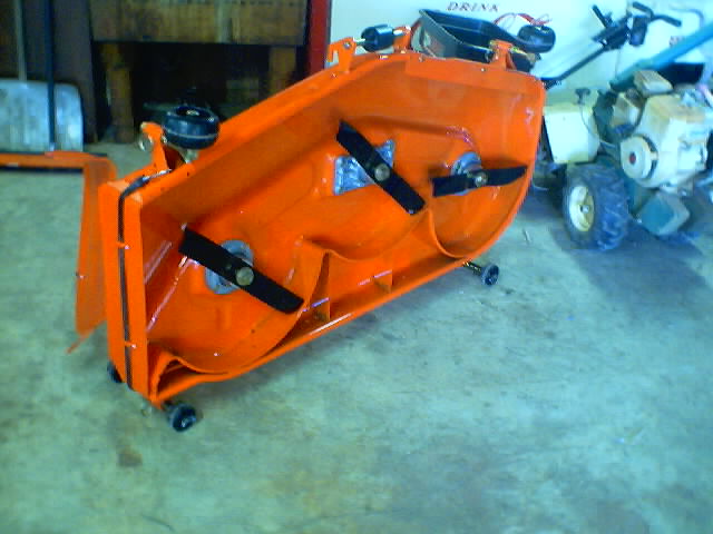

I have a set of those moweraxles and they work very well for stowing and serviceing the MMM.
Volfandt

Well, since we're having an indian summer Halloween here in the North East, I decided to take a break and practice dismounting my mower for the first time.
Dismounting was easy and straightforward, but I had a little bit of trouble re-installing the lift links when I went to reinstall it. Guess practice will improve it, but for some reason I had a devil of a time lining up the pins into the flange. Other than that, the only other slightly ackward part was reseating the PTO coupling, since you have to get down and under to do it.
You can get dirty doing it compared to the FEL and BH, but still tool-less.
SP
