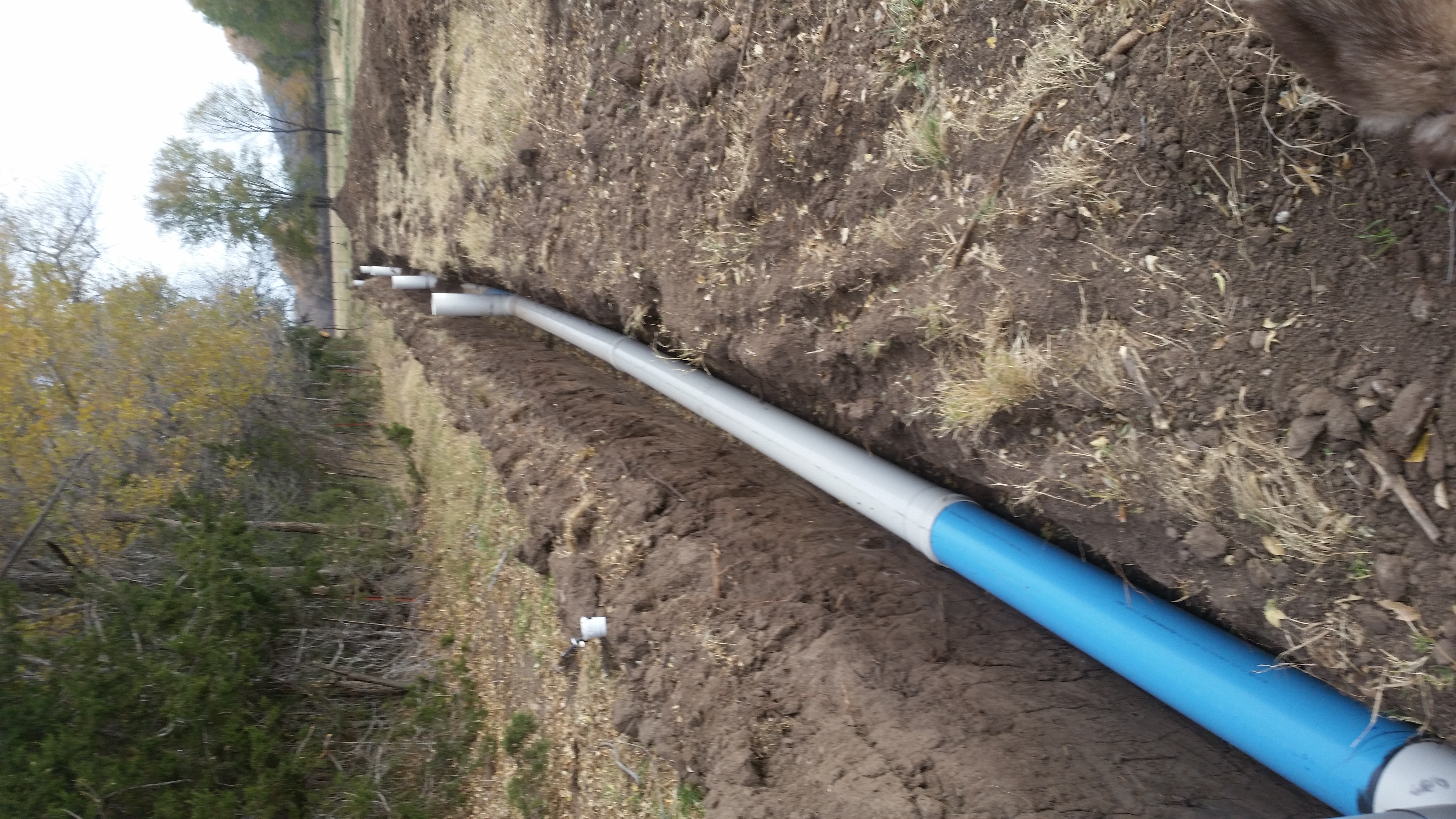

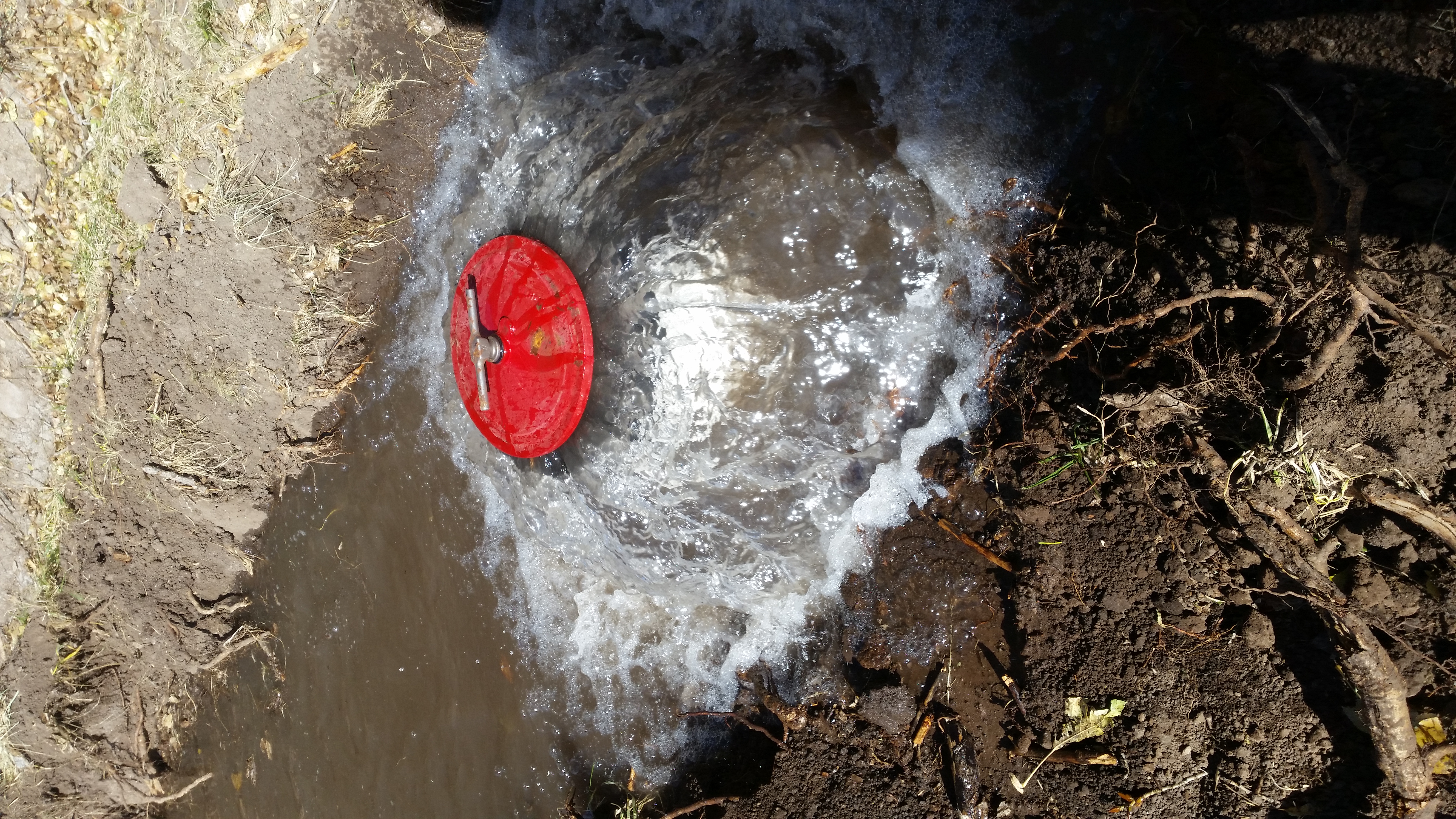

For my work with pipelines that are gravity fed, elevation changes and friction losses can be very noticeable. Here is a picture of a 12" line I installed last year and the flow through one of the valves..
