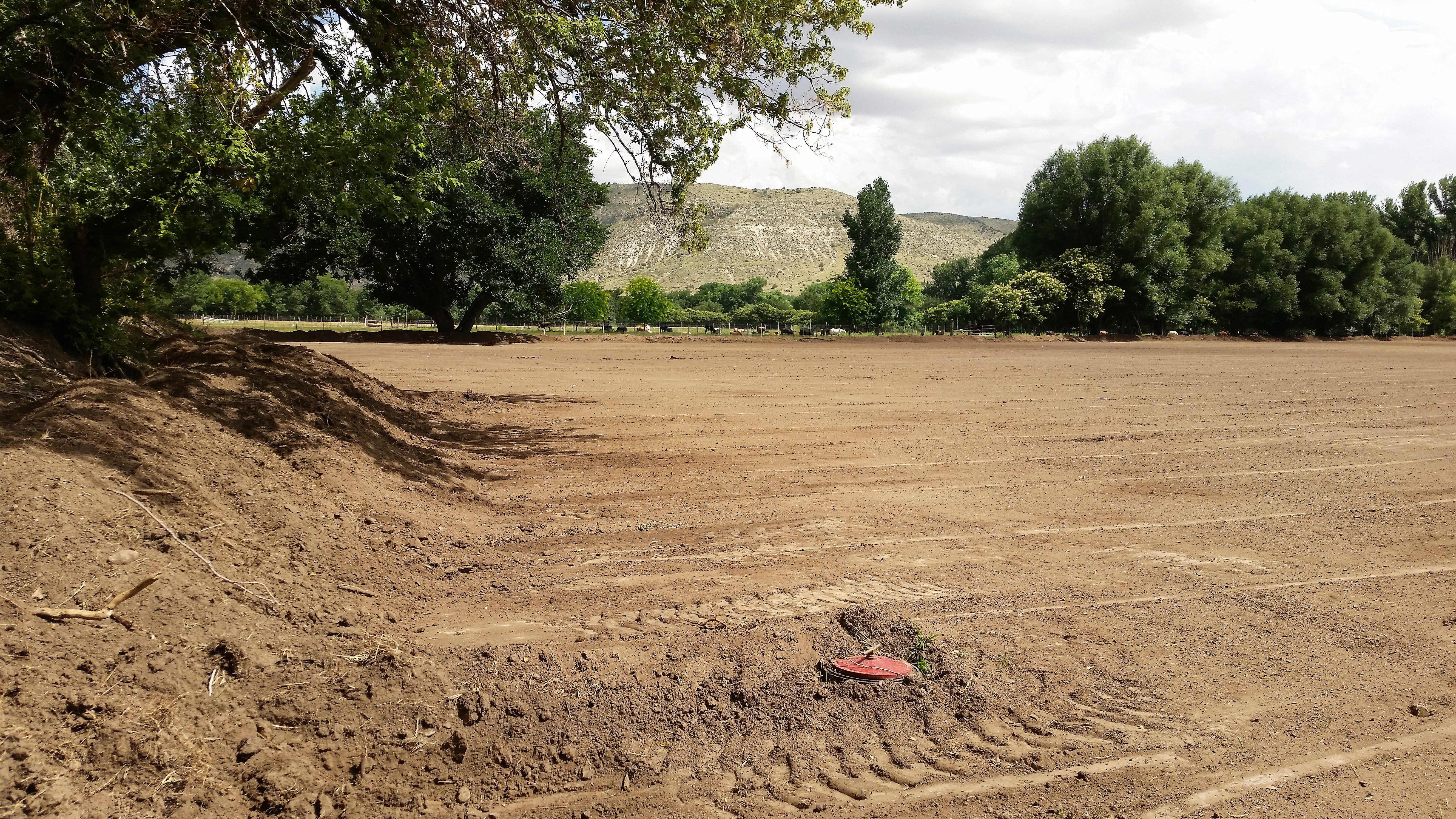

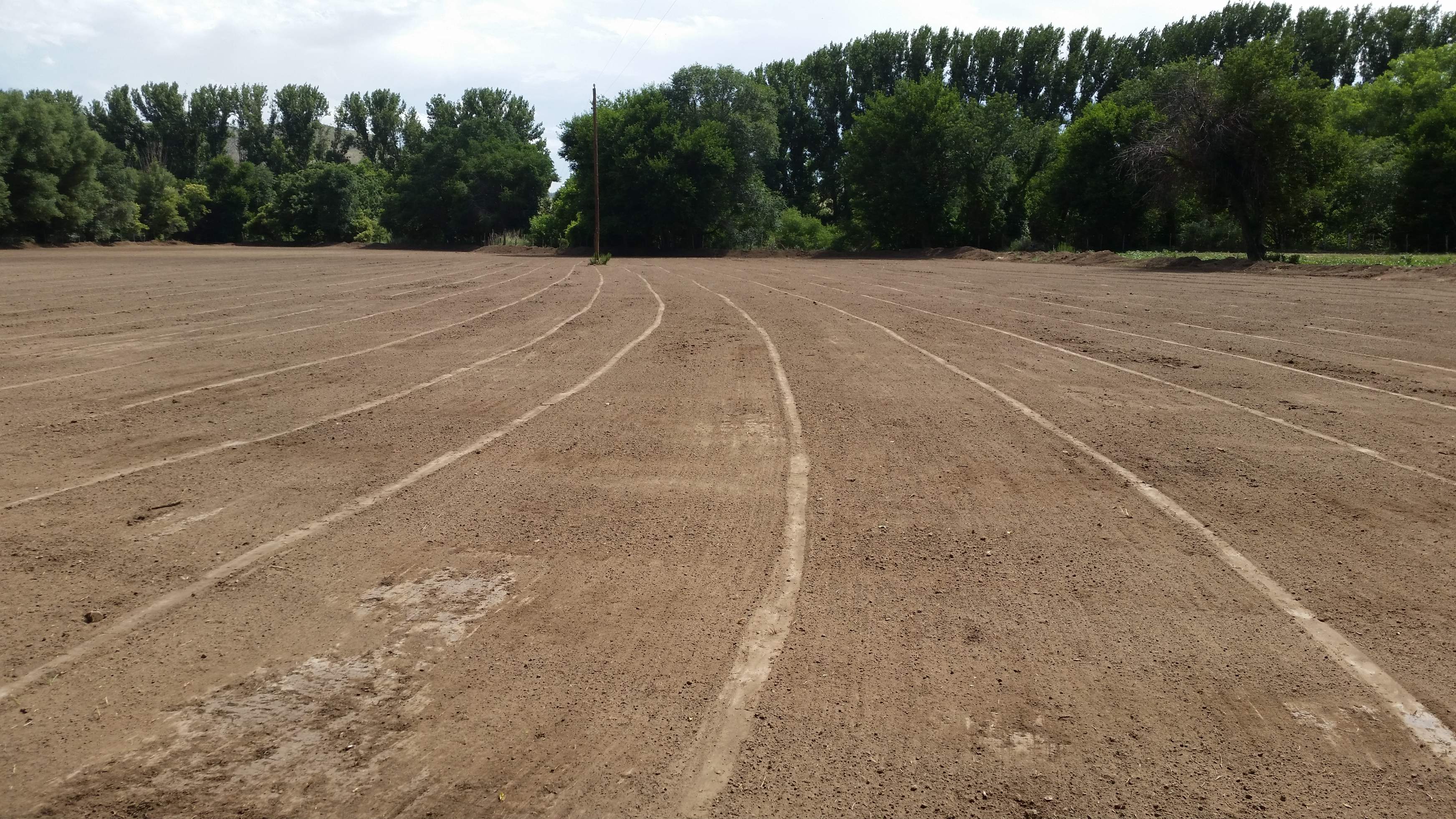

If you have a box blade or land plane s tine cultivator these can all be helpful in smoothing the field. In the pictures below you can see that box blades and land plane grader scrapers do a good job of smoothing.

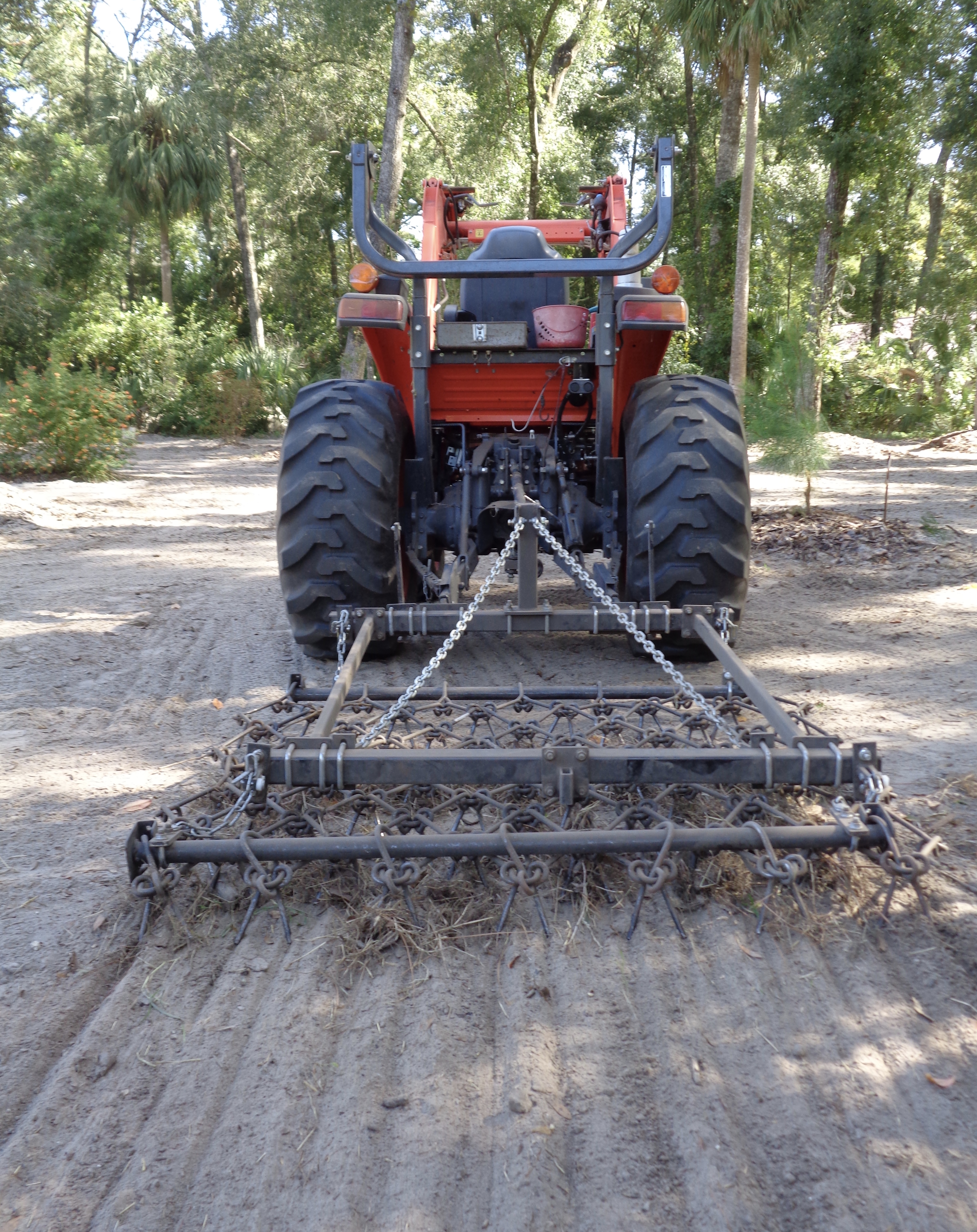

Regardless there are huge numbers of weed seeds in the soil which may take years to get under control through cultivation while immature. PHOTO #2
I have a BIG job in a week or two, discing and dragging about 10 acres. Disc, Disc, Disc all diff directions, then drag, drag, drag.
If you plow moist soil, then let inverted soil lie in the sun for a few days, it should only take three passes with an amply heavy Disc Harrow, adjusted less aggressively after each pass, to smooth plow furrows. Disc Harrow is the smoothing, leveling, evening implement. Many, not all, are satisfied with field condition after discing alone.
Then one or two passes with a Chain Harrow to smooth further if desired. A Chain Harrow does not move much dirt. A "lift" or "framed" Chain Harrow can be cleared of accumulated trash by elevating the harrow from the tractor seat. PHOTO #3

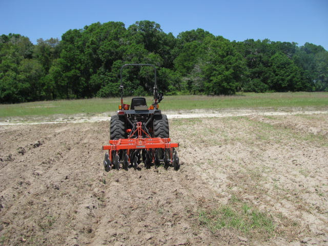

Many planting seeds use a heavy Cultipacker to roll in seeds and perform final pass over field, although a Cultipacker presses shallow, long duration grooves into the soil to retain moisture after rain. PHOTO #4

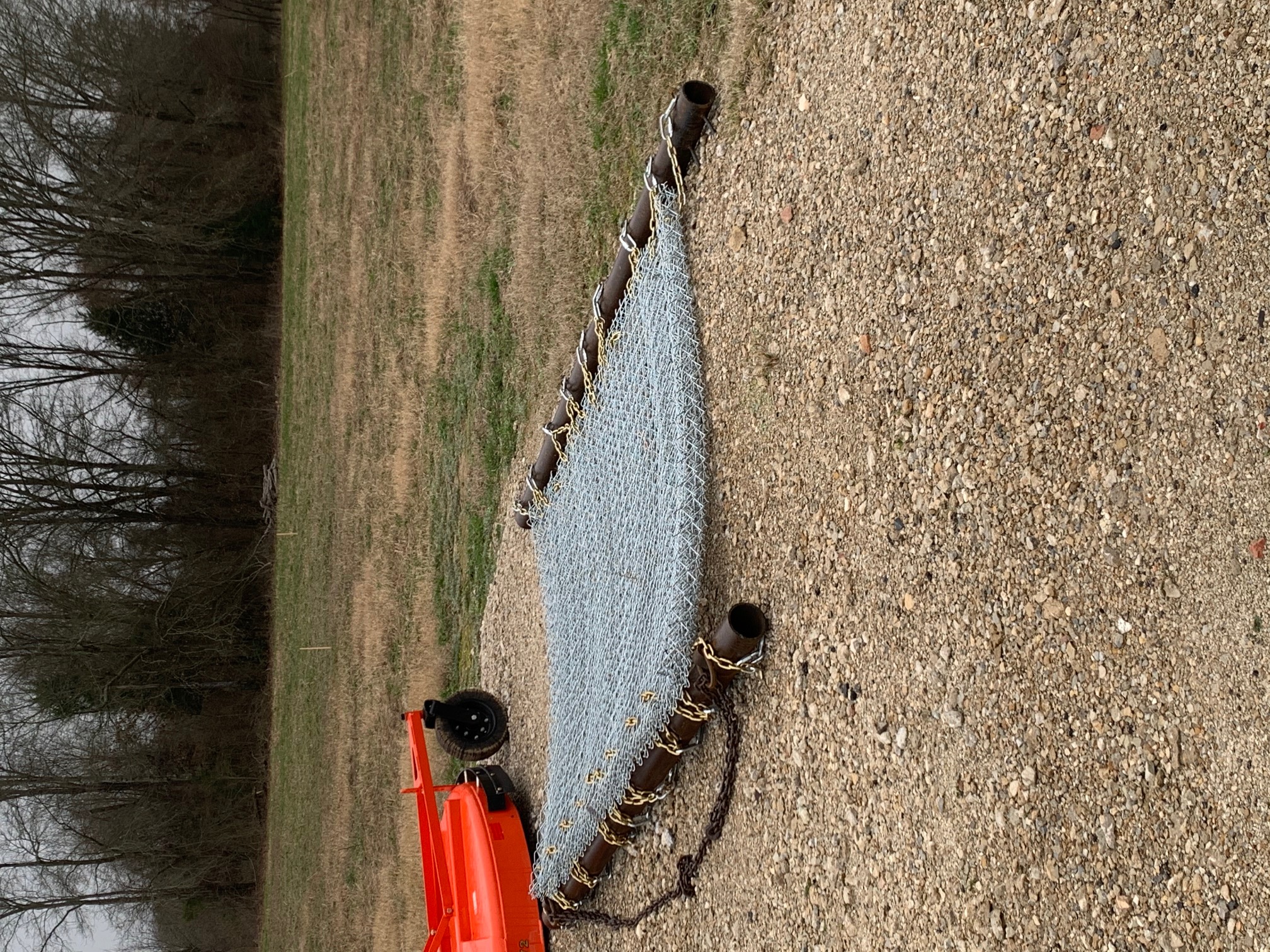

Yes. Have a box blade and I also built a chain harrow out of chain link fence linked between two 10 foot long, 1/4 inch thick, 4 inch diameter pipe. It will be a lot of work. Here痴 my harrow. Not the best, but it only cost $350 to build. I couldn稚 find any used for less than $1K
