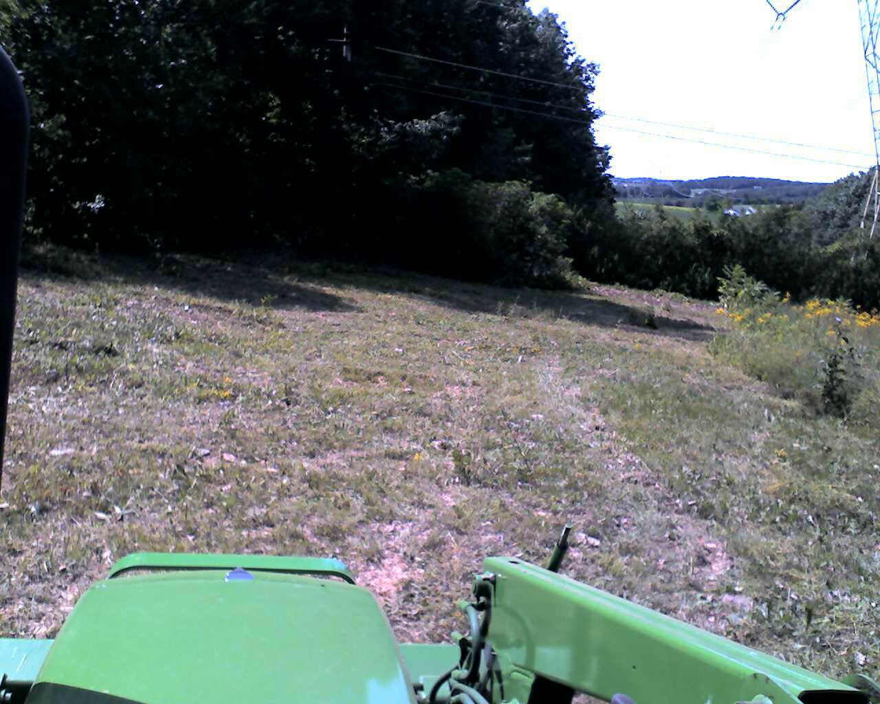

I've got the same problem with cutting the Eddie Walker has...the acreage is just pretty darn rough. The fix would be to get a dozer in there and really clean it up...but, since it's a power line right-of-way (Power companies don't own the property...they just have the right to run the lines over them. I guess the land under each tower is owned or leased by the power company though.), I don't think anyone is going to do that.
So, I'll go slow and scalp every now and then...but it'll never be a lawn (see attached picture). It's not really that steep, BTW...I was using a phone cam and didn't have it level.
There was a TBNer a while back who was going to add casters or other type wheel at the front on the cutter to prevent scalping. I don't know if he ever actually did this...but if you want a smoother cut from a cutter, that might be something to consider. In fact, the wheels and spindles off a scrapped finishing mower would work, if they can be found.
Eddie has a good point about the dust...and a guard isn't going to help. This is one of those jobs where a face mask is pretty important. It's not just the dust the cutter is kicking up, it's all that pollen from the brush being cut. If the area is level, this job could be done after a rain to reduce the amount of dust and pollen kicked up.
