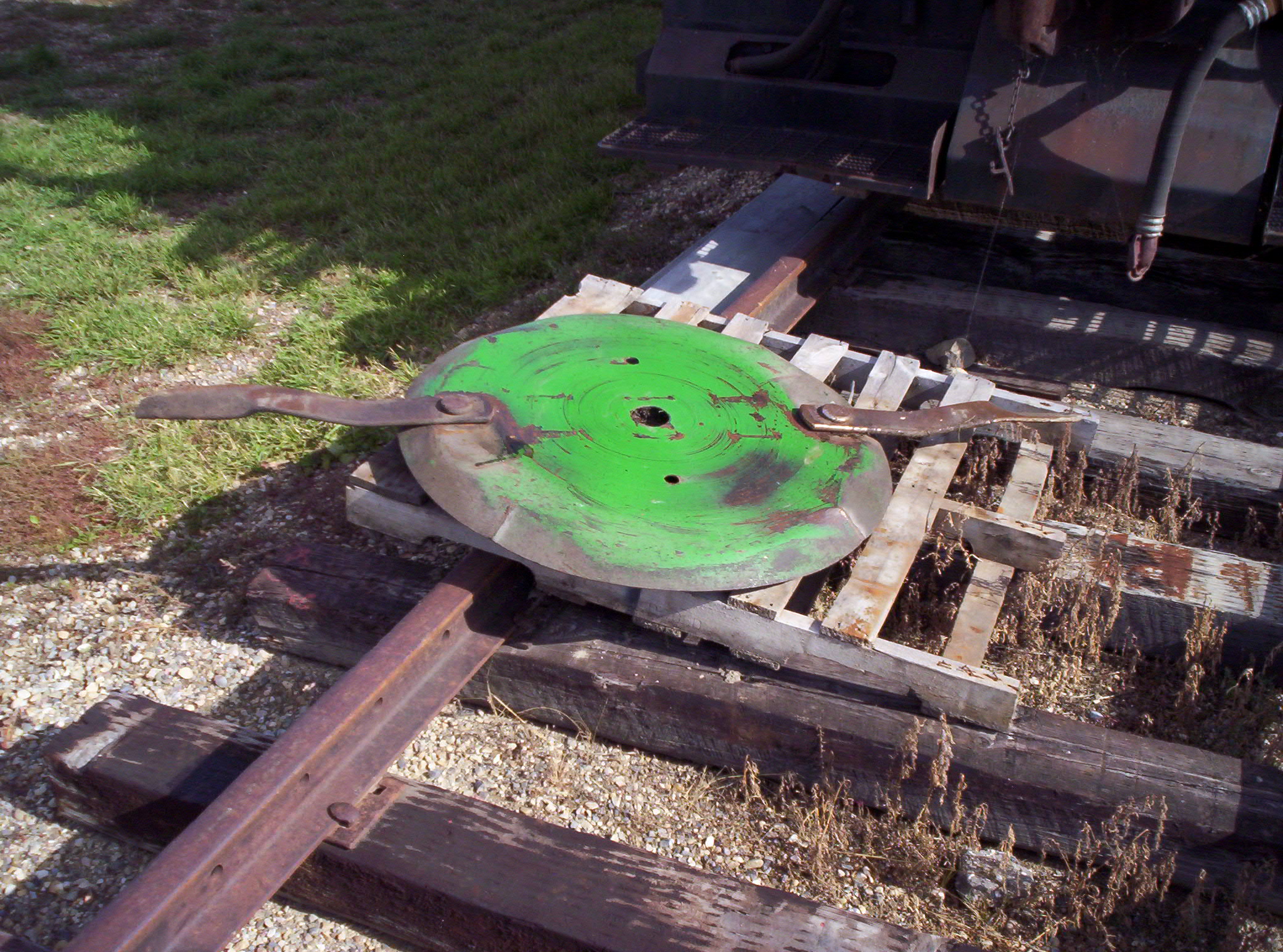

Here's a picture of the blades and pan

Man, those blades look pretty jacked up. Someone must have hit something unforgiving to cause those kinks.

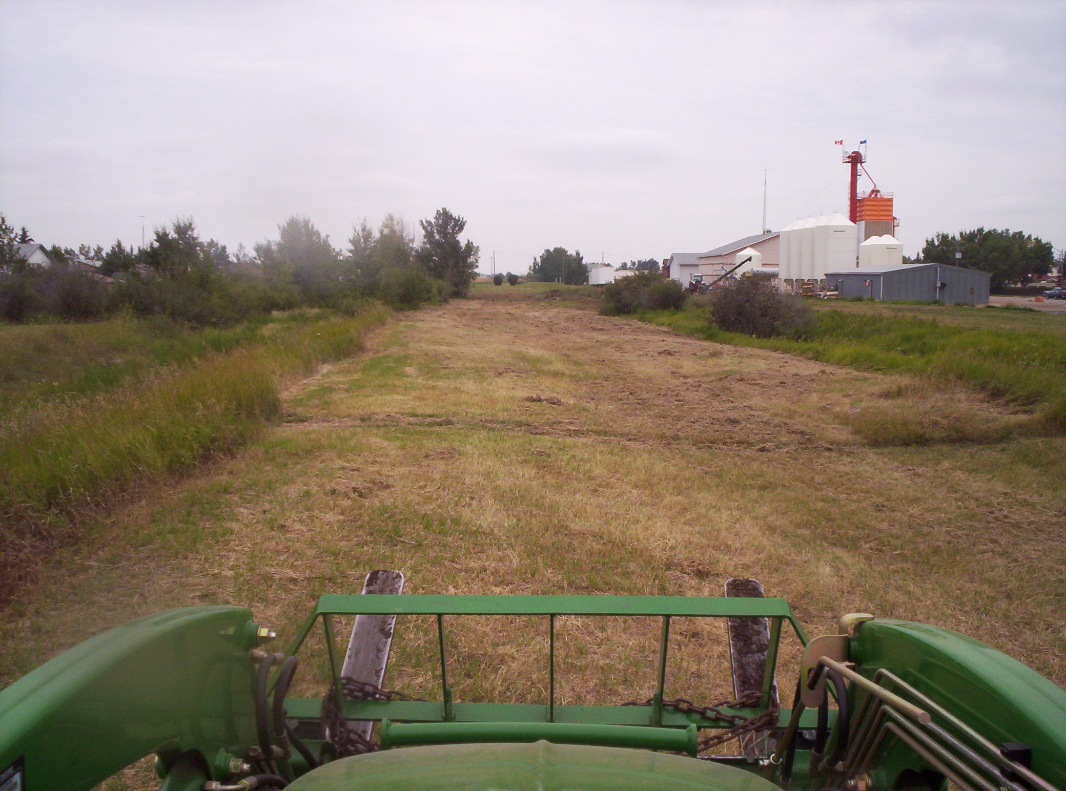

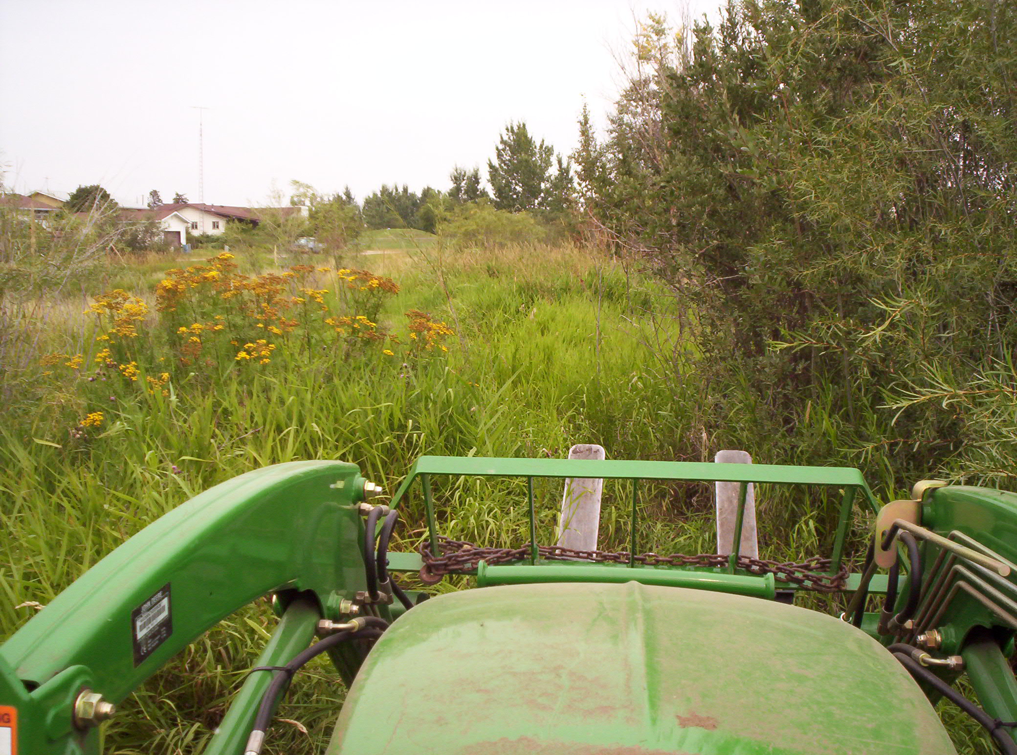

They do don't they, it's because of the angle of the stump jumper sitting on the track. The blades are offset and angled toward the cutting edge. I'll get a better picture tomorrow. Yes the blades take a beating some people like to crush gravel with it. One of the perils of having a volunteer work force is the different skill levels of the operators. We are cutting grass in some areas that haven't seen a cutter in maybe 20 years. I could write a book about what we have found or should I say hit.
Yes we have trains and a tractor.

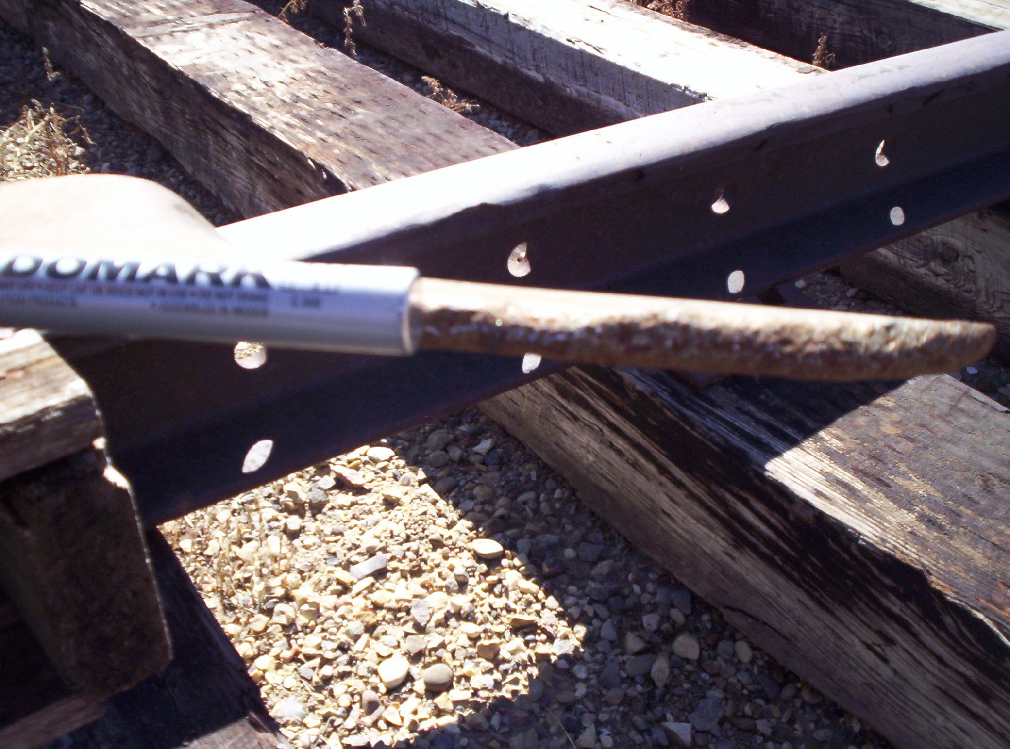

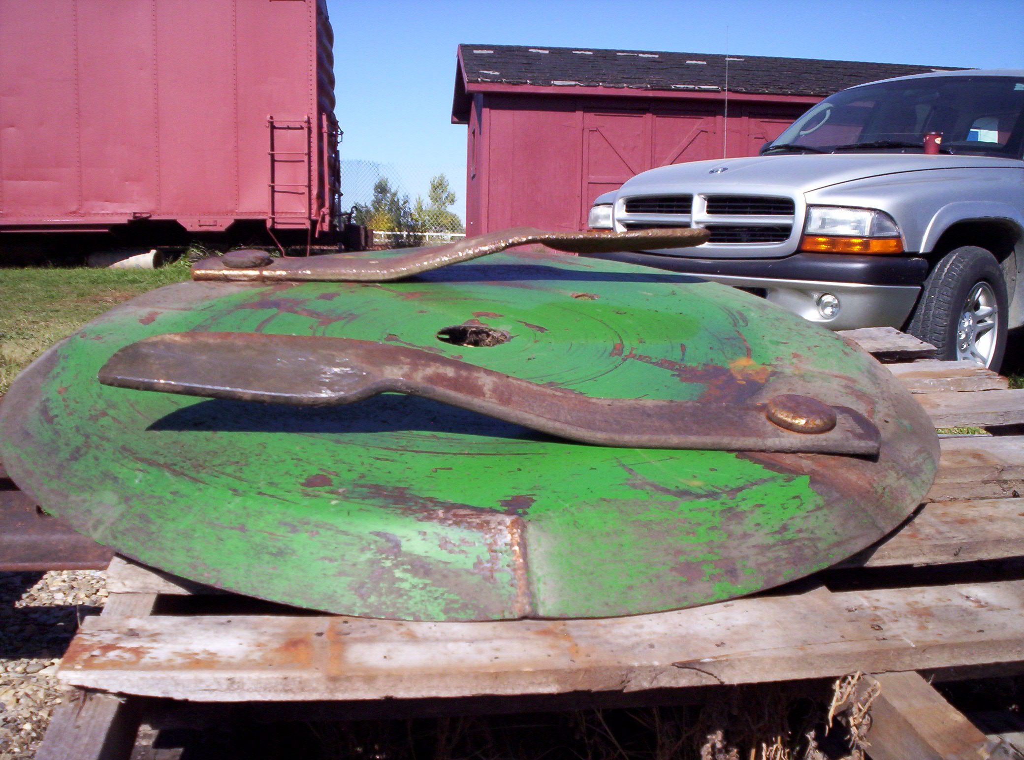

I agree after looking more closely at the blades and reading everyones reply sharpening the blades is not a good idea. The blades on the RC1072 are more like bars than blades. Anyways I don't think they would stay sharp very long to matter.

I forgot to mention in the cutter photo. I used a maker pen for comparsion to show how thick the cutter is.
