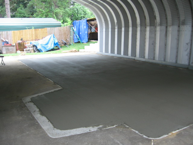

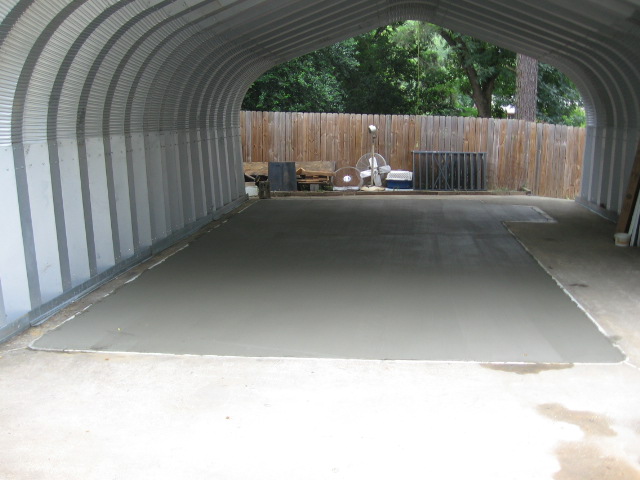

Here's where we stand though I started on the end walls today can I attach the end walls with self tapping screws to the inner end piece? Any suggestions also it looks as if I will have to trim is this normal? Thanks to everyone thats offered suggestions and encouragement.
