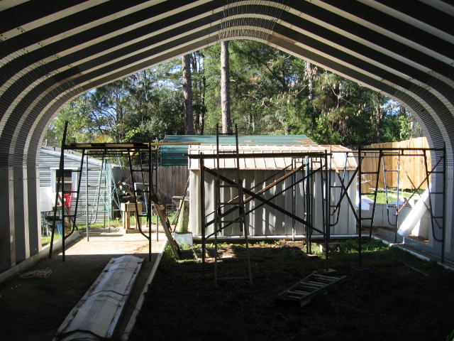

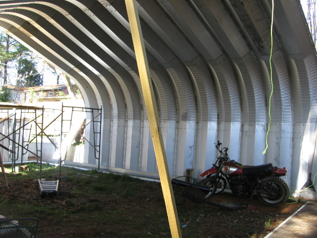

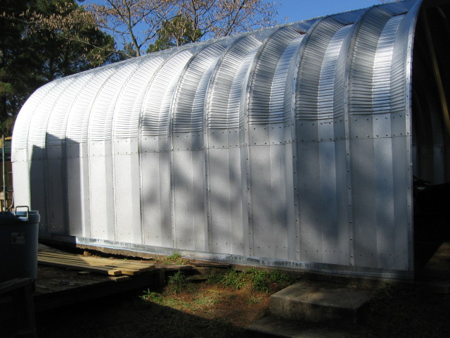

Okay here's where I stand 12 sections up new nuts and bolts are in, Hopefully will have it up by the end of the year then we figure out the deck or end pieces ... Here's a couple of pic's

I know I am doing it backwards but it's the hand I was dealt the other buildings must come down and I only have a certain amount of time since I had to get a permit... Still wondering about cement or end pieces first... I figure six steps.
1. get shed up and tight
2. cement side channels
3. end pieces
4. cement deck
5. lights and power
6. overhang on front
Since I am poor this is a cash only project.. Have to move stuff from the other three sheds as they are torn down, to meet my permit requirements, One shed is down already... This has been a fun project so far since I have done it by myself, pain to move scaffolding a section at the time but I are getting there. Need to figure out end pieces since goal is to get a old tractor to refurbish need to figure out size for roll up.... I have old mechanical stuff Motorcycles and stuff and want a old tractor also ... Just my dream Thanks to everyone that has responded I will keep you all posted...
   / How hard is it to assemble a quonset hut type bldg #90
Looks good. I don't see your "L" strapping....are you moving it down as you go? If you are not using any, then you are doing a outstanding job of keeping it from leaning & square. I had to use strapping mine started leaning just after a few arches. You can move it as you go or just leave it on the building. I figured it would add to the strength so I just left mine on.
