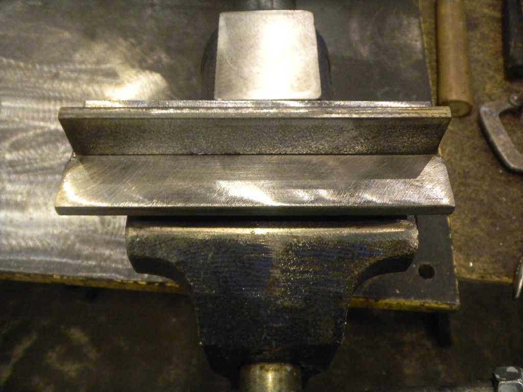

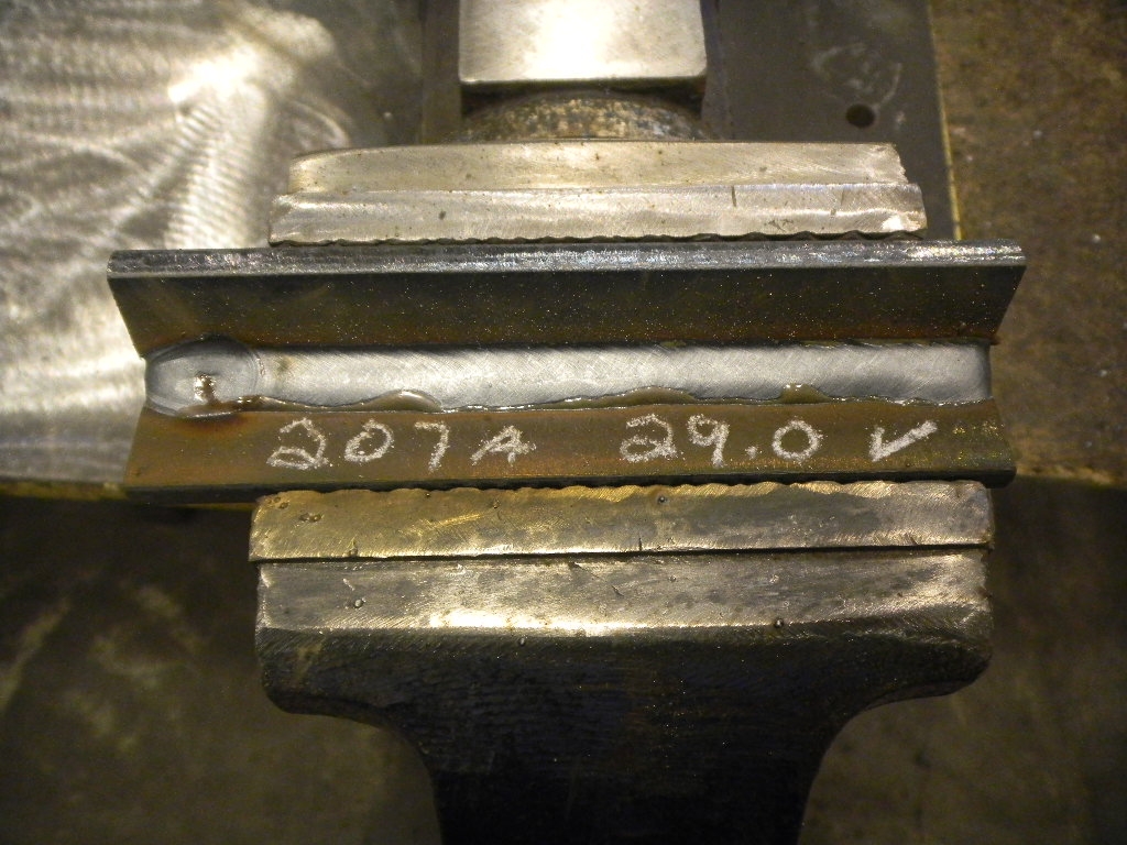

Spray is very fast too. The metal has to be real clean.

During my welding class I spent most of my time with a Miller 210 trying to make MIG welds that didn't resemble bird excrement. One day the instructor hooked up a Millermatic 350 and let us play with spray transfer. LOVED IT!!! Makes a novice look like a journeyman welder in about two minutes. Of course weld appearance isn't everything but boy does spray transfer look nice.
