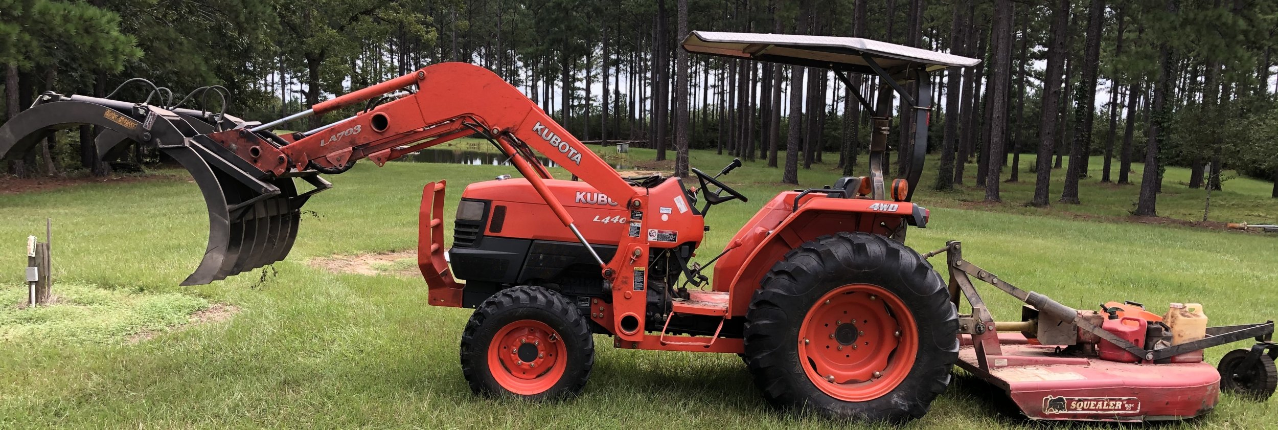

i do not grow row crops, I grow trees. So my problem is a very limited maneuvering space, between the rows, and a need for weight and power with power steering. I have a Kubota L4400, 45 hp, 4x4. I opted for the standard trans to increase the hp to the tires, filled the tires with water and increased the lift capability of the FEL to near 5,000 lbs. I useually operate with a root rake with 1” thich tines or forks, a two ram grapple and a heavy Bushog, Bushog on the 3 point hitch. The Bushog counter balances the lifting weight. Each tire weighs 800 pounds, so the total package is heavy.
I have an 18” cutter head heavy frame House disk and a landscape rake. The 3rd pass with the House disk is to the axles in this had clay.
I have planted a couple acre or so food plot, deer ate it up as soon as it came up. Deer here are pretty bad about eating everything green. They come out 20-30 at a time on my 250 meter rifle range to eat the grass.
I would go for a low, wide stance, heavy tractor with enough power to pull a heavy cutter head disk set. It should be able to make sharp turn without skidding or hopping. My upgrade will be an M series 50 hp, same width, industrial tires for mowing. That steel canopy is a life saver, literally.
