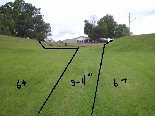

I cut my field like a golf course i have a 12' "green" walkway to my garden i cut the same as my yard about 3-3.5 inches roughly, then, the rest i just let grow to say 6" or so (about 3-4 weeks worth or growth) mainly to keep erosion down and act as a water break for my hills.
another added feature of leaving a backyard or back 40's at high level is if the land is hilly bumpy or rough it won't bottom out the mower if you have a large size finisher or bush hog.
