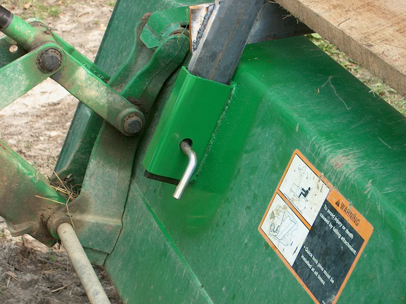

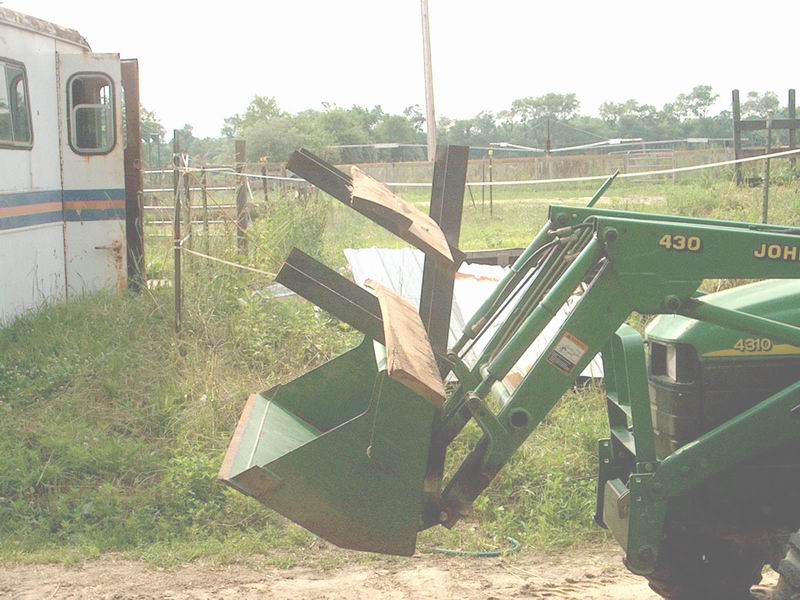

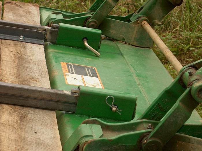

   / How I attached hooks to bucket--photo #18
here is a universal mounting i made
