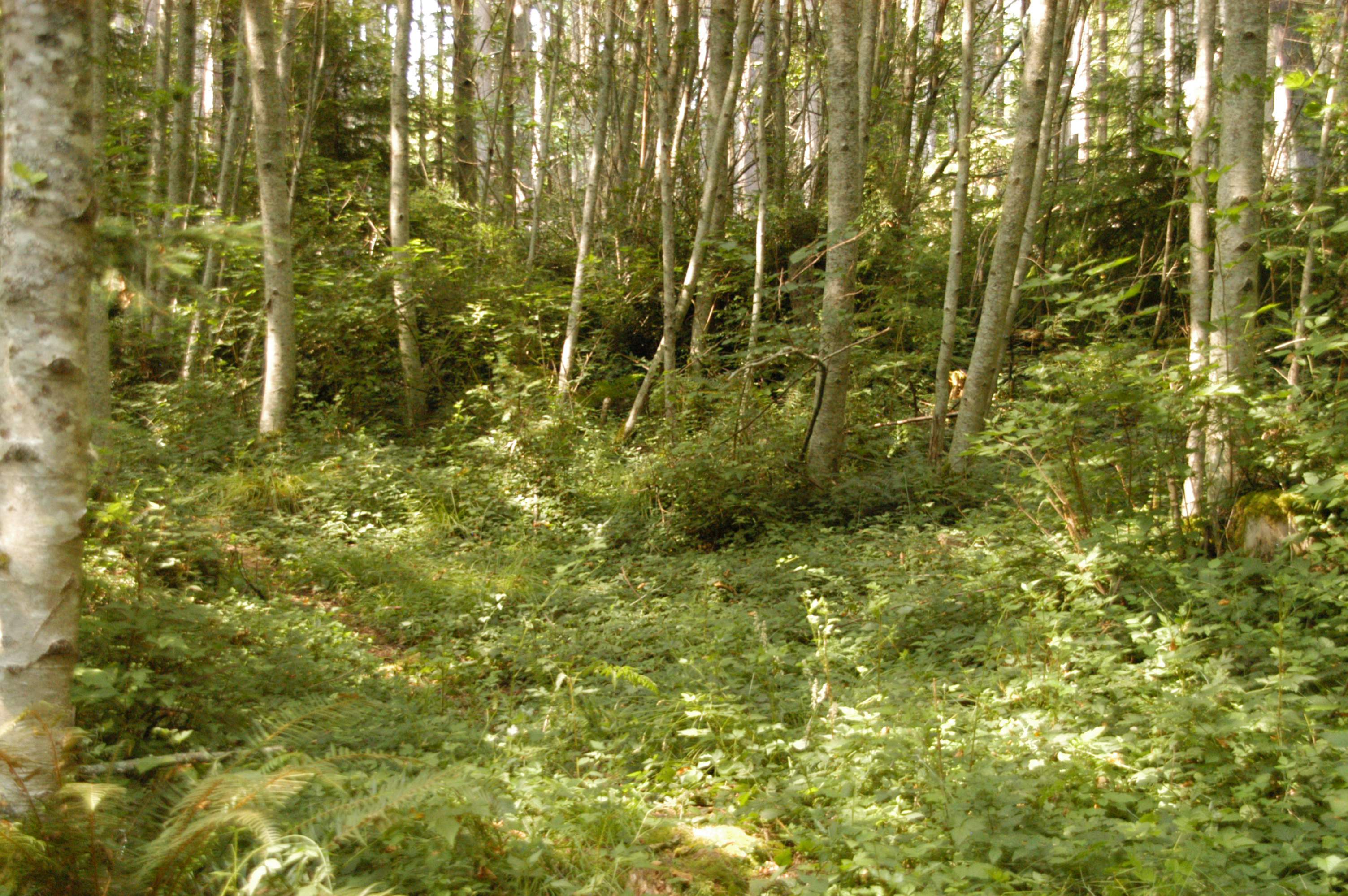

I'm getting ready to pull the trigger on a new Kubota L45.
The thumb kit adds $1900 to the total cost. I notice that most backhoes I see around don't seem to have them.
I've rented a trackhoe a couple of time, and each time I used the trackhoe thumb. But I don't know if this is something that I used because it was there, and would not really have missed if it was not there.
I have an enormous number of 3" - 6" DBH alder tree stumps to remove. Alder is pretty shallowly rooted, so I imagine based on that that this would be something that I would use every day?
Thoughts and advice?

Sorry, I should have added.
some sort of ripper/root rake/skeleton grapple will be my first attachment. Still working out which one it will be.
I feel that I should get some amount of drive time on this thing, before deciding that I need this additional stuff.
however getting the whole tractor in place to pull out some of these stumps might not be very feasible. this attachment is one of the more cleared areas that I will get to deal with.
