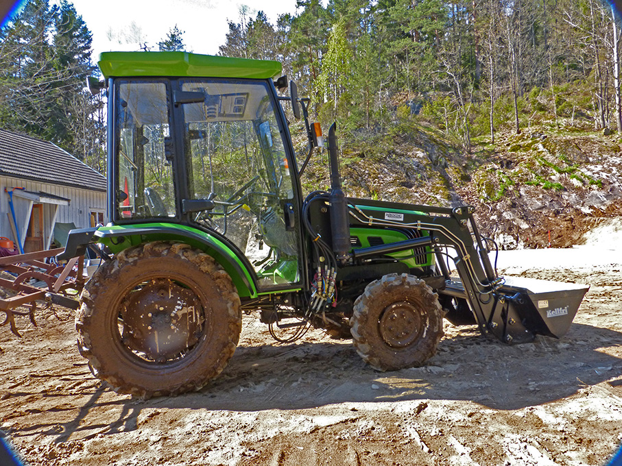

New to tractors. looking for something 25-30HP for plowing snow, working in the woods, moving dirt, etc. 8 acres on north side of a fairly steep ridge. Looking at a Yanmar 424 since dealer is only 5 miles away, but from everything I've read, there is no locker on the rear axle. Is this a deal breaker?
Thanks for your opinions.
John
Have only used the diff lock on my Foton 254H once, but that was enough to warrant it. Was stuck in gooey mud to over the front tires, and the 4WD wasn't enough. Saw the unpleasant possibility that I had to get out in the deep mud to get help, but remembered the diff lock. A bit of rocking, and I was able to get out. Rather chuffed not having to have the mud bath! So, the difference between diff lock or not comes down to the problems you face when you really need it. I wouldn't even consider a tractor without it.
After the dip in Big Muddy
Jonn
