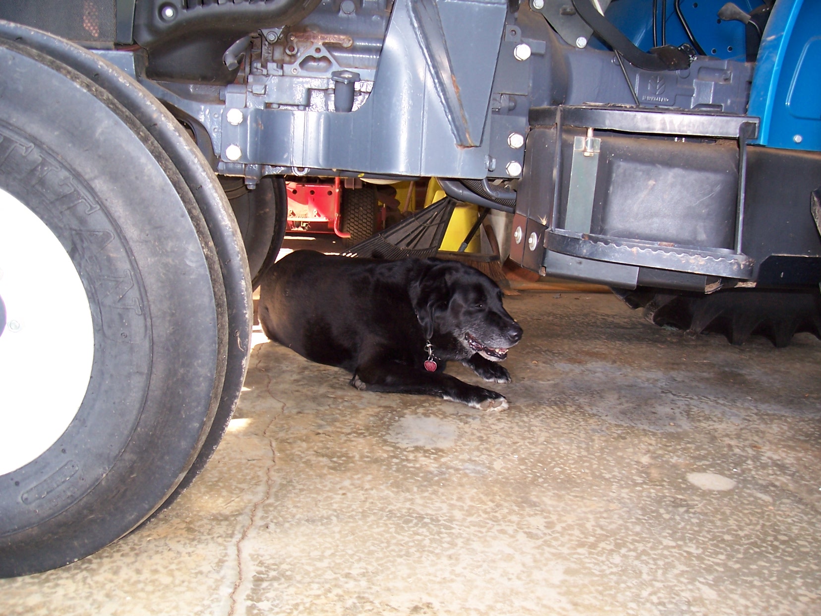

I'm off to the farm for two weeks on Saturday. I'll post pics on my return. I should have pointed out that my tractor is 2WD, and I use it mainly for bush-hogging.
Steve
I found this picture of my best friend, Toby, that also shows the tires of my tractor. I'm "guess-timating" that the tractor had about 230 hours at that time. It's not a very good picture of the tires (or Toby for that matter), but the tires don't show that much wear IMO. I expect that I will have to replace the tires due to dry rot rather than tread wear if my usage pattern continues.
Steve
