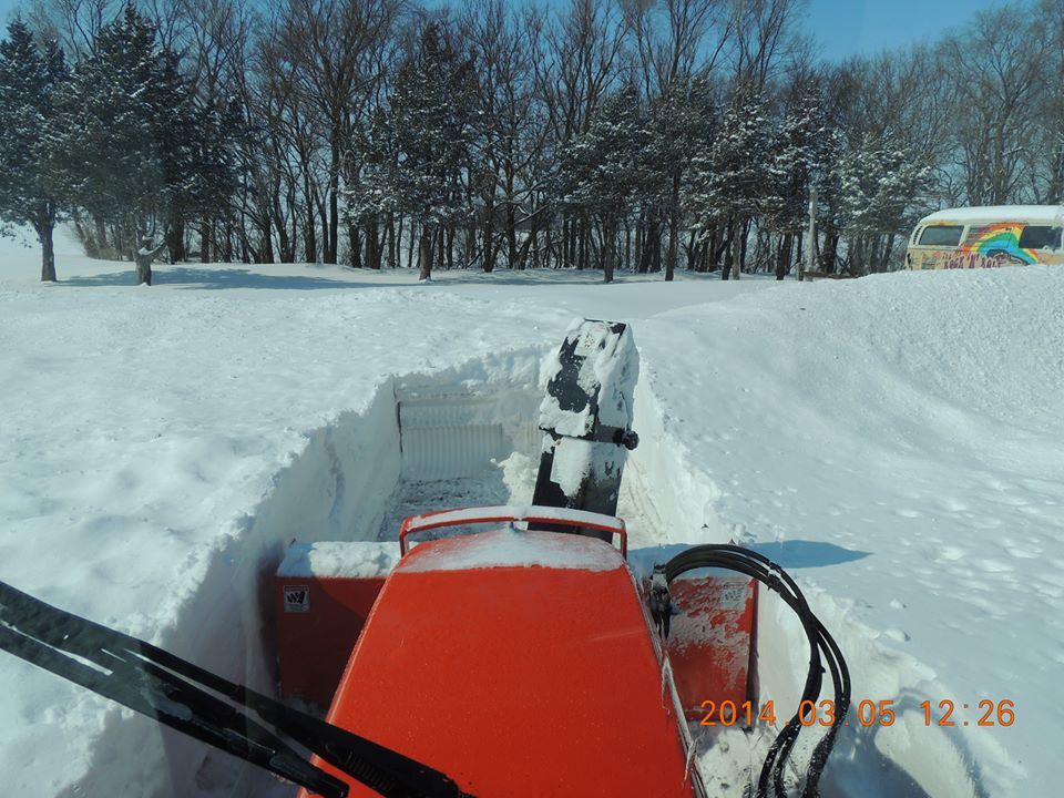

   / How long does it take to put front snowblower on a BX? #6
Is any front mount snow blower really worth all the effort ? You decide ! :D

   / How long does it take to put front snowblower on a BX? #8
I can't tell from the picture, it looks like front mount blowers are the cat's meow from that picture, UNLESS your drifts are so high and heavy that you cannot get through them - and would need a rear mount blower (and probably a bigger tractor) instead.
