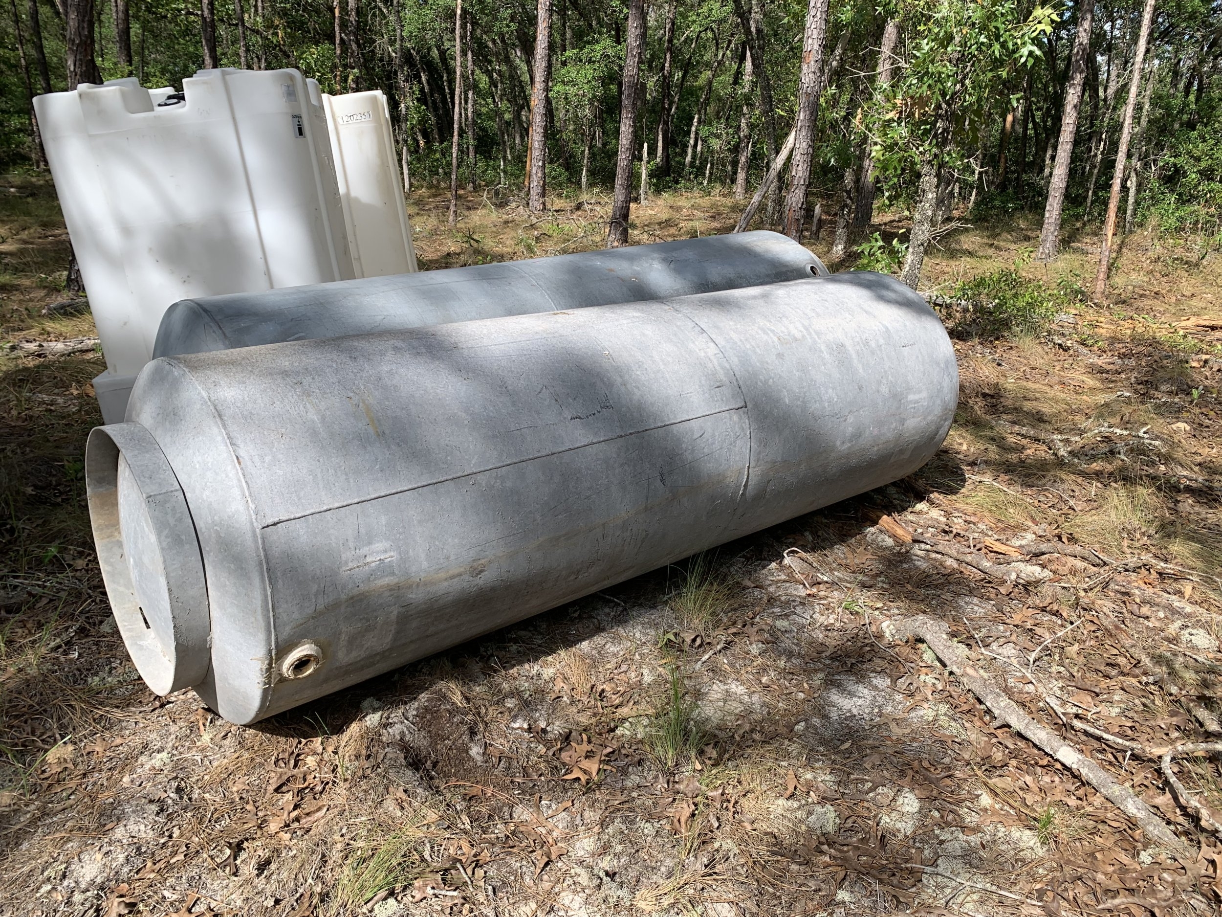

Can anyone here tell me approx how many gallons of water these might hold?
Dimensions are approx 36x116 long.
I was told they were 1000 gallons a piece but I don’t see that.

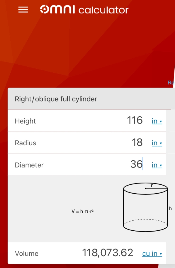

If your dimensions are in inches, the volume is about 118,000 cu in. So it should about 500 gals if my math is correct.

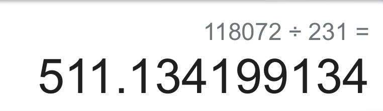

There are 231 cubic inches, 3.8 liters in a gallon (or Grandnational engine).
Your 36" is probably OD and you can't count that, you need ID.
In any case, you find the volume in cubic inches.
And divide that by 231 to get gallons.
   / How many gallons #7
Very seldom do I get to join a math conversation, so here I go. :)
I don't know why, but finding cylinder volume is one of the few math formulas that I remember from school as a kid.
pi, times the radius-squared, times height equals the volume of a cylinder.
