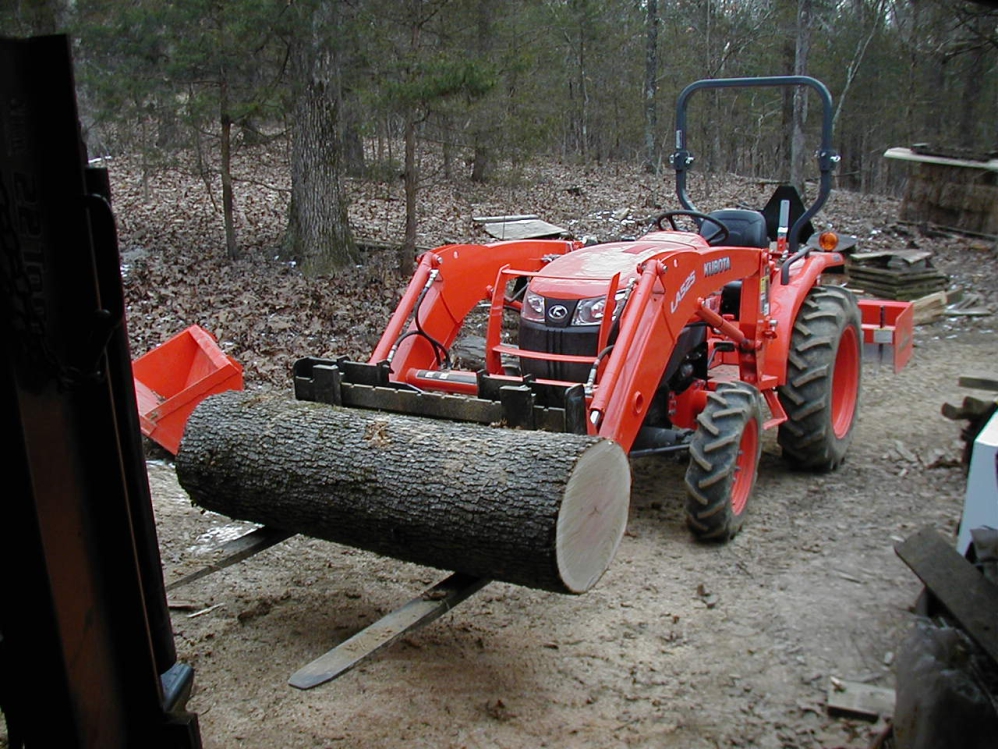

Most of what I do is cutting firewood to heat our home. Most of the time I'm using the tractor it is 30 degrees or colder, I don't like cutting wood when it is much warmer than that. I have many hours on the tractor that it was in the teens while I was using it. The picture below is what I do most of the time with the tractor:
attachment.php

#37
aarolar,
attachment.php
Makes sense then most of my hours are mowing or pulling harrow or my rake.
