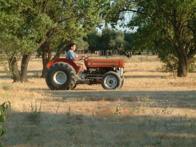

You didn't mention whether you're leaning toward a new or a pre-owned tractor.
If used, then I'd look for something that's set up for orchard and/or vineyard use. I bought this 1964 Massey Ferguson 135 diesel in 2006 for $3600. It has 16" dia rear rims instead of the usual 28" dia rims that you usually find on field tractors. The short front wheel spindles are used to lower the front end and keep the tractor level.
Those 18" wide rears increase the wheel track to about 83 inches to produce a tractor with a very low center of gravity for safety when working on hills.
The previous owner used it to mow and spray his olive orchard.
I cleaned it up, repainted, rewired and rotated the exhaust system to the vertical orientation for use in my hayfield.
