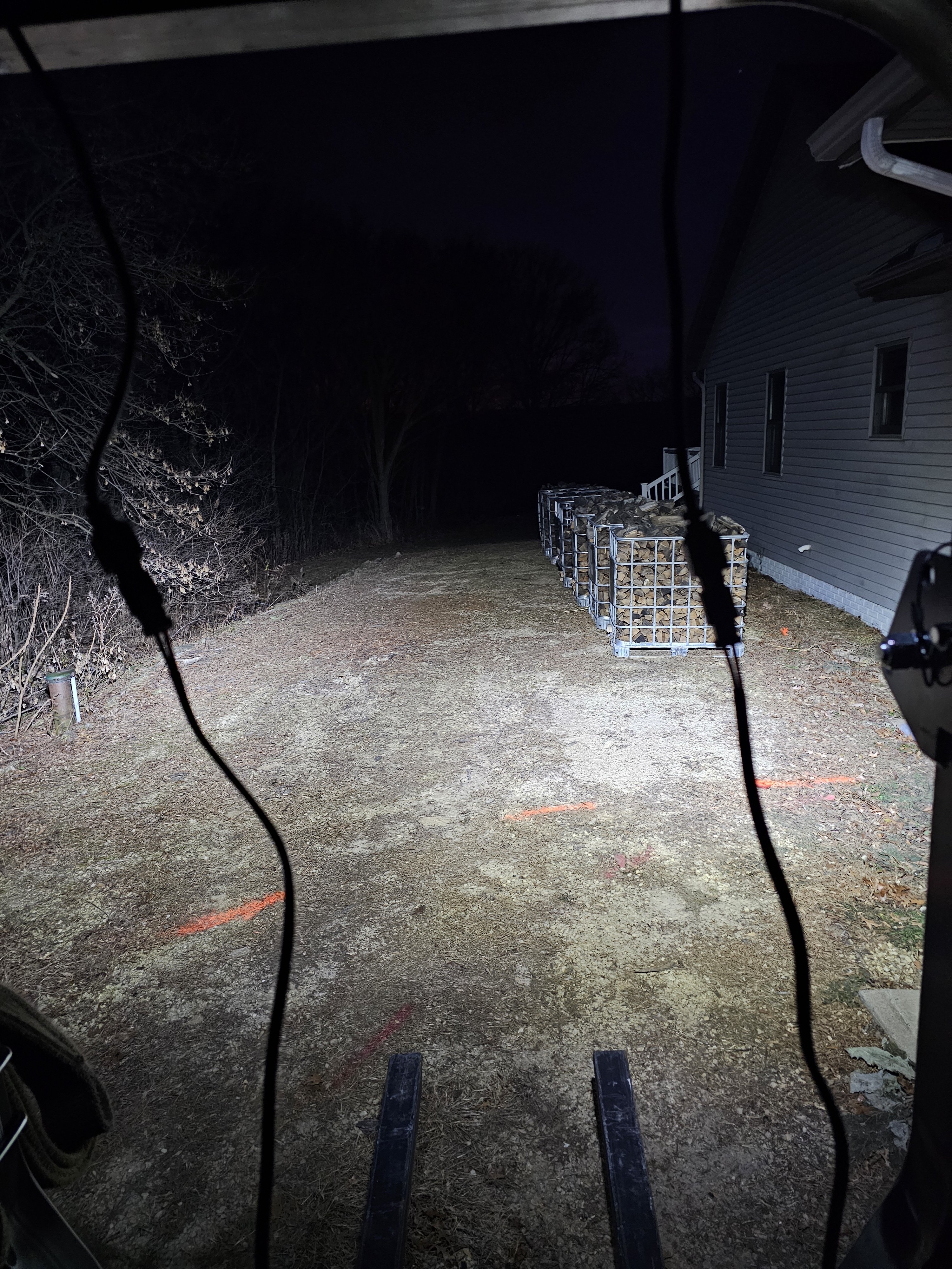

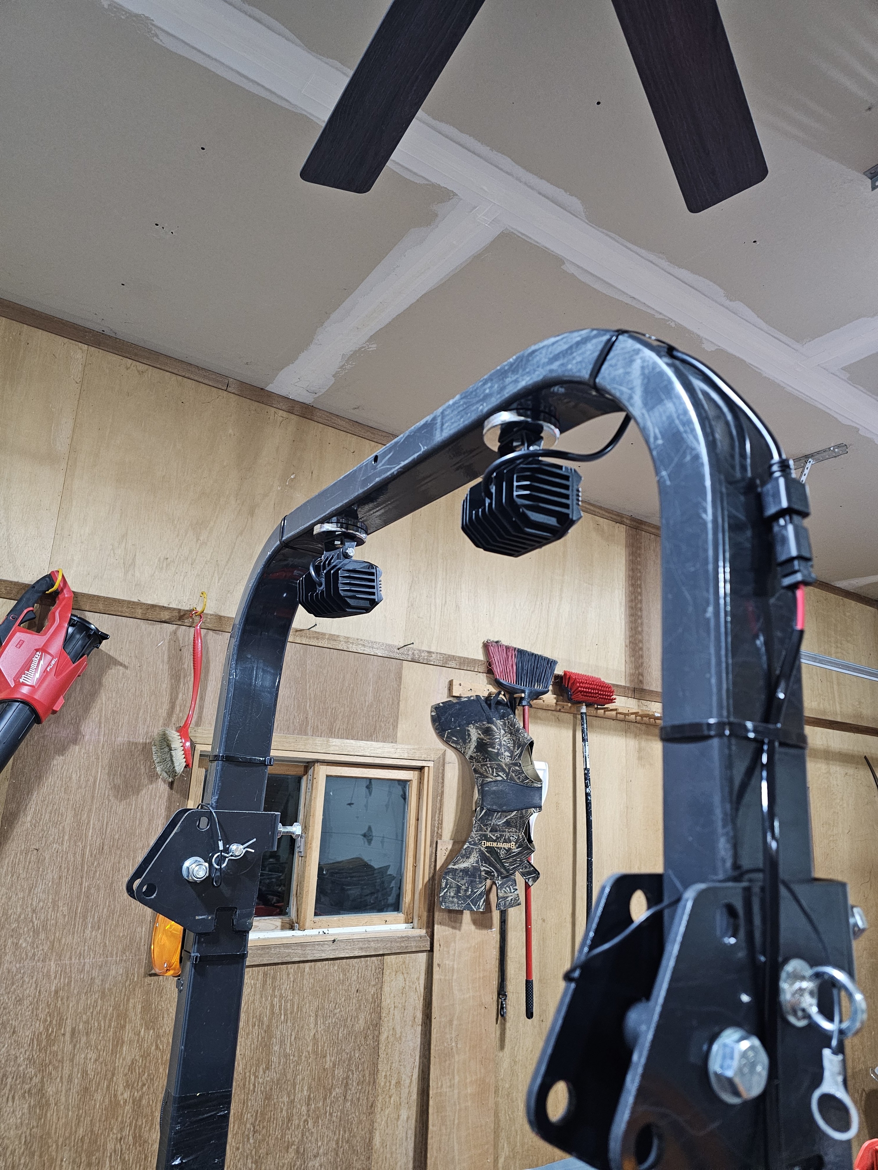

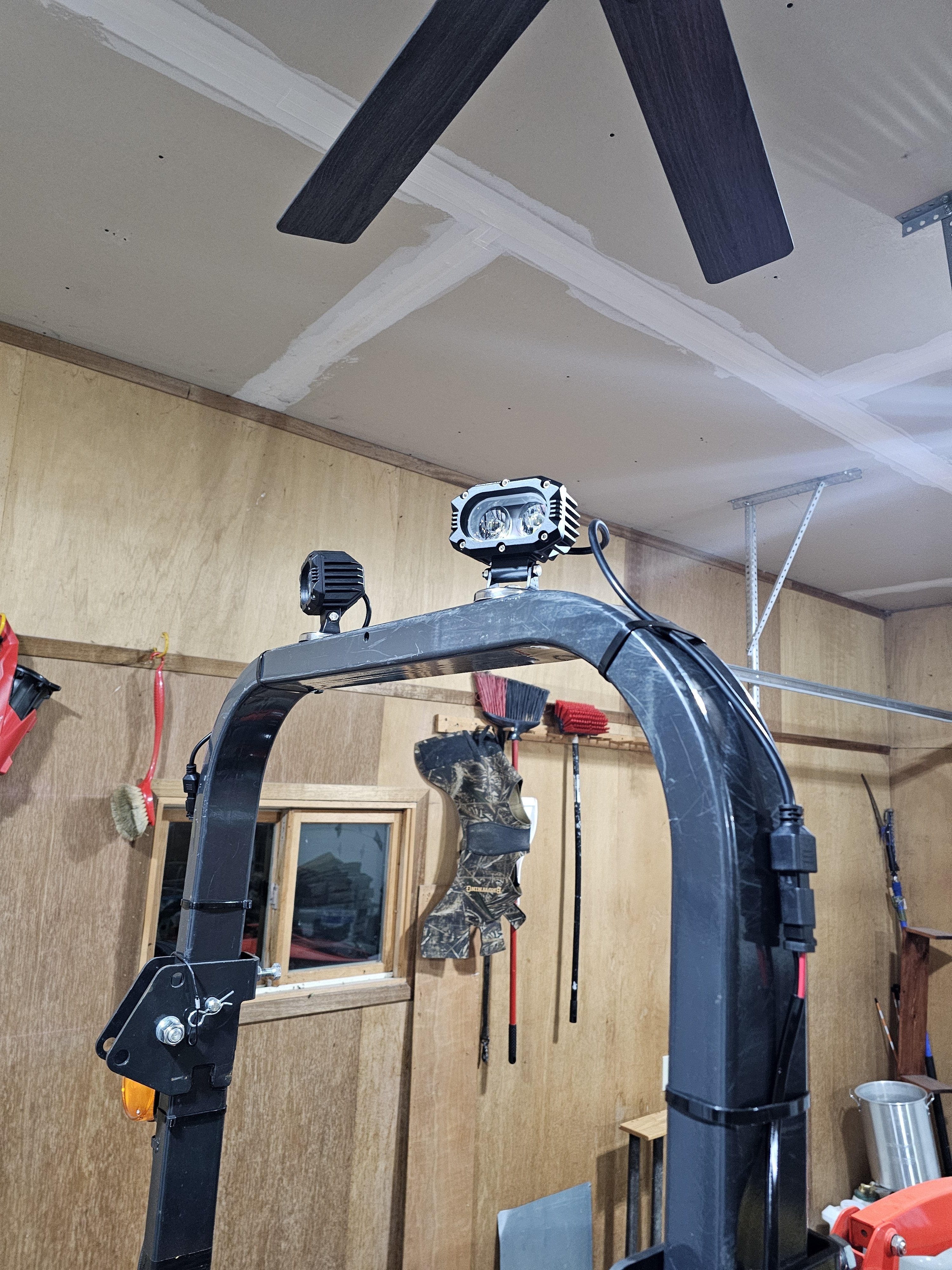

My flood lights are mounted with magnets. In the woods I flip them under. Forward for driving and using the front end loader. Backwards for snowblowing
