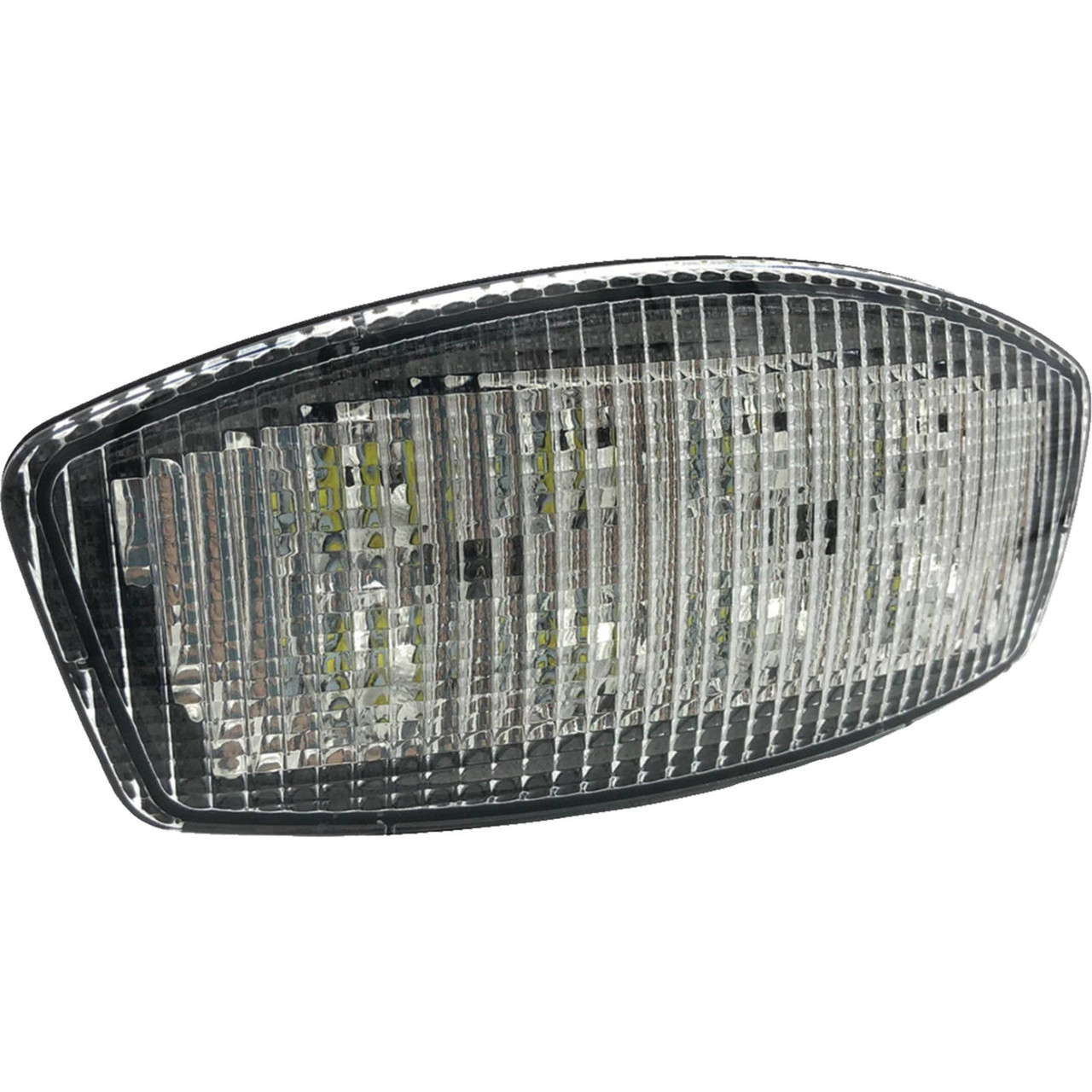

I've worked with and sold LED lighting in an other field and here are a couple of things to keep in mind
Regarding GRS's why are they dead when you go to use them- often there is or can be a parasitic drain when flashlights are off so after a long time without use, disappointment occurs.
There are good LEDs Better LEDs and Great LEDs- the better (usually more expensive to the manufacturer) they are, the more efficient and brighter they are.
As someone pointed out not all lumens are the same- of course a lumen is a lumen but measuring the output is where things get fungible. Some manufacturers just lie, some quote the raw specs from the emitter maker, some the calculated output from their boards etc. Some actually measure them, and there are standards that may or may not be applied. Likely you will never know where the light you are interested in sits. That's when word of mouth or reputation of the seller comes in.
Color temperature does play a role, too low, say 2700-3000K and the output will look somewhat dim, to high 6000+ and things get all purple and for me contrast is diminished. I tend to prefer lights in the 4-5k range for perceived color brightness and contrast.
Beam pattern is big. A tractor doesn't move fast and i'm mostly snowplowing at night so I like wide patterns with some side spill so you can see the shadows as well.
Too i look for even coverage.
I had great results with a Tigerlights bulb replacement for my 3720 halogens and would recommend. Also had good results with Tow mart round work lights front and rear on the ROPS. LEDs keep evolving so lights from 10 years ago will still work but new ones will be much much brighter- and as I age I need more light.

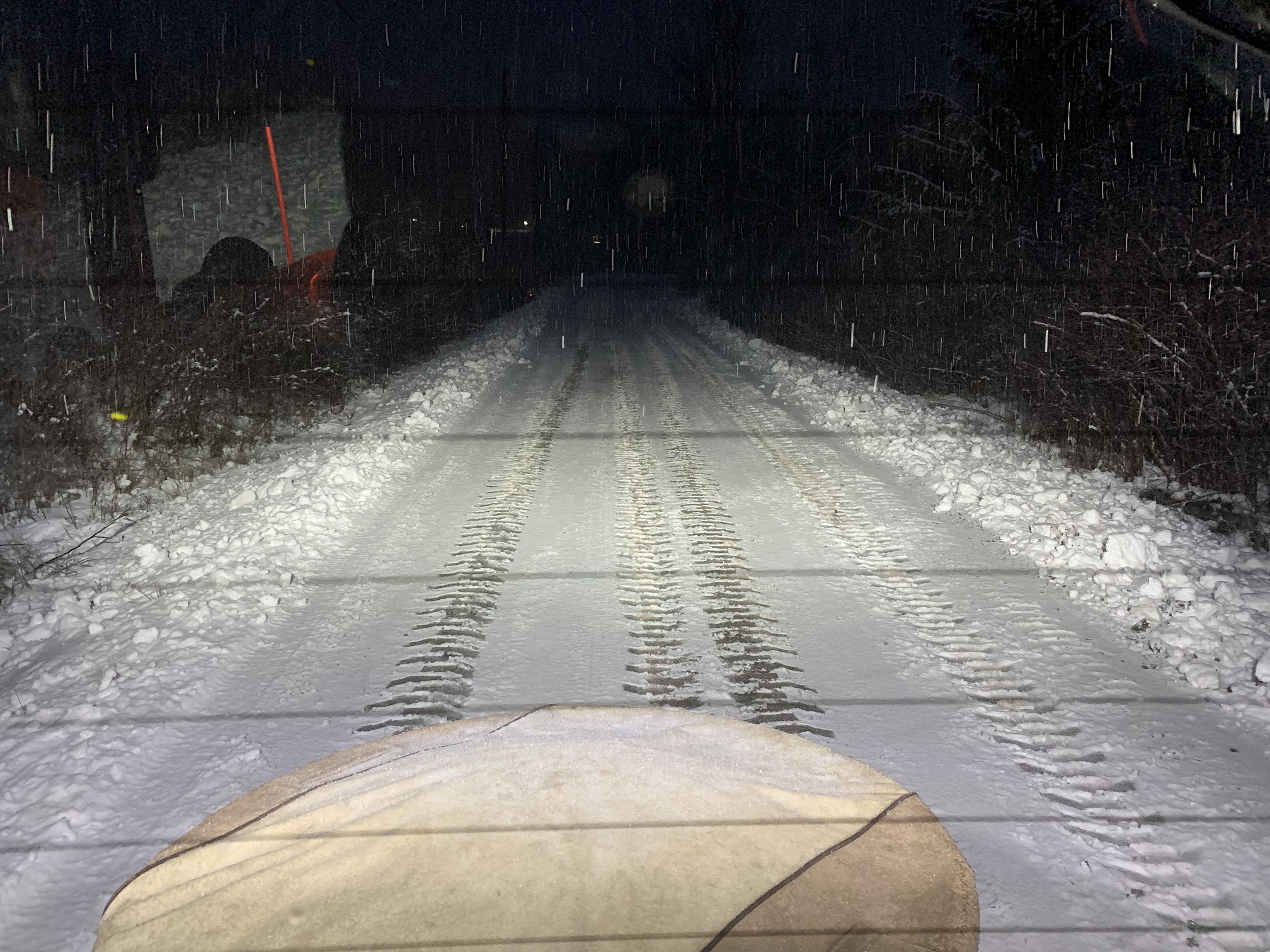

Inexpensive and a decent lighting pattern;
This is just these lights, I may tip them up just a bit more this winter. But lots of well spread lighting.
