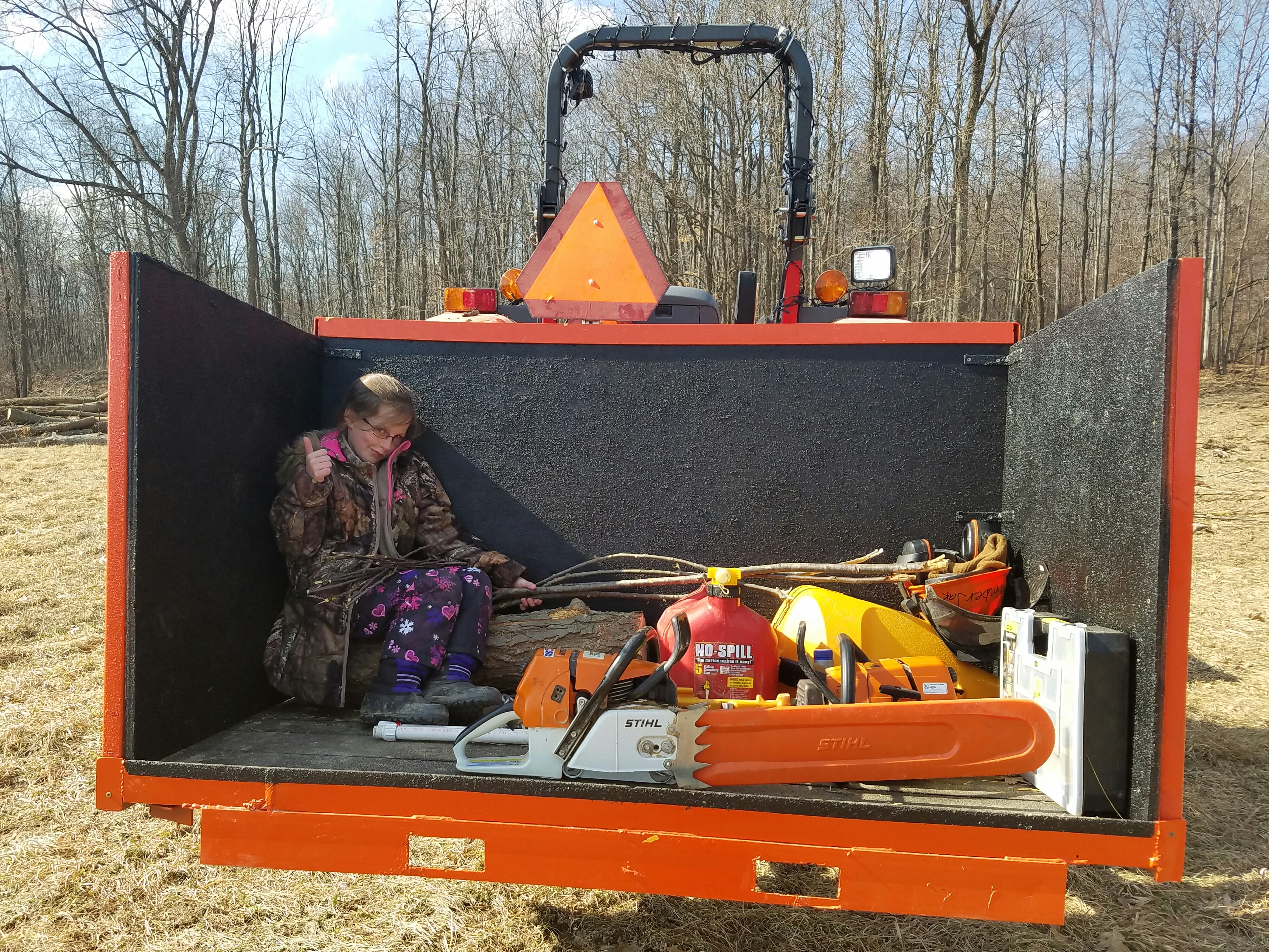

I don't know why in the heck I never had one until now! Here is a video of mine set up for firewood primarily.

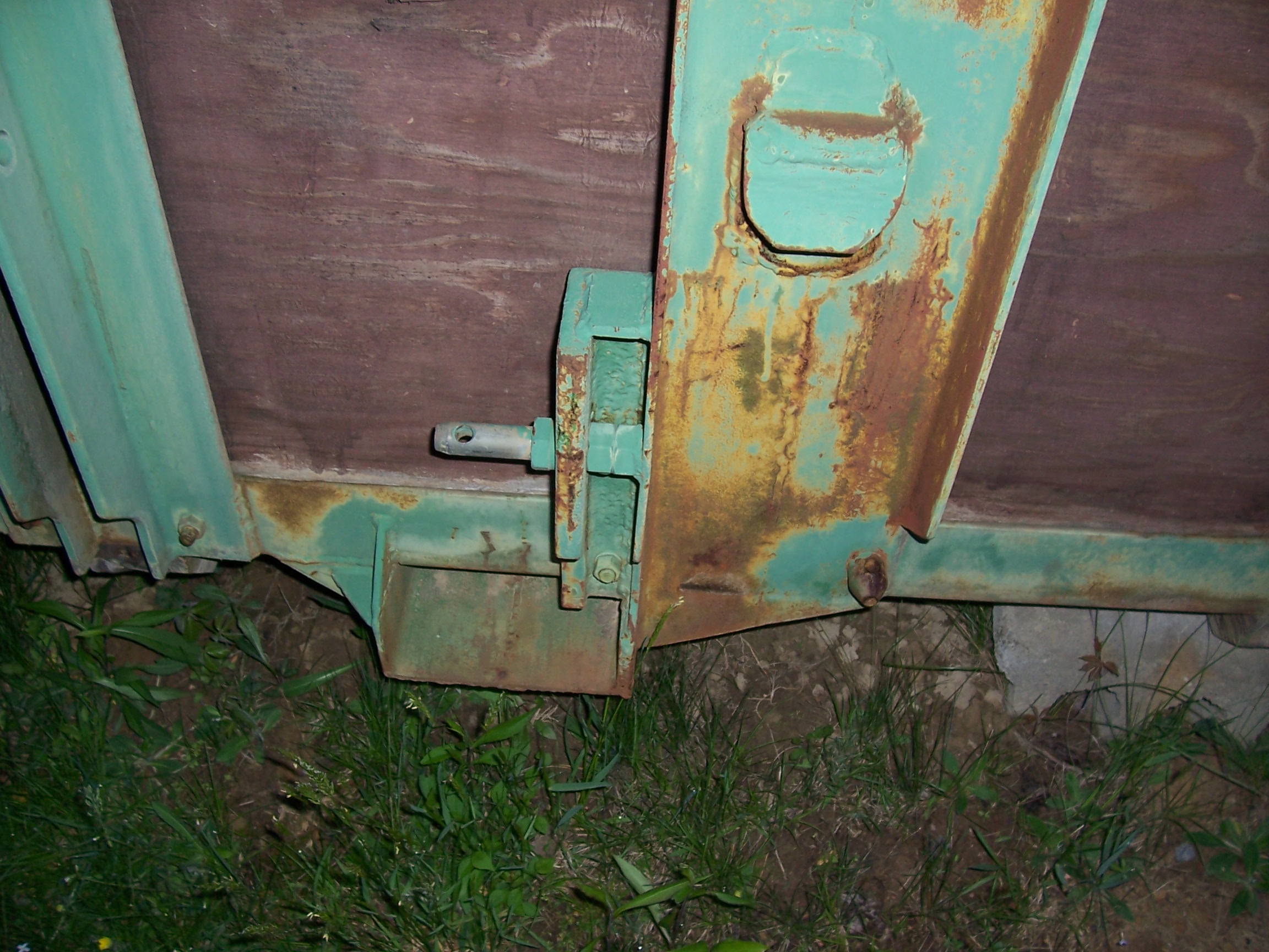

I made one about 20 years ago that I can lift 4 ways on my JD:
1. 3 pt hitch
2. FEL quick attach
3. Front forks (centered at 27") carryall 001.JPGcarryall 002.JPGcarryall 003.JPGcarryall 004.JPGcarryall 005.JPG
4. Rear forks
It is mostly scrap angle iron and still has the original plywood sides which I coated with oily preservative. Its landing runners are 3 4x4s and bottom boards are 1" decking planks, all original. Planks have top metal straps (3) with a bolt through each one into the 3 4x4s below. Its volume capacity far exceeds the JD bucket. I have used it for many things including dirt, firewood, tools like chainsaw, rototiller, weedwacker, gasoline, people, leaves for fall cleanup, branches, tree tubes, tree whips, grass seed, grain seed, etc. I put D rings at 4 points when I built it so I could lift it with a chainhoist up in the garage but never used that feature. The top D rings are useful tie down points for the walkbehind rototiller since it tends to fall over when bouncing along. When I chase dirt out of ditches with the backhoe I set it nearby and fill it with spoil, then dump it rather than using the FEL bucket on piles of dirt placed on the ground. It saves time and is very convenient for many chores.

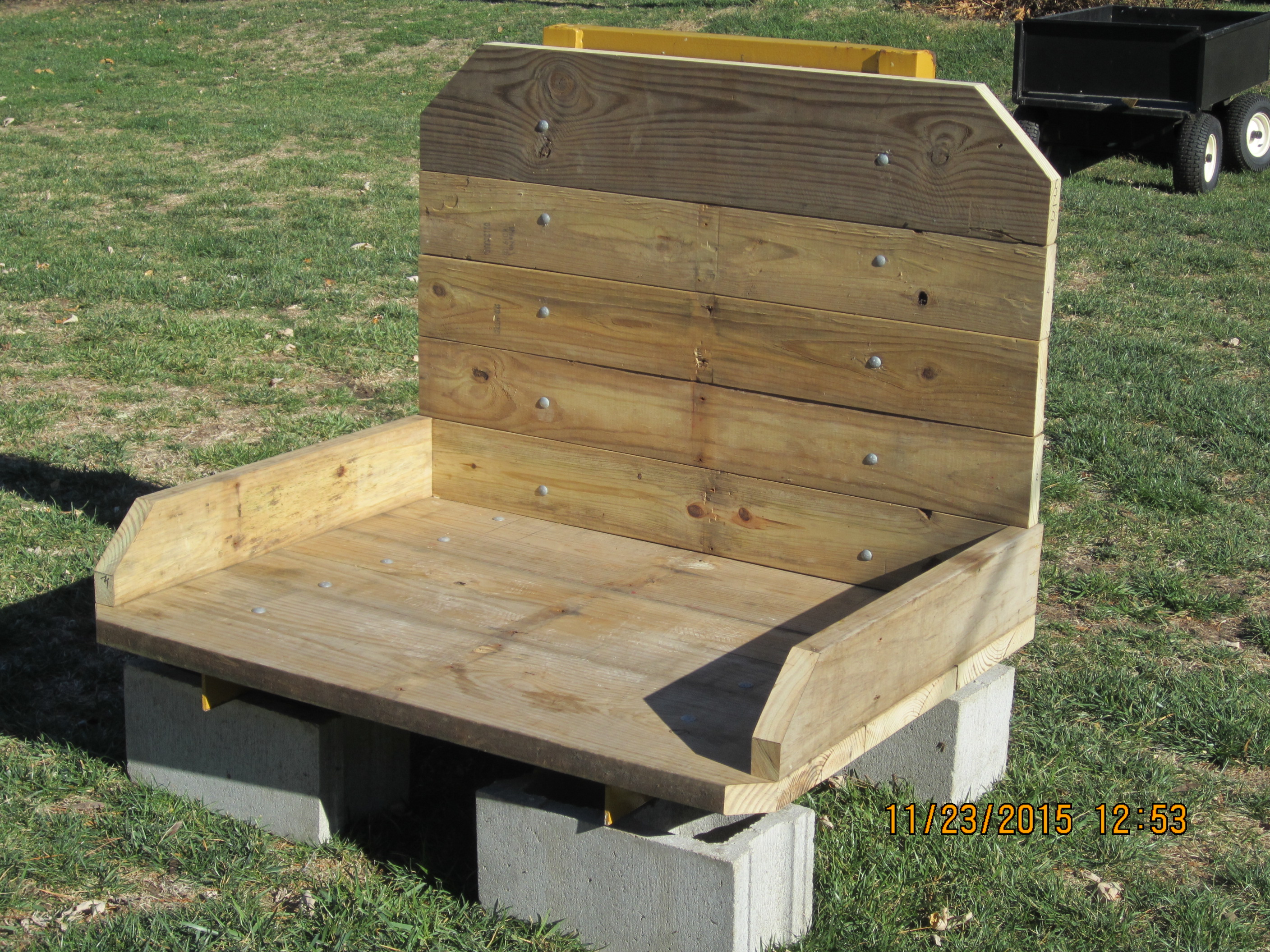

091.JPG I built this one out of scrap lumber, but so far have used it mostly for ballast. It was not that expensive but
ready for projects yet unknown.

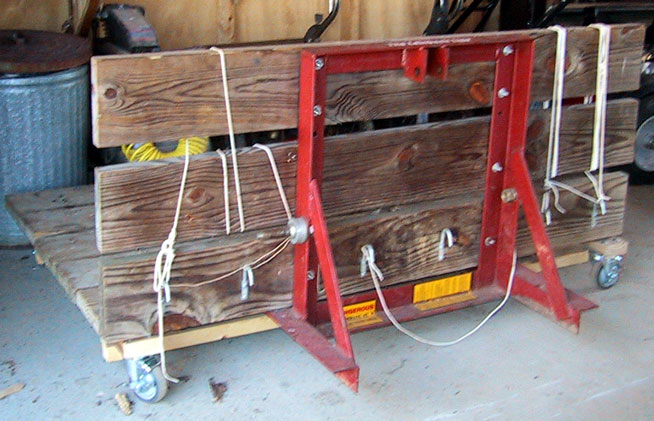

Here's mine:
The dolly under it I built so I can roll it out of the way when it's off. I have my rear wheels of my tractor set wide because of our hilly property, and so made the carryall wide accordingly. I put the firewood on it crosswise, and tie it down with the cords that are wrapped around the headboard and the hooks under the rear edge. That lets me get a good load while keeping the deck flat for other tasks.
With no side walls I can load up a lot of long brush, limbs, etc. when I haul it off to be chipped. I use the same cords to tie that down.
Here's the unit on it's dolly pushed against the wall.

That is a nice carry all you built, I really like the sides on it.
What's the frame rated to lift?

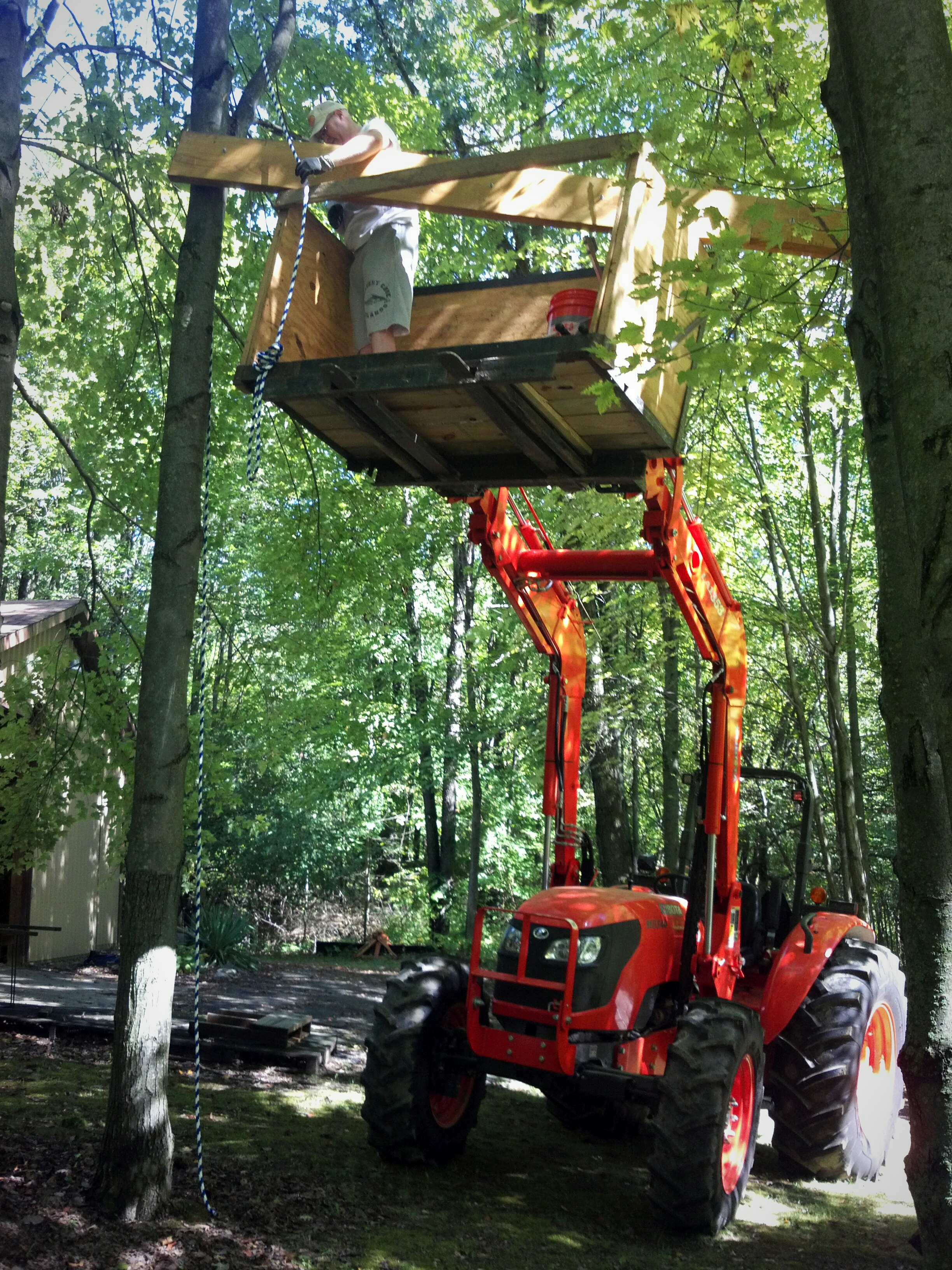

Xring,
Interesting, I could see where that would be useful, hopefully you had a smooth operator to get you in the air lmao.
