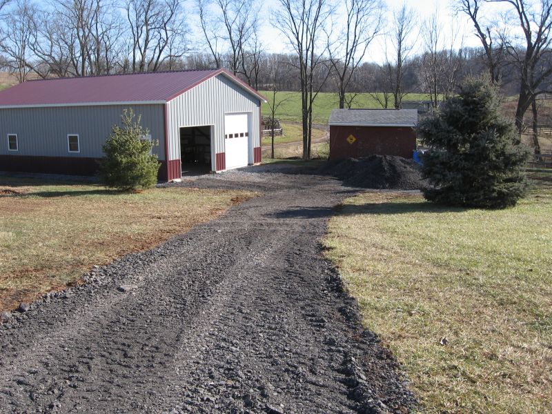

   / How much does it cost to build a pole barn?? #16
Any chance we could see a few photos of your 30x48?
Wedge
Here's one when I was building the drive to it. I put 10x10 door in back end middle, and you see the 10x10 and 10x8 door on this end. If I had a do over, I would put one door each end, probably 12or14 x 10. Another do over would be to put bubble foil on before the metal.
I have not concreted the floor yet, I need to start that soon. Maybe I'll post and ask for recommendations. I'm thinking of putting insulation under the slab and putting PEX loop in the slab just in case I might want to someday heat it....
I have more pics from construction if you want to see.

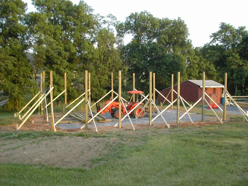

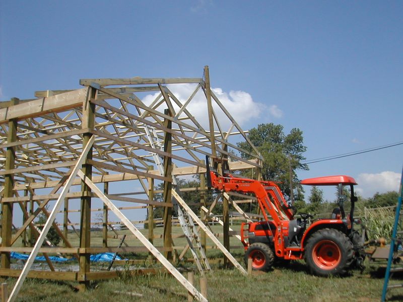

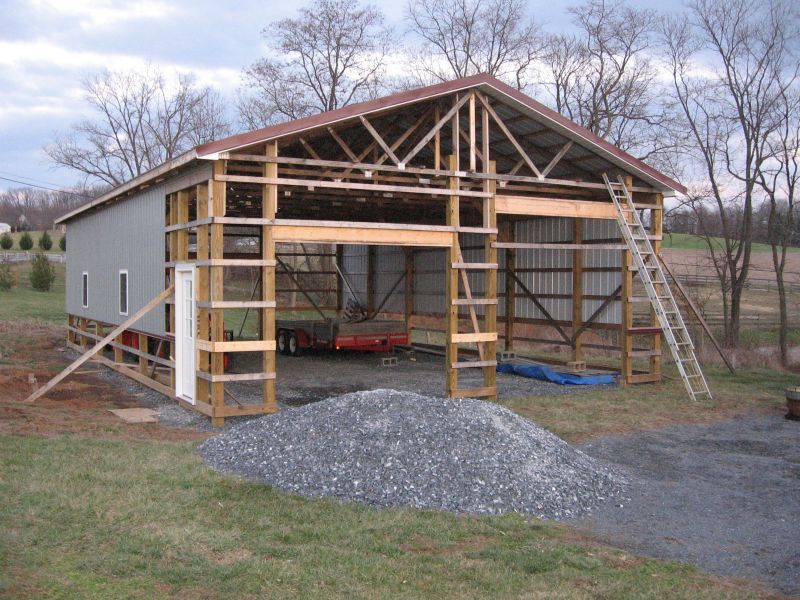

   / How much does it cost to build a pole barn?? #17
Heres some more before & during.
I designed it myself and made my own CAD drawings, but the company I bought the material from provided detailed construction drawings also.

buckeyefarmer - I am interested in the pole you have mounted on your tractor. I see some sort of a cable and pulley mounted on it to lift your trusses in place. Can you tell us more about your FEL boom lift? how did it mount to your tractor, how did well it work, etc. ;)
