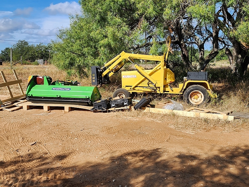

I have the BCRM-155 (61") and I can say without a doubt you will know it's back there when extended. It flattened my right rear tire until I aired it to maximum. I usually run them with just enough air to keep full contact. That was on my Ford 3910 which is about a 4600lb. tractor. The Ford's 40hp PTO was no problem at all on scrub up to 1". It baulked a little on harder Mesquite branches but ate it all when going slower. And I really like the design of the hammer flails. They're more of a duck-foot design with support ribs. Best I've seen for the style of hammers.
As Dieselscout says, tractor weight is a concern. It needs to be able to handle the ~950lb mower. That's also the reason the manual says to transport it in the folded and up-right position. When mowing you're going slow but uneven ground will rock the tractor. I only fully extend it when I need to reach out for banks and ditches. Imagine that. 🤷‍♂️ :ROFLMAO:
On a side note: Get a restrictor valve for the other line. It comes with one to slow one of the cylinders, but it needs it on both. (I forget which line it came on but get another and necessary hose.) It makes control a whole lot easier when you're mowing.
This is the only picture I have at the moment. I had to partially assemble it in the driveway to get back to the barn with the Ford. The little Kenbota was there to lift/hold the swing arm in place while I installed the bolts.
