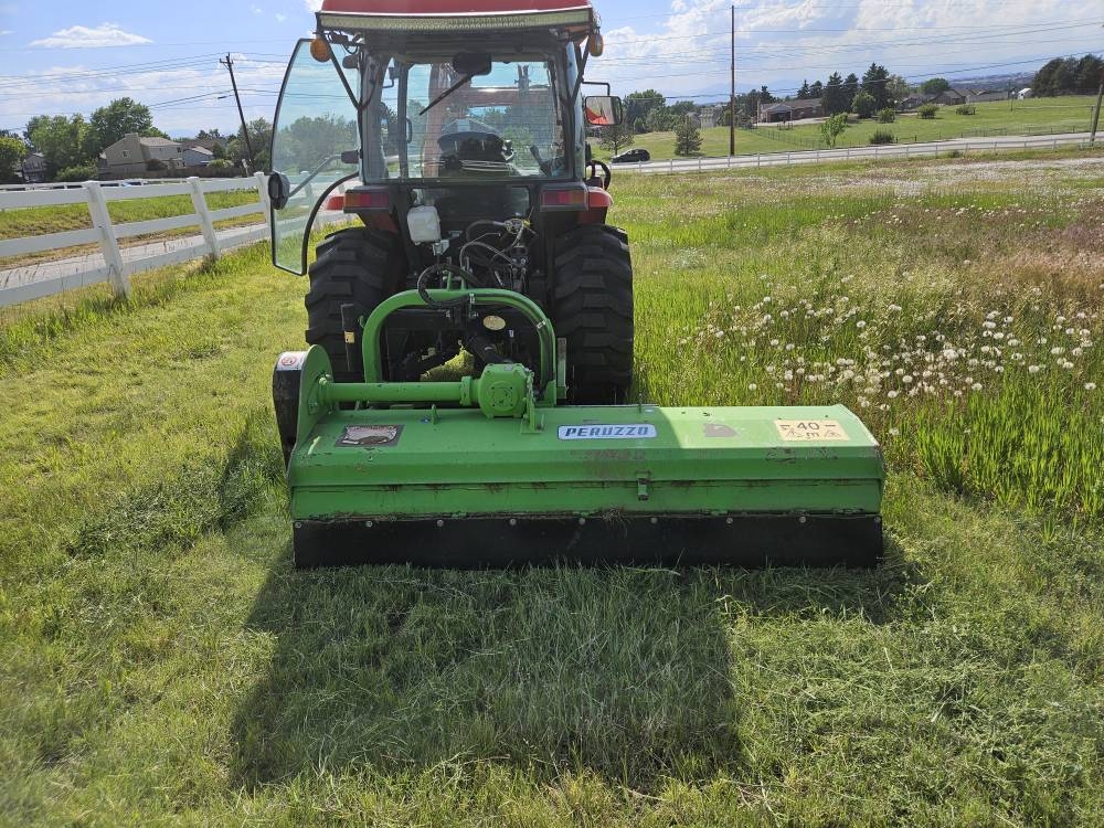

My l4060 (40hp) lifts & spins my Peruzzo Brush Bull 2200 (7.2', 1,500lbs) ok. It's a bit heavy for my machine, but works pretty well. 1,200 hours on the tractor, probably more than half are mowing. I wish I had the 20 extra HP of a L6060, but not enough to upgrade the tractor or get a smaller flail.
I'd probably recommend a 2000mm or 1,200lbs flail to somebody with my machine.
