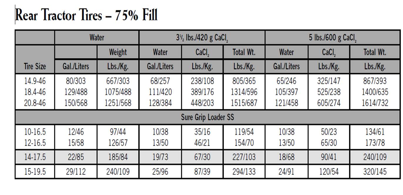

I'm confused on the tire sizes on the table. I don't see Surgeon's tire size on that table either. I looked up the tire size for the industrial tires on a CK35 I'm looking at getting which is a 15-19.5 according to the Kioti website. I don't see that one either. So how do you find your tire size on the table?
   / How much fluid for tire ballast #8
Here's some of the Titan tire recommendations. the 15-19.5 is listed
