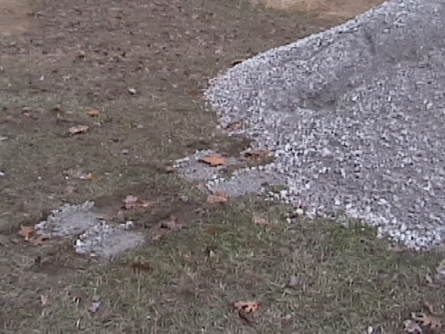

Here are some pictures of the limestone. This first one shows the small ruts that the truck left. Hard to believe it was stuck when it didn't sink any more than this!

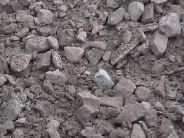

Zoomed in shot of the limestone.

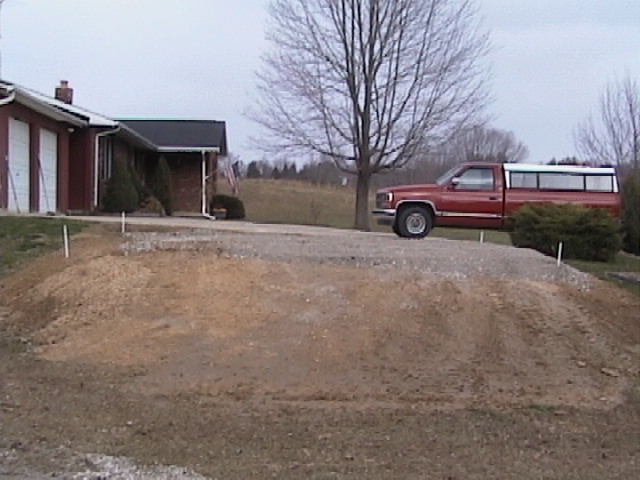

This last picture is depressing. It didn't go as far as I thought and I'm still 6" low on the right hand side (according to my line level). It's hard to tell by looking at it because the concrete slab (that the pickup is parked on) has quite a bit of slope and drops about 1' in 20'. I needed twice as much as I thought. Now I don't know what to do! I guess I just need to admit I don't have a clue about what I'm doing.
   / How much gravel under concrete? #20
Danny, what did you tell the stone supplier you needed? I've been successful telling them what I wanted the stone for as well as the area and depth I needed. Then they compute the yards and tons. Also, why didn't they back up the driveway to dump the stone?
