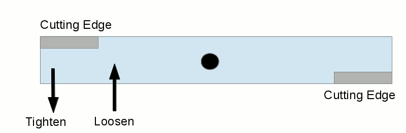

couldn't break the bolts that hold blades on with a 3/4" breaker bar,socket slipped.
What do you mean the socket slipped? Have you already rounded the corners on the bolt? Are you using a good quality 6 pt socket? Whatever is tightest fitting, standard, or metric? I've driven sockets onto badly rusted nuts or bolts before.
Are these nuts or bolts?
Wouldn't heating a bolt to red hot, then spinning it off... only spin half of it off... with very much undesired results. :confused:
Typically one turns the bolt/nut in the direction of the cut to loosen the bolts, and opposite of the direction of the cut to tighten.
