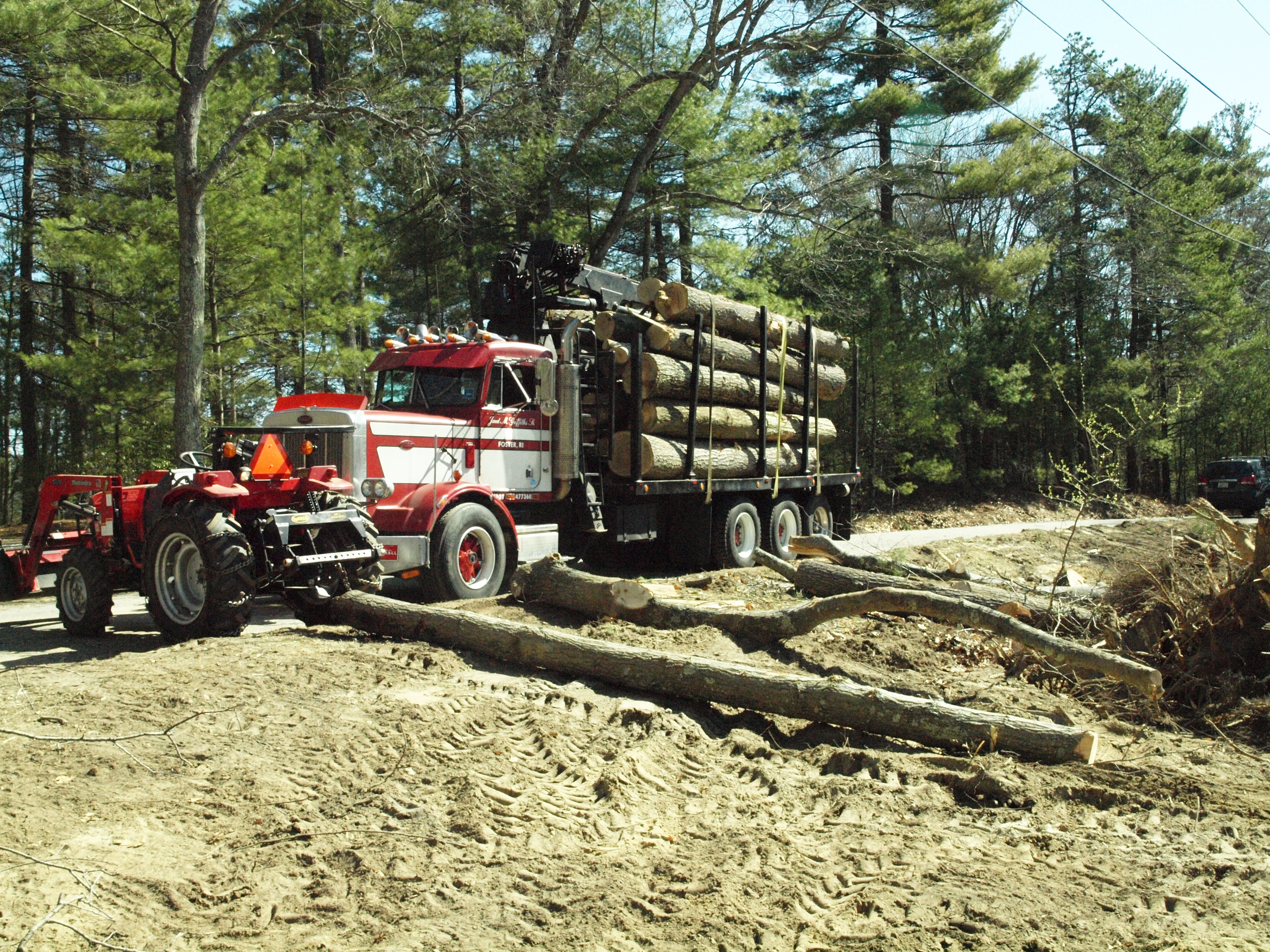

I'm fine with moving slowly as long as I'm moving. This tractor weighs 2459 lbs, Fill the tires, add wheel weights and a well fed driver should be over 3,000 Lbs. To me hypothetically if I chained the tractor to an unmovable object, on dry pavement in low range, 4WD engaged, rear axle locked when you press the HST pedal, the tires should spin. If they don't than the traction exceeds the power (Torque specifically) and more power could be useful. If the tires do spin more HP would not help at all.
To add fuel to the fire: I have this tractor only it's called the 3016. I test drove this tractor with hst and didn't like it much. Felt it too underpowered for HST with this amount of hp. (Old Pilgrim might have something to say about this as he loves his 3016 HST). I use this tractor hard and have pics all over this forum of it doing inordinate work for it's size. Plus this was about the last geared tractor the dealer had on his lot and I got it for a song.
I now sit on 5 acres of land but used to have 110 just behind the house. This tractor traveled on at least 20 acres skidding good size logs in for the chainsaw kill without so much as a hiccup. It could easily tow in a 3000# hitch of logs and then stack these stems no matter what the thickness and on the pic of the logging truck, you can see what it brought up going up a 30% incline. I agree with Island Tractor this time about the old axiom: "you never can have a tractor too big or with less hp". As a generality this may hold some water but the reality is a tractor must be relegated to what it's purpose is combined with the "wiring" or makeup of the purchaser. It takes me 12 days of 3-5 hr per day time slots to gather just about six cords of wood from standing tree to split and stacked on a yearly basis. I probably could knock off 3 days of that time with a larger tractor but 12 days is plenty fast enough for me. This tractor fits my needs and makeup to a tee.
When I'm done with wood, I would strongly consider trading this tractor in for a max 28 or whatever the designation is today for this size. To me, that would be a righteous machine with a mower, front end loader and snow blower to do just about any work I desired except fill a logging truck with those size logs. (then again I'm supposed to be done with wood at some point in favor of a nuclear powered furnace about the size of a printer).
