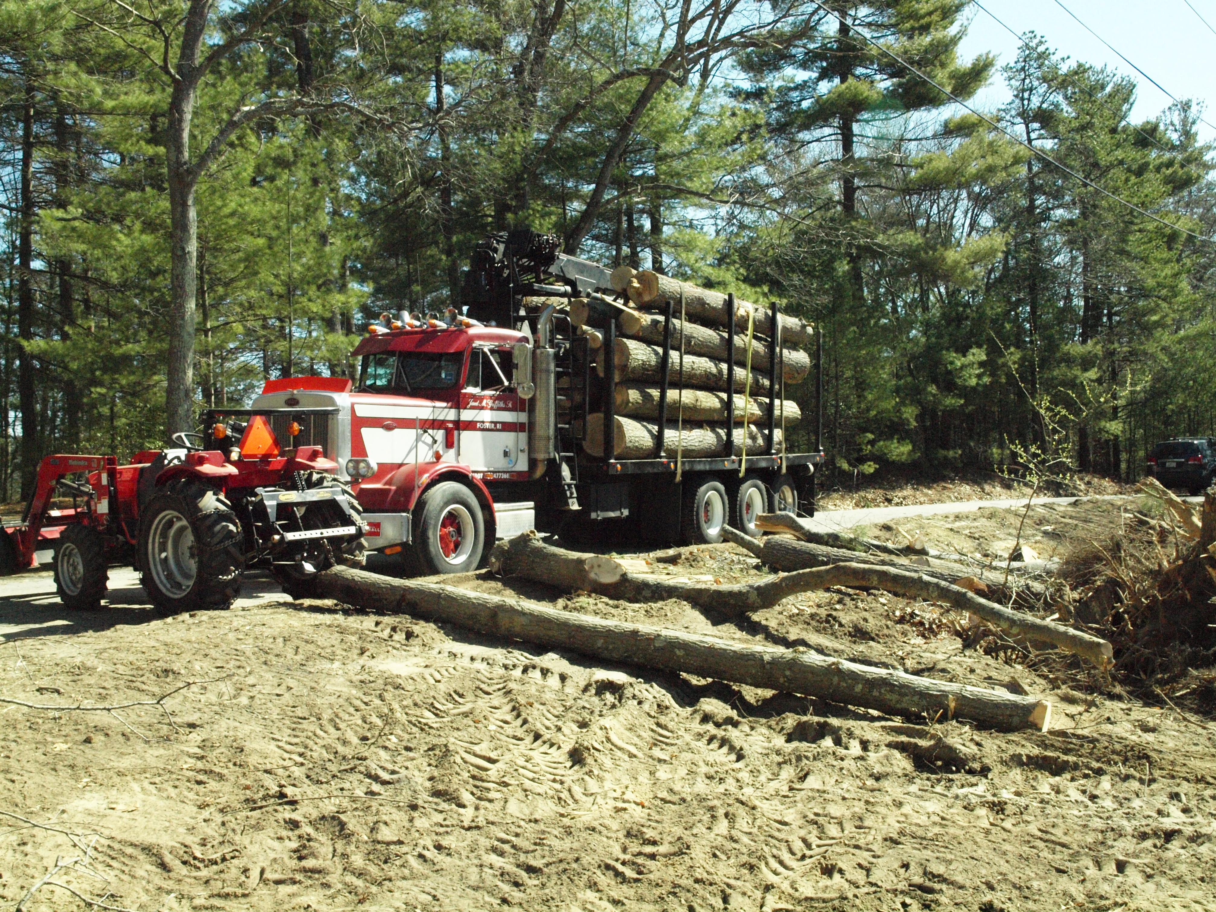

I like your little tractor. How do you like that wedge on the splitter?
   / How much HP do I really need?
#27
The wedge is the Key! It breaks the bottom slice in 5 pieces. The top slice remains on top for another hit. Because the top is flat. It doesn't fall off. I suspect my blade angles could be optimized as it kind of extrudes the wood. I made the head so it's pinned to the beam so I can try different designs, but It's worked so well I haven't made others. I have just 2 splitting heads the one in the video and a single wedge which I never use. The single wedge is also reversible and doubles as a press.
   / How much HP do I really need? #28
Your wedge puts the 4 way to shame. Love to see a close-up of it.

Thanks! Its an awesome splitter, but only 2WD with an open diff which means it's really 1WD. It's not an ideal tractor. I do have pallet forks for it. I'll probably not buy a backhoe for the new tractor, I'll just use this machine for back hoe work.

I just love cobbled up stuff. I used to have an old Jeep frame that I put 33" tires on that acted like a log skidder. It had lockers both front and back so it didn't stop for much. They can be very handy.
Now the advice I'd give if you wanted a Mahindra is to look for a slightly used 3016. You'd probably save around $8000 over a new one if so many think the resale is so low if it's not a Kubota or JD. I'd take advantage of this and come away with a great machine for not too much money.
Anyway, can you showcase your 6 point splitter blade with some pics? I thought that very efficient as well.

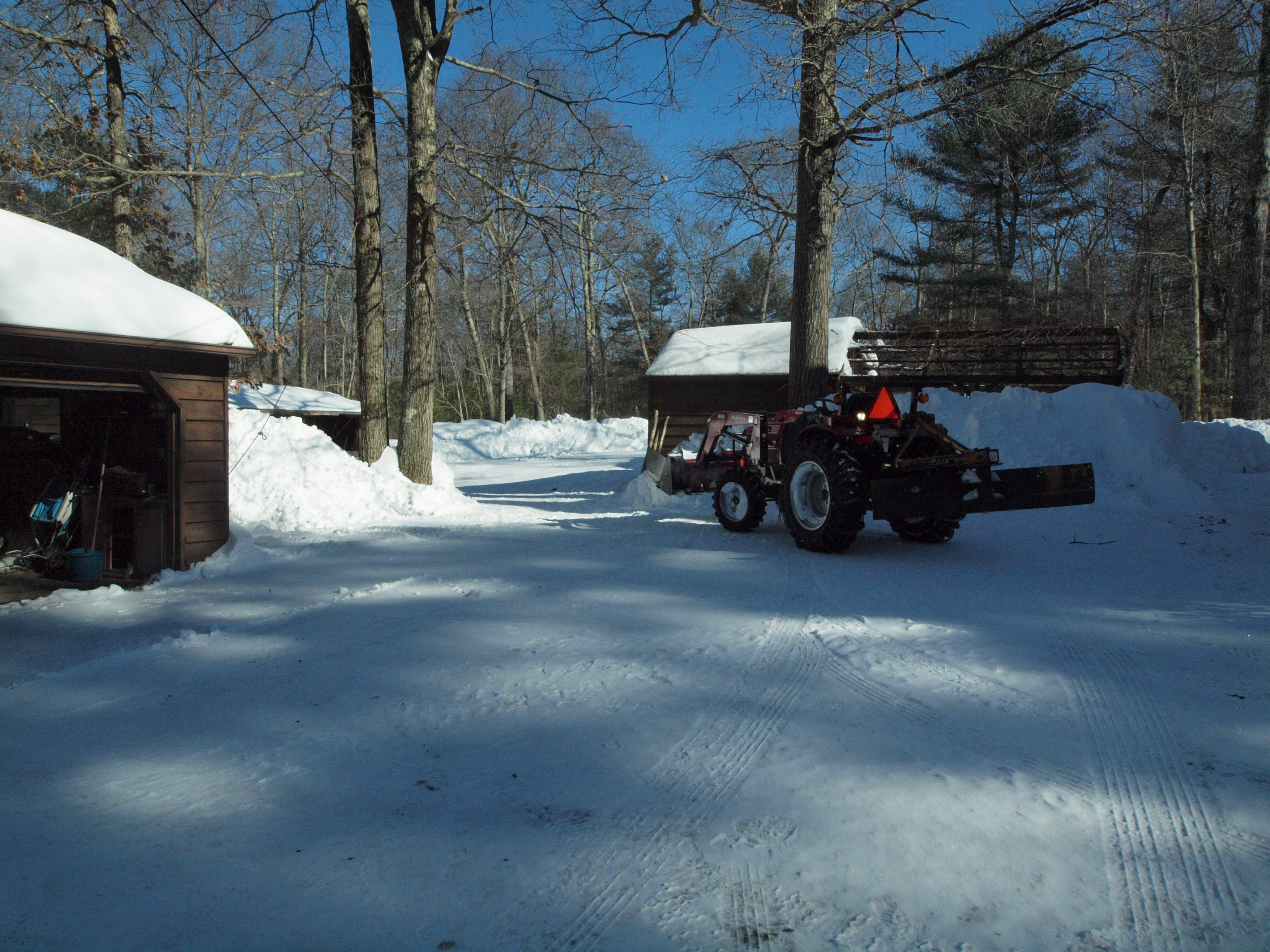

Thirty four years ago I started my saga, out here, with a 26hp Ford 1700 4WD. It was the perfect size for snow removal on my mile long gravel driveway and all other, smaller, chores around my 80 acres. Seven years ago - most all the smaller chores were completed except snow removal on the driveway - and I then knew I needed more weight and horsepower. I wish I could have obtained the same frame size with a 60hp engine and added weight - but that was/is not the case. So I moved up to my current Kubota M6040 and can now easily complete the "larger/heavier" chores.
However - there are now those few times I wish I had the smaller tractor. The larger tractor, some times, requires that objects be moved so I can get to the work.
It appears that there will never quite be a perfect solution to all situations.
