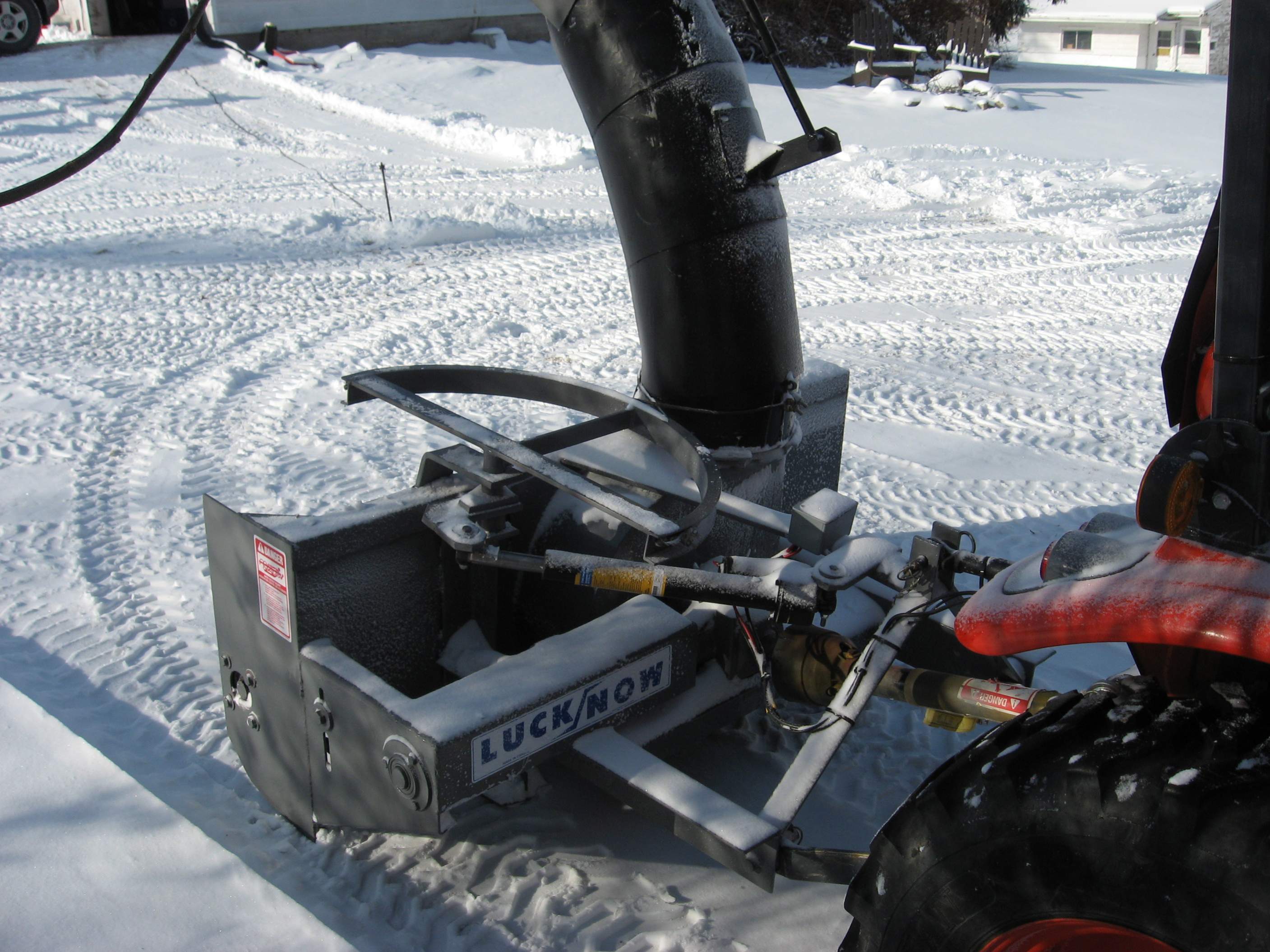

Hi Guys,
Am new to this, so be please be patient:confused:...just bought a Kioti Ck20s HST TL and am looking at putting a snowblower attachment. The rear PTO output according to manuf specs is 16.2 HP... I am looking at a good deal for a slightly used 60 inch 2 stage ...but am unsure if it is too big for my rig..ie not enough HP ...any thoughts?
Thanks
The 60 inch Buhler/Farmking that we sell requires 20-60 HP and weighs 470 lbs according to the spec sheet. I would think a 50 inch may be a better match. Ken Sweet
   / How much HP rear PTO needed for a 60 inch snowblower #17
I have a 60" JRW rear mount snowblower on my 2006 Kioti CK20HST and it runs it with no problems. I usually run it in high gear too until I get to my steep driveway. The heavy wet snow only gets thrown about 20ft vs 30-40ft when moving the light fluffy stuff but 60" is definitely a good size for the CK20. Any smaller and it might not cover the width of the tires. In the real heavy stuff I make one pass then go about 1/2-3/4 of the width so I can still throw across the driveway. :D
Click thumbnails for larger images:
   / How much HP rear PTO needed for a 60 inch snowblower #18
I agree with the above poster....you'll have no problems with a 60". I have a CK20 hst with a Lucknow 60`and i wouldn`t go any smaller. Lucknow blowers are built extremely heavy and the CK20 handles it nicely with the fel mounted and i take full cuts sometimes in high depending on the snow. If you have found a deal then go for it.
