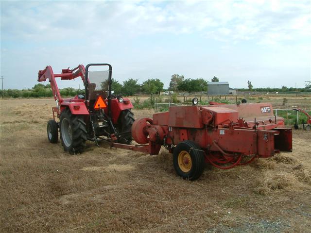

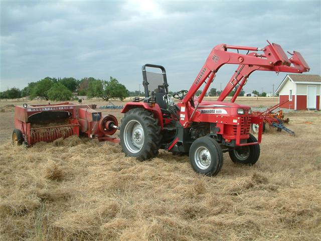

I need to buy a tractor for a 50 acre farm that i recently bough in central america and i'm not sure how much horse power i need. The land is level and i need a tractor for collecting hay and perhaps some tillage. I was looking at a 55HP tractor but it was not 4wd and Im not sure if it need to be 4wd.
I use a 54 hp (engine) Mahindra 5525 (2WD, 8F/2R gear tranny, power steering, 45 hp pto) and a Massey Ferguson 124 square baler on my 10 acres of flat pasture.
MF recommends 35hp (min) for the 124 baler.
/ how much HP #11
flusher, were you testing you're baler in those pictures, or don't you rake the hay before you bale it?
/ how much HP #12
Just testing the baler. Found out that the slip clutch facings are too worn and need to be replaced. The baler is in the shed now. I'll start getting it tuned up for the May harvest (Kanota oat hay) in a few months when the weather is warmer.
