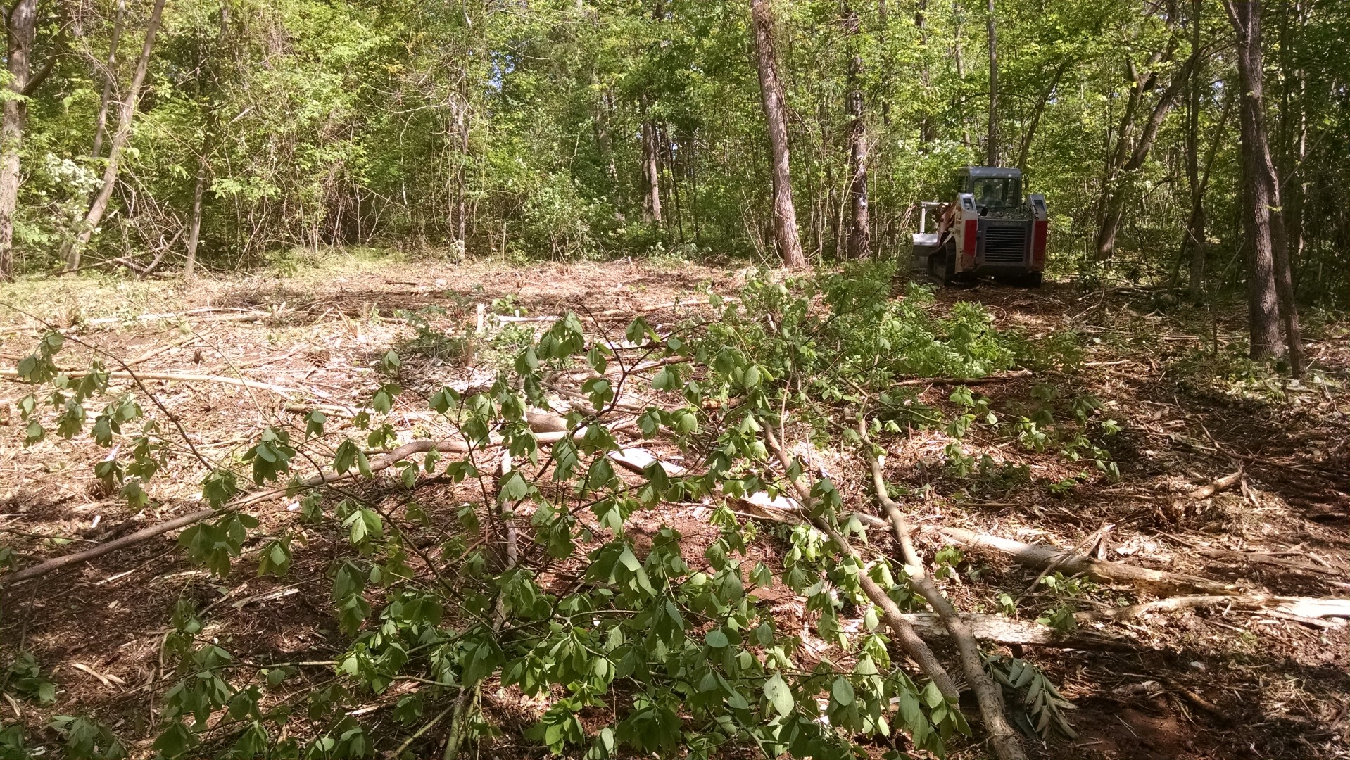

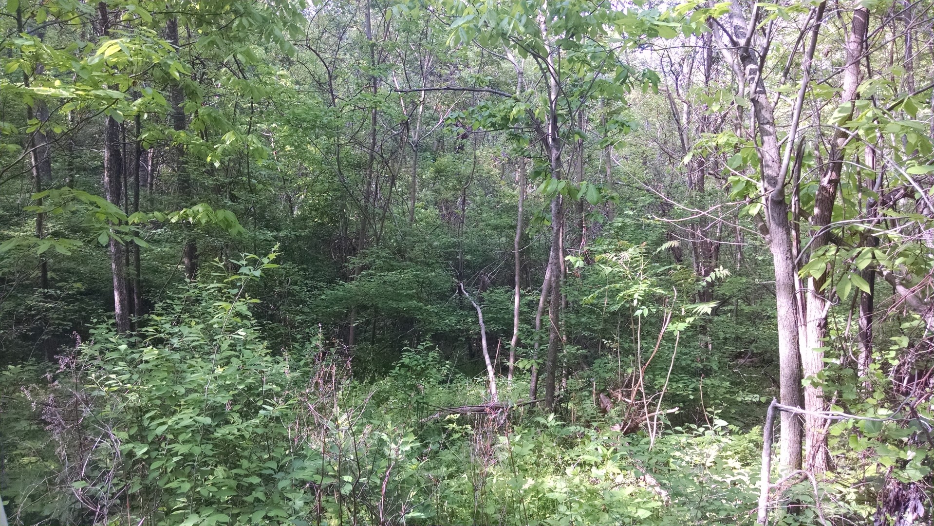

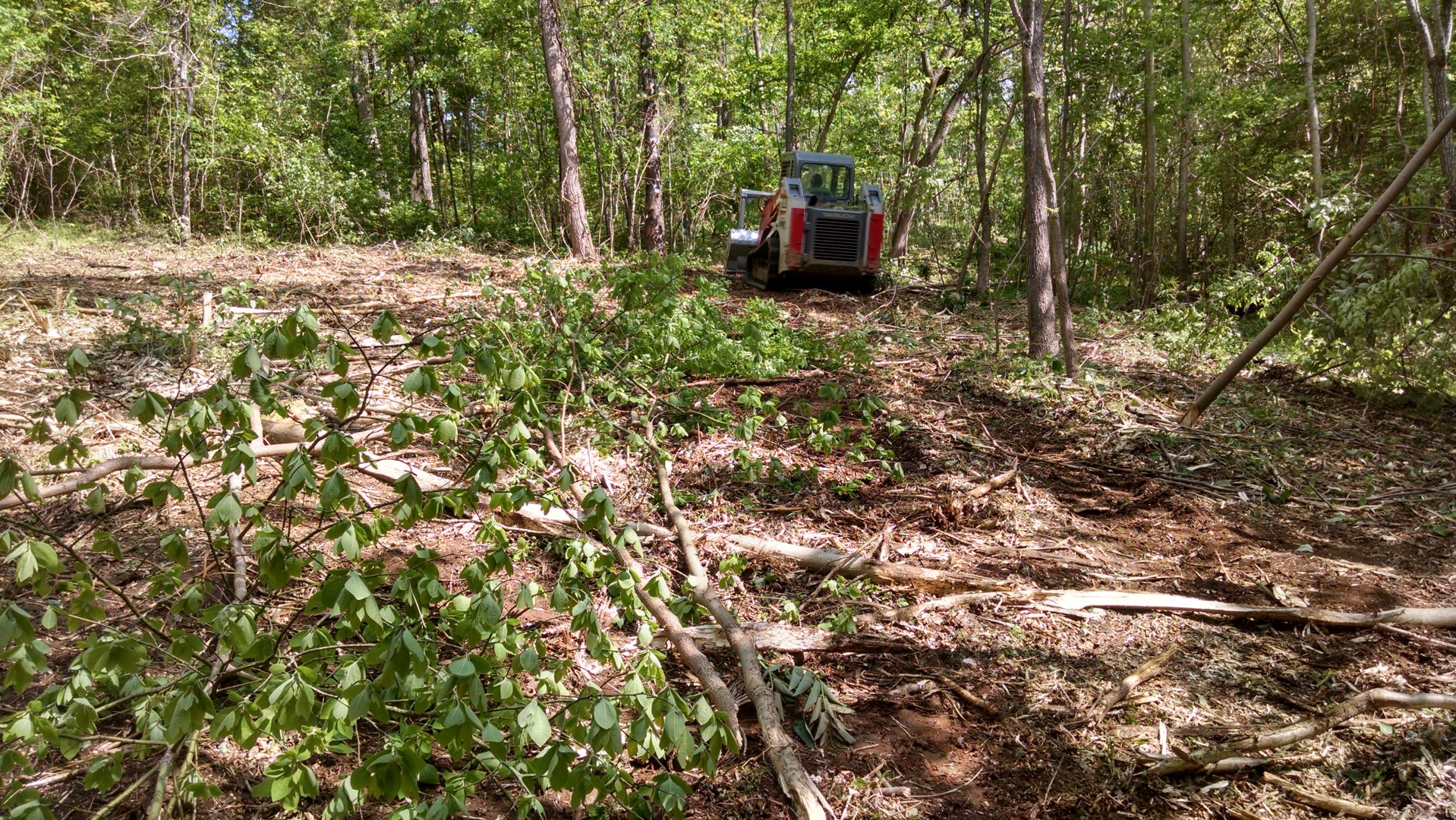

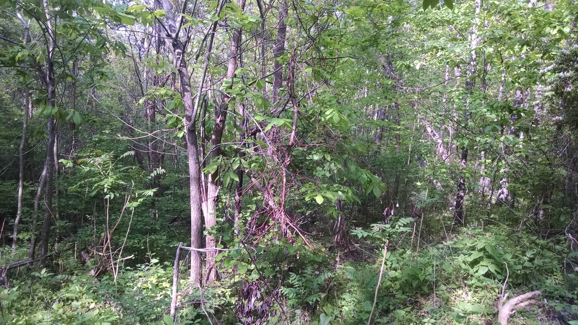

Sorry if I didn't answer this before. I'm in SC TN, about 10 miles north of the border and 10 miles east of I-65 (i.e about 45 miles NW of Huntsville AL).
So followup since I last posted here on this thread: I had a land clearing guy come out a couple weeks ago that had one of those mulching head skid steers. He was supposed to work for one whole day but only did 4 hours worth of work (debatable by one other land clearer) but was sidetracked by equipment issues, losing a track, having to change out the head and a recalcitrant FF connector that wouldn't let go.
In any event, some before and after pics:
IMG_20170421_085355512 (Large).jpgIMG_20170421_085358210 (Large).jpgIMG_20170421_101548363_HDR (Large).jpgIMG_20170421_101552207 (Large).jpg
Overall, I'm not too happy about the job but for reasons that not under the control of the bulching head operator/owner:
- The land cleared was left with some 4-6" high stubs (pungi stakes) from the smaller trees; I learned today from another operator that that is normal unless the operator is running carbide teeth due to all the rocks in the soil. Fair enough, don't want people ruining their equipment.
- The "road" (trail) I wanted built is way too steep in terms of sideways lean. Very uncomfortable driving over it, which by the by, misses the entire point of one of my most important objectives for this cleared land: a new better access road/trail to this part of my property. Again, not the fault of the mulcher.
So I had another land clearing mulching head operator out today to give me another estimate. After reviewing the property and my goals for it, what he recommended was getting a bulldozer service or renting a bulldozer rather than a mulching operation. He said, for my road, I'm going to need a bulldozer anyway since a mulcher won't move dirt (duh!). Plus, the dozer would take out all the pungi stake stubs and even stumps.
So now I'm investigating renting a bulldozer for a week and doing it myself. From on line searches it appears that I can locally rent a Case 400 series (70 hp class) for about $1600/week vs. $1200/day for the mulcher service. This would not include diesel, of course, so I don't know how much a dozer uses in a day.
So new question: Has anyone here rented a dozer before, what was your experience like and what are some good tips and tricks I should know about beforehand?
Any other comments and suggestions are welcome as well.
Thanks!
   / How much land could this thing clear in a day? #40
Thanks for the update. Your new plan might make sense. You can do a lot of damage with a dozer. By that, I mean you can either really muck things up, or really get a lot done. It depends on how proficient you are with a dozer. I've only played with them a bit,and it's tricky to know what's happening in front of the blade because it's not visible to you.
If you put me on that rented dozer, I would likely dig up a bunch of stuff, but I'm not sure how smooth it would be and heaven knows where the organic material would be. Last fall, I had to have some road work done, an they came with a new 100 hp dozer. I was worried about the cost, but it is amazing what a skilled operator can do with high capability equipment. It was a hydro with refined hydraulics, and a skilled operator that made every move count. I think he knew where that blade was within 1/2".
My point is that you might get as much done in one day with a great operator and a new dozer as I could do in a week with a rented dozer. That plan doesn't work if you get Bubba with a 10 year old dozer.
That said, I am excited for the property taming you are doing, and appreciate your updates.
