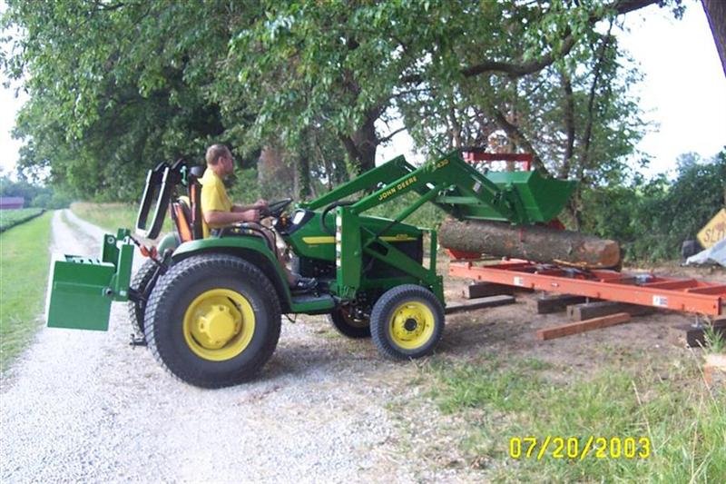

I've got a 4310 eHydro mfwd with a 430 FEL. I regularly
lift logs in the 18-20 inch diameter range that are 10' 6"
long. My sawmill can only cut 11' long logs. I have
the JD ballast box filled with sand, plus 6 weights in the ballast
box of 70 pounds each. I have three 60 pound weights on
each rear wheel. I am very pleased with what I can do with
this setup. I think it would have trouble with logs in the 30" - 36"
diameter range so those would probably need to be 4 - 5 feet
long to handle safely.
