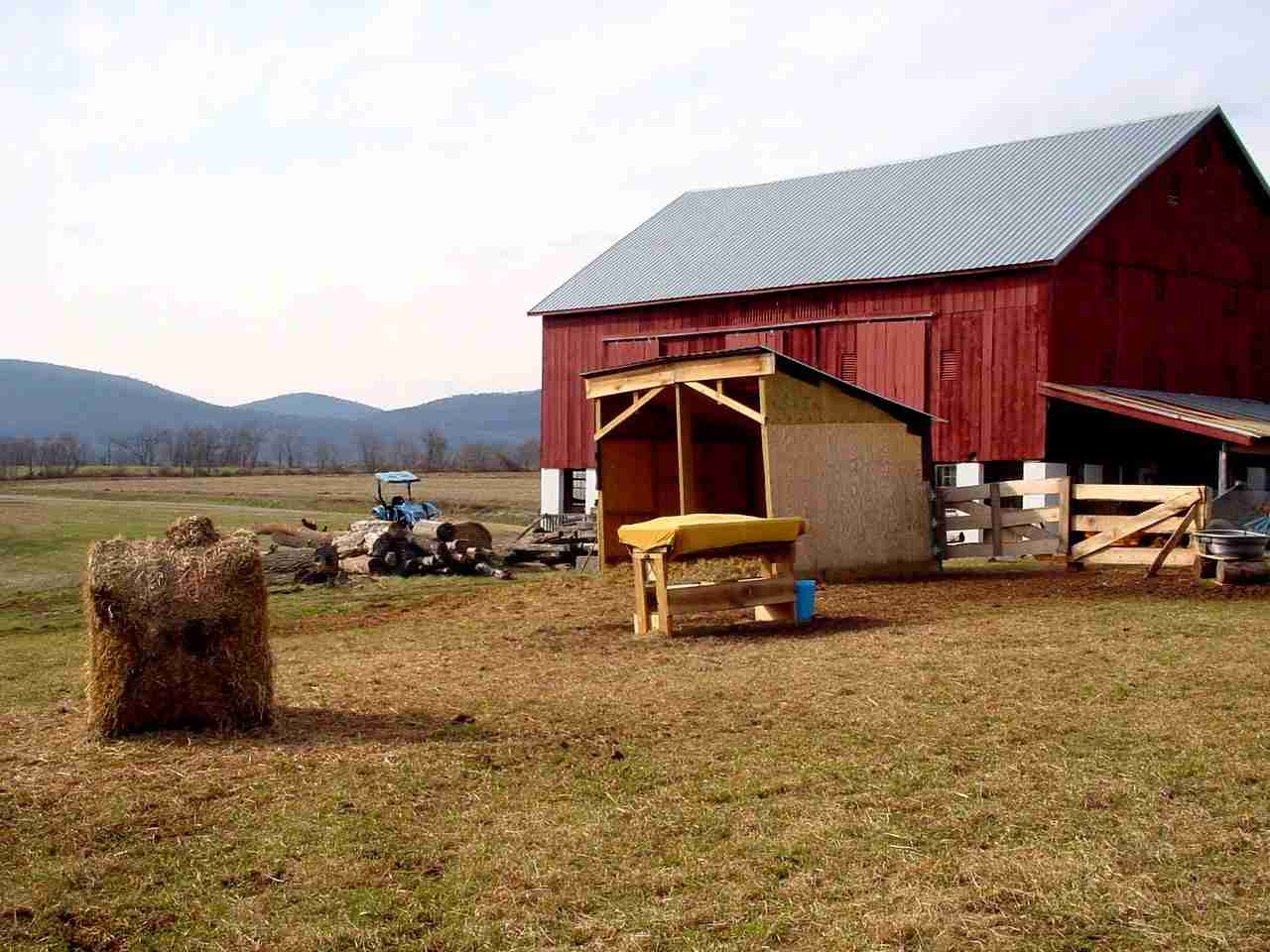

It's amazing what a cut w/ 4WD can pull.. attached is a picture of my latest projects.. raising Holstein steers.. you can just see my tractor in front of piles of logs that I've hauled across the farm w/ just logging chains. The cow shelter is 16x12.. full floor.. built on skids.. tin roof.. my 35D pulls this building from field to field.. the FEL can even pick one side off the ground when I'm adjusting the position. I still want a bigger tractor! /forums/images/graemlins/grin.gif

I like your shelter on skid idea. I'm thinking of building something like that to haul felled trees around my larger lot. I haven't designed it yet, but I think something based on large landscape timber as skids should allow me to load and pull some decent loads around my lot. I've got old gravel roads that will allow me to drag things to our "pit" area.
Has anyone out there built something similar?
