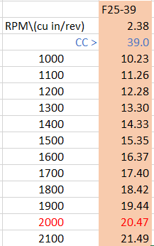

Here is what I calculated for the pump flow (gpm) vs RPM on the PTO with 2000 being the design speed of the PTO. 2100 rpm is with the engine wide open, so it is unlikely to run in that zone much (I hope...). Sweeper people say it will need something in the 12-25 gpm range

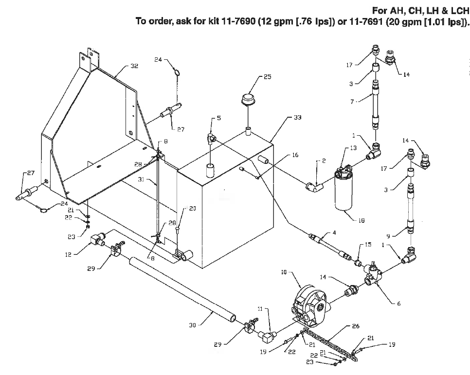

- Prime mover intended for the broom is varied. It could be set up on a skid steer but the manual shows several different configurations possible and this one was orignially set up on a 3pt hitch for a tractor. They also offer a hydraulic pump pack for the rear PTO of a tractor which then requires mounting the broom on the front and running lines the length of the tractor. Some details observed from that are that there is no radiator or fan. They do not say what the volume is, but if I had to guess from the parts diagram, I'd say around 20 Gal. Here is the manual diagram of that:
And, no, I am not buying their kit for this as I need the rear blade on the back. That was the reason I went through the trouble to set up the mid PTO drive. If I went with one tank ~15 gal and later needed to add a cooler, that could be feasible. It might also be possible to add a second tank. I'll show a few CAD images in a next post.

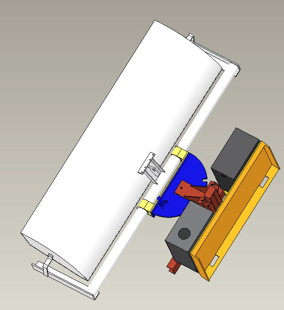

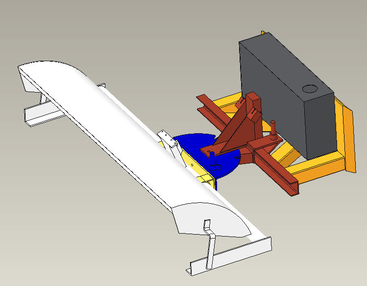

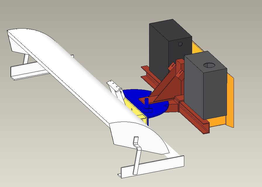

These screen shots are of a single tank, 36x18x9" which equates to about 25.2 gal total volume

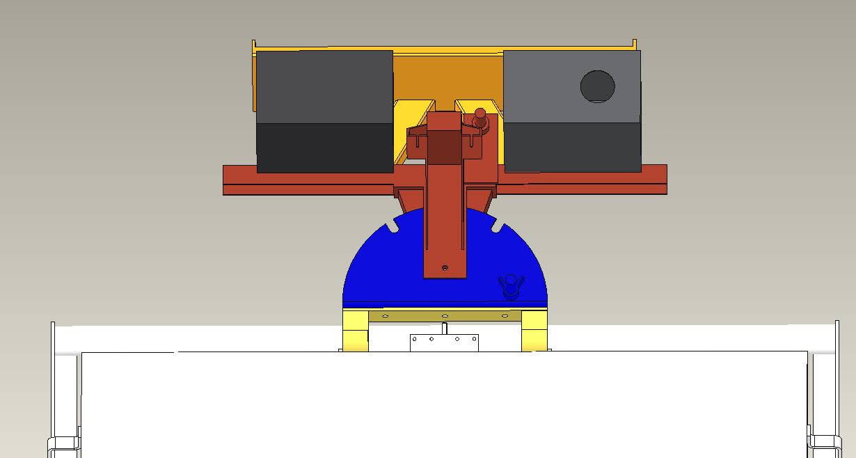

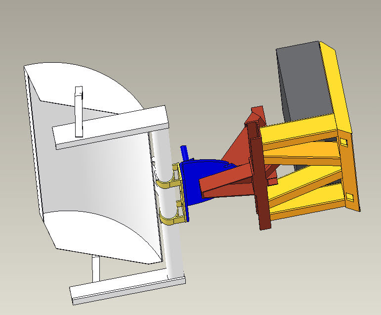

Alternatively I made a design with the tank split into 2 chunks to allow me to bring the SSQA plate much closer to the broom frame. These 2 were each 16x18x9" which combined comes to about 22.4 gal total volume
I can also do only one of those smaller tanks, but upsize it slightly to about 20x18x10 which gets me 15.6 gal. This would leave the opposite side clear to add a radiator later if needed....or theoretically another smaller tank to get up to 25+ gal. No photos of that, just delete the tank in the foreground of the last shot (left when facing forward) in your head.
I REALLY like the split tank or one smaller one as it greatly reduces the cantilever of the mount, plus allows me good access to connect the top of that red/brown post to the SSQA plate (this extra brace is not shown here) for extra structural beef.

Can you ask the manufacture what size tank it is they used in the 3ph option? And whether they used the same size tank for both 12gmp and 12gpm options?

I finally got a chance to call them and they said 12 gpm is about what it took to run it. he said the reservoir was about 13 gal or so back when it was built. He said no cooler or anything at that set up. So I'm thinking my setup will be OK and will leave the option to add a passive cooler (no fan) later on if it is an issue.

Well I have squeezed a bit more volume into the single tank design (on one side only) as a little extra cushion and have plenty of room to mount a cooler on the other side if it turns out to be necessary. The only way to find out the rest of those variables is going to be to finish the build and try it out.
I think odds are good it will work given the history from the manufacturer, and to your point, LD1, of them not making many, I'm pretty sure Sweepster is the biggest maker of these brooms out there. They still show similar setups with PTO pump packs for current models, so I have to assume they have it worked out over the past 40 yrs or however long they have been doing this.
Time to start getting some steel and bending up & welding a tank...
