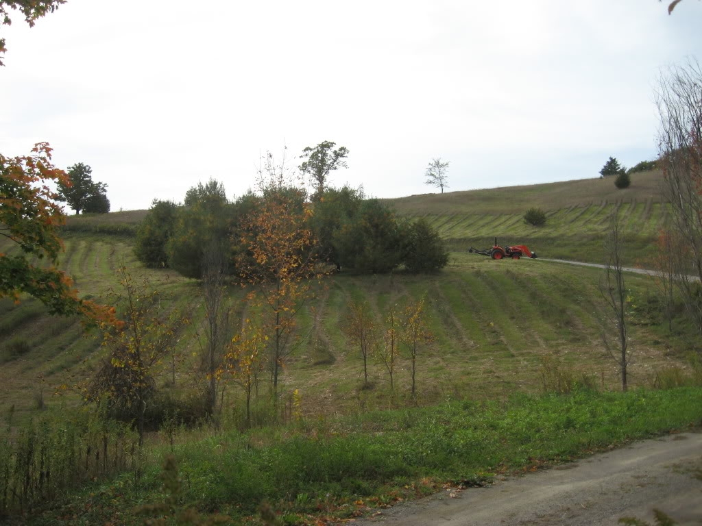

On really steep stuff, I've kept my loader on, and just kept the back end pointing down the hill, keeping the fat end of the stability triangle where I need it. With a HST you can crabwalk across the hill at the top and back down the next row. With the loader low and a light duty ~500lb 5' mower on the back, I was more worried about watching the oil pressure light and covering the brake pedal in case the hst started sucking air and sending me rolling backwards.
The slope map says some of this is up to 25 deg, far to steep to go across safely in my tractor, as there's rocks and ground hog holes. I did this for tree planting prep, and now its all trees.
Also be aware that the open front diff with no brakes on the front wheels, this allows one tire to spin backwards as the other goes forwards, and you can have no effective front braking at all, even with ags, they can pack up a tire with mud very fast if spinning backwards. This is also true with the back axle and the HST, if you don't actually apply the brakes, one rear tire can plug up and spin backwards while the other rolls forwards, even if the drive to the rear diff is stopped. I learned this going forwards a steep but short slope out of our muddy barnyard with a good bucket of manure on the front. I was backing off the speed with the HST and then got off the forward pedal totally, and I just kept moving forwards and watching one side tires spinning backwards as I kept going! Then I hit the brakes, and the rear tires locked, but the fronts kept going... I only went 20' at like 3 mph and I remembered to drop the loader eventually, but it was very exciting, and I backed down that hill after that with no problems.
