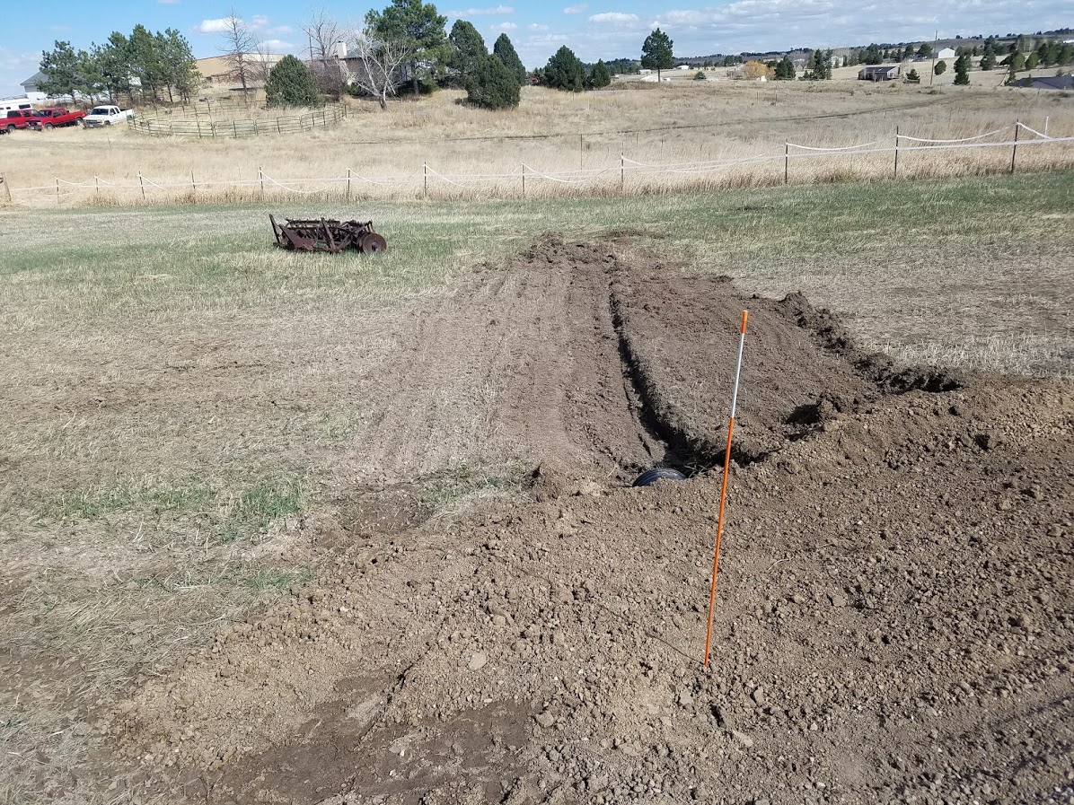

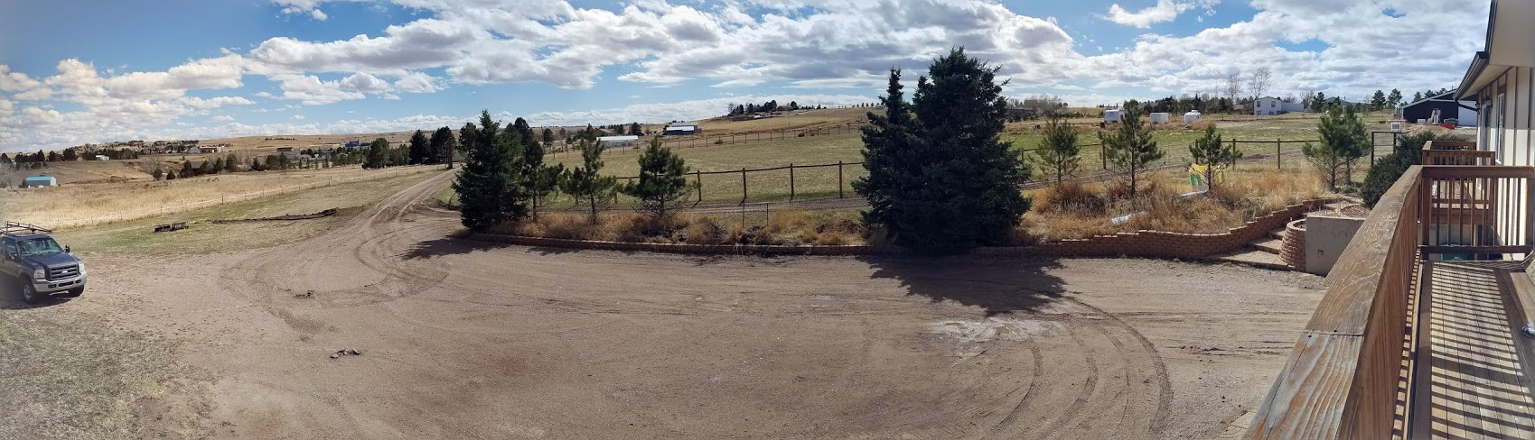

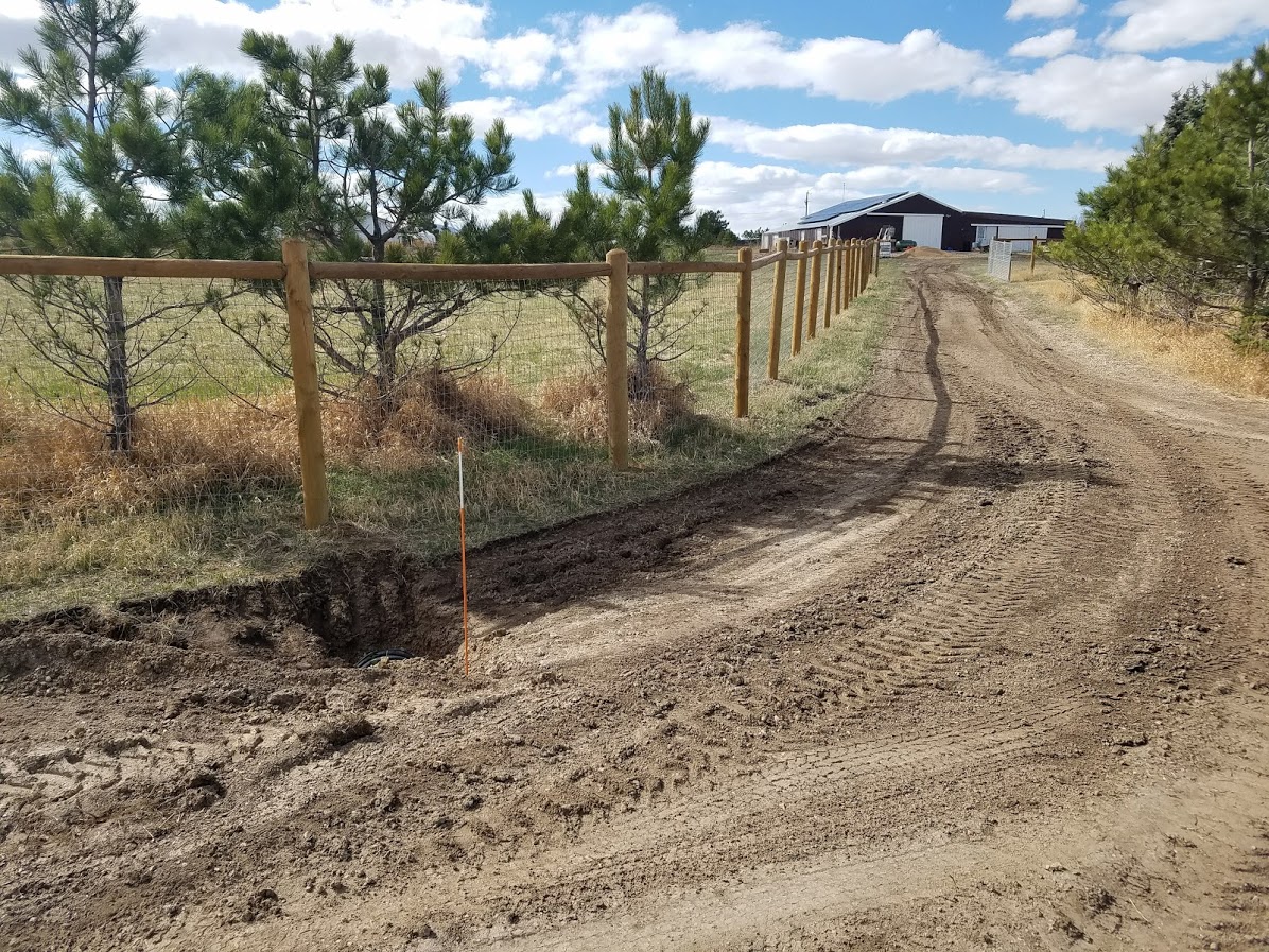

Finally got a photo.
Need to taper the entrance & exit of the culvert across the main driveway a bit, but otherwise it's in. Need to re-grade the driveway up to my shop (behind the trees) so it slopes away from the house & towards the culvert as well as putting in a bit of a ditch on that side. That will most likely happen when I get some spare cash for a few dumptruck loads of gravel for everything. Also need to scrape off the gravel infront of the house & remove 6-8" of driveway to do a better job re-grading (did a patch job shortly after we moved in so it drained a bit).
